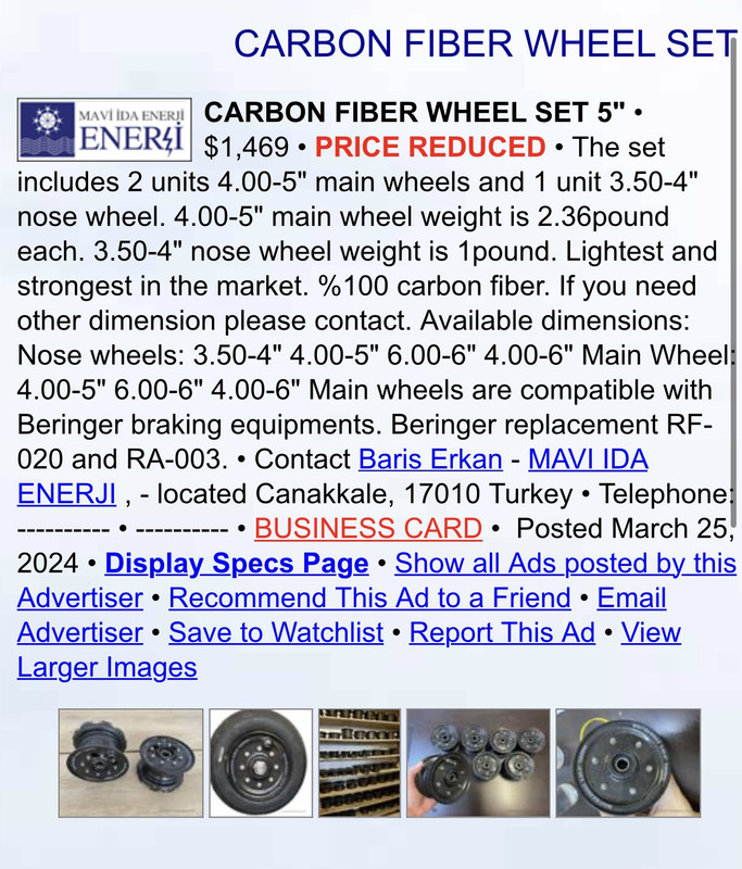

You mentioned these guys
https://www.barnstormers.com/classified ... SET-5.html
https://en.maviidaenerji.com/projeler
Looking at their site seems they also make some normal brake wheels too
Posts: 1678
Re: Lightest EXP cub wheels and brakes
I think the only ones in the picture that don't have Beringer style brakes are nose wheels. I had emailed them and they indicated that the mains all use the tapered axle as well

I wanted to mention. I believe the Mavi Ida Enerji folks had a booth near the ultralight section at Osh last year. I was able to chat with the folks and hold in hand several sizes of their wheels. The rep there really seemed to know his stuff and I have to say, their carbon products looked very well made and had a very professional feel and finish. It is a bummer they only build to the Beringer style setup. We did ask about a 10" wheel for 35's, to which they said they were thinking about it.
