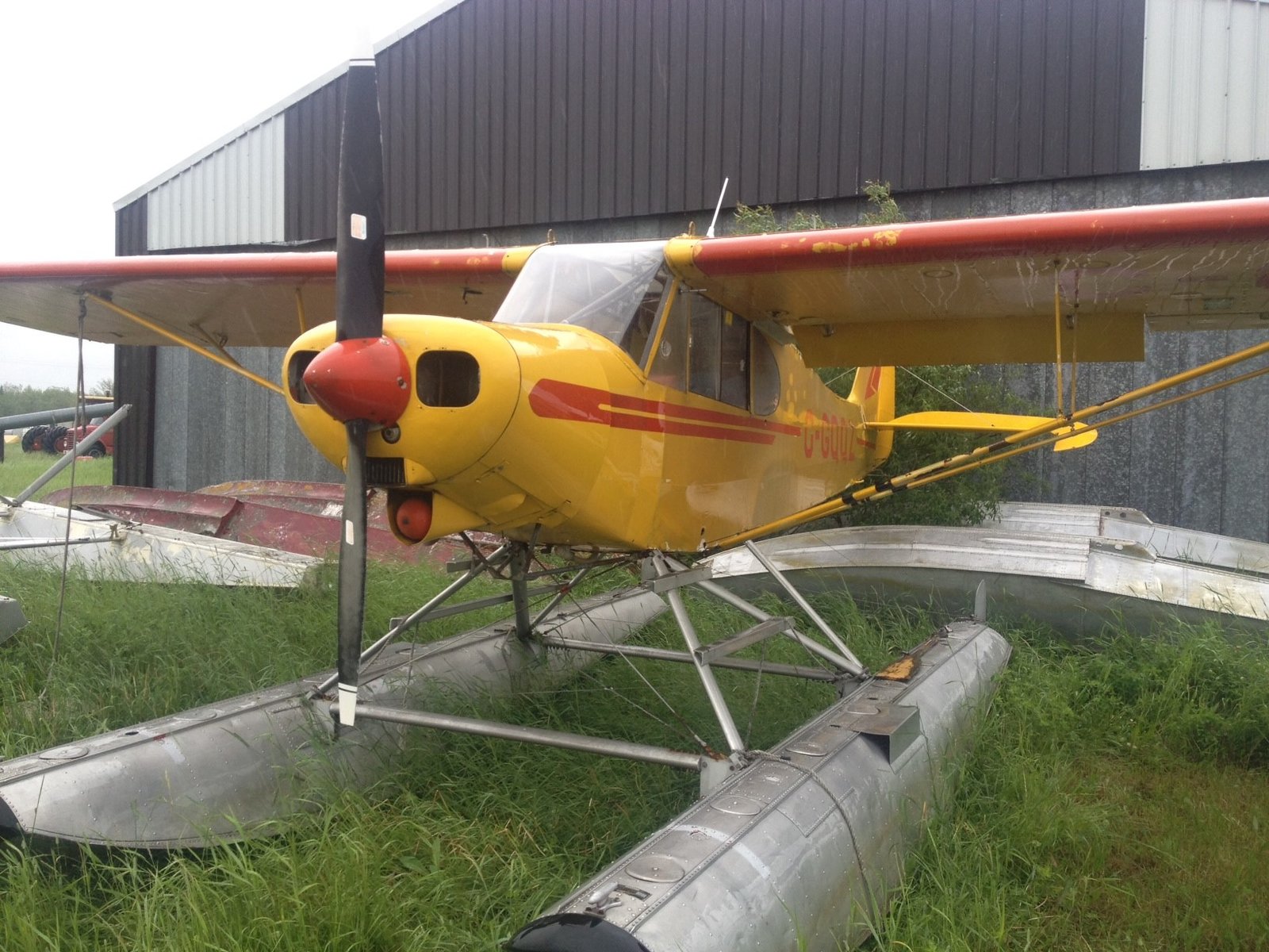

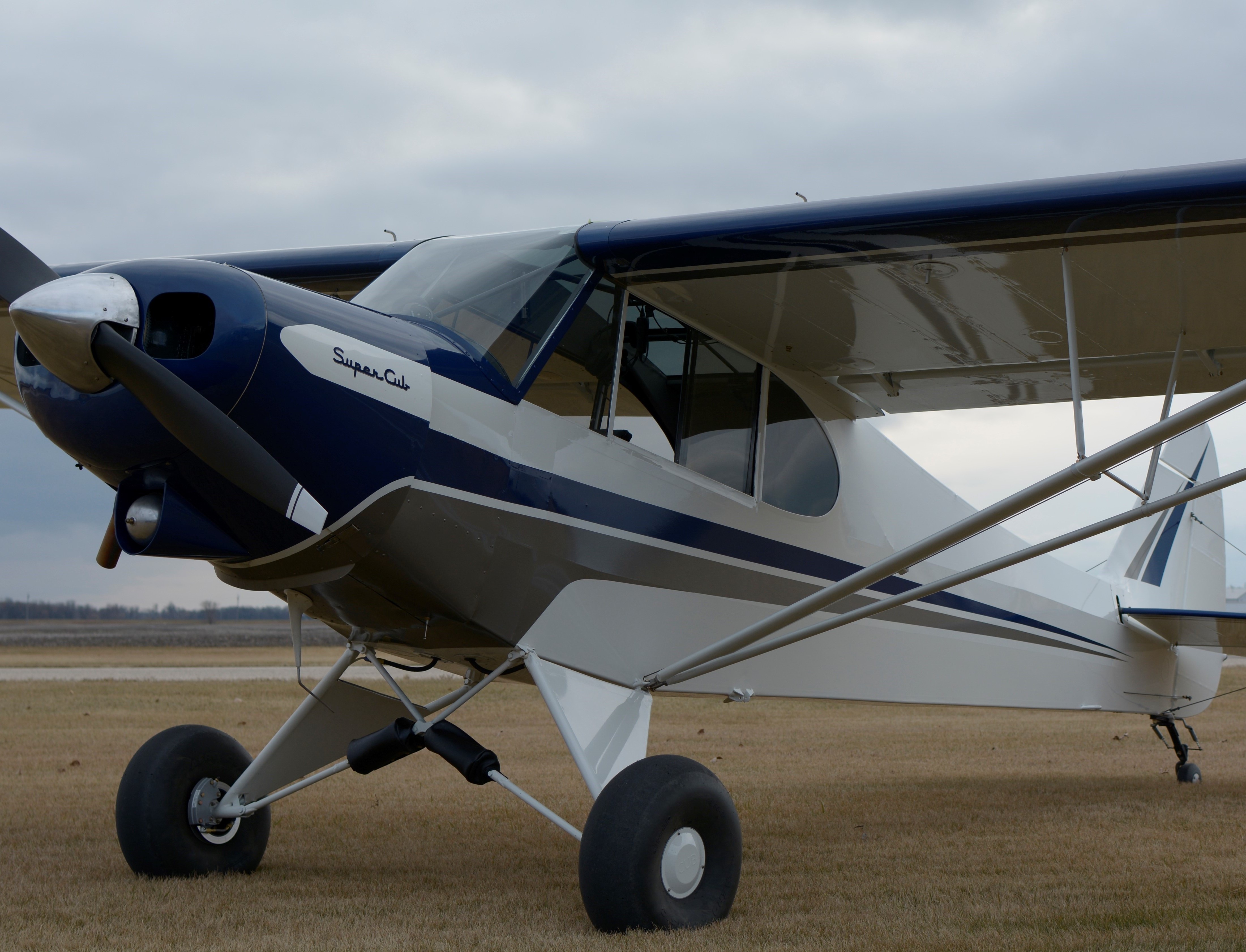

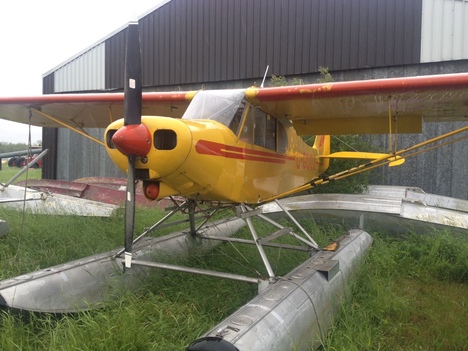

Hey! it is a 1958 PA-18A. We had just finished a complete restore (which took nearly 3 years). Has the O-320 with basic pro mods like Hi-Flow exhaust, Grove 8x6 wheels etc. The plane was originally a spray plane on floats. was a pretty sweet "barn find".
Before

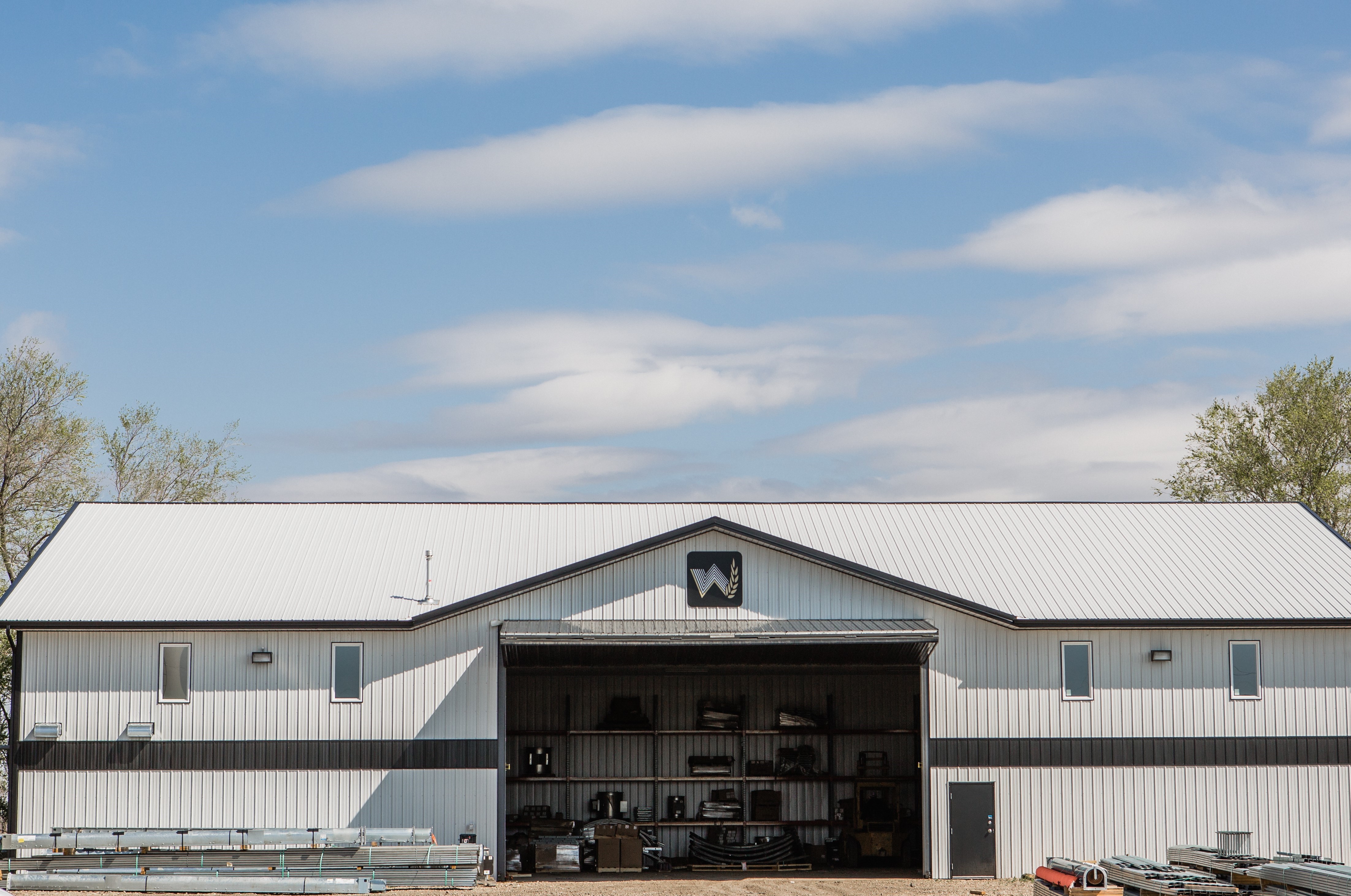

Thanks David. Yes one of the restrictions with the bi-fold is they do require additional head room to accommodate the wedge of the door. That is were the 1 piece hydraulic door really shines. Although we do offer the self-supporting frame that allows you to go past your roof line on a gable wall, on a side wall it doesn't work that good as where the hydraulic door will stay below the roof line. A customer of ours designed his building with a false gable on a sidewall which allowed him to utilize the truss for the snow loads and for the door loads. I'm hoping to build a hangar in spring with a layout like that. Picture below of the building.
