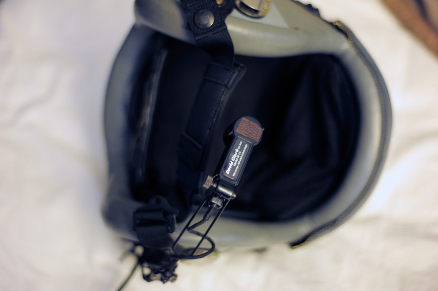

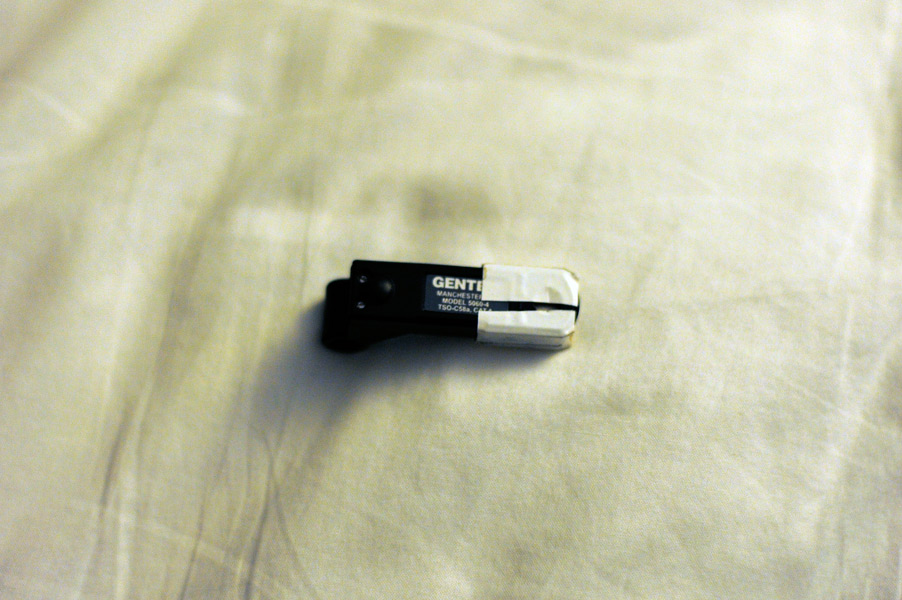

Like most people, I've done the converters, etc for my surplus helmets, but ended up just buying all the "right" stuff in the end.
M-1A on my helmet, I've got it taped off for wind noise.
