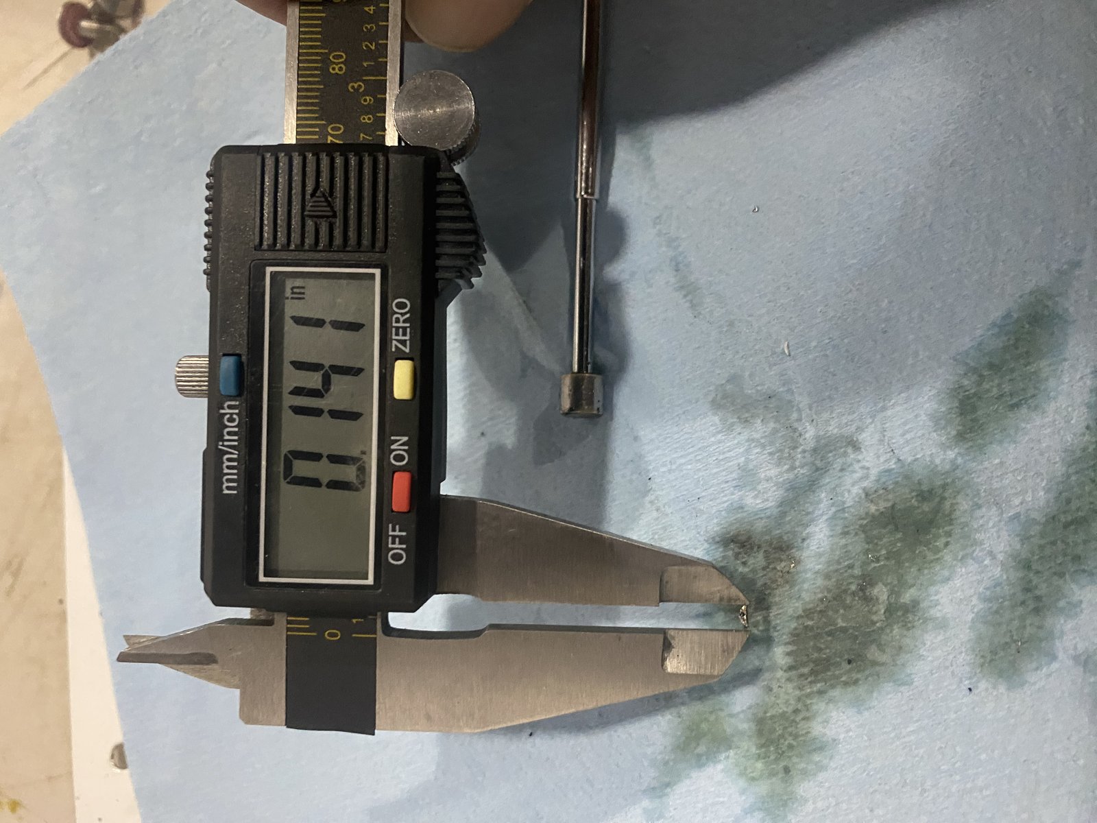

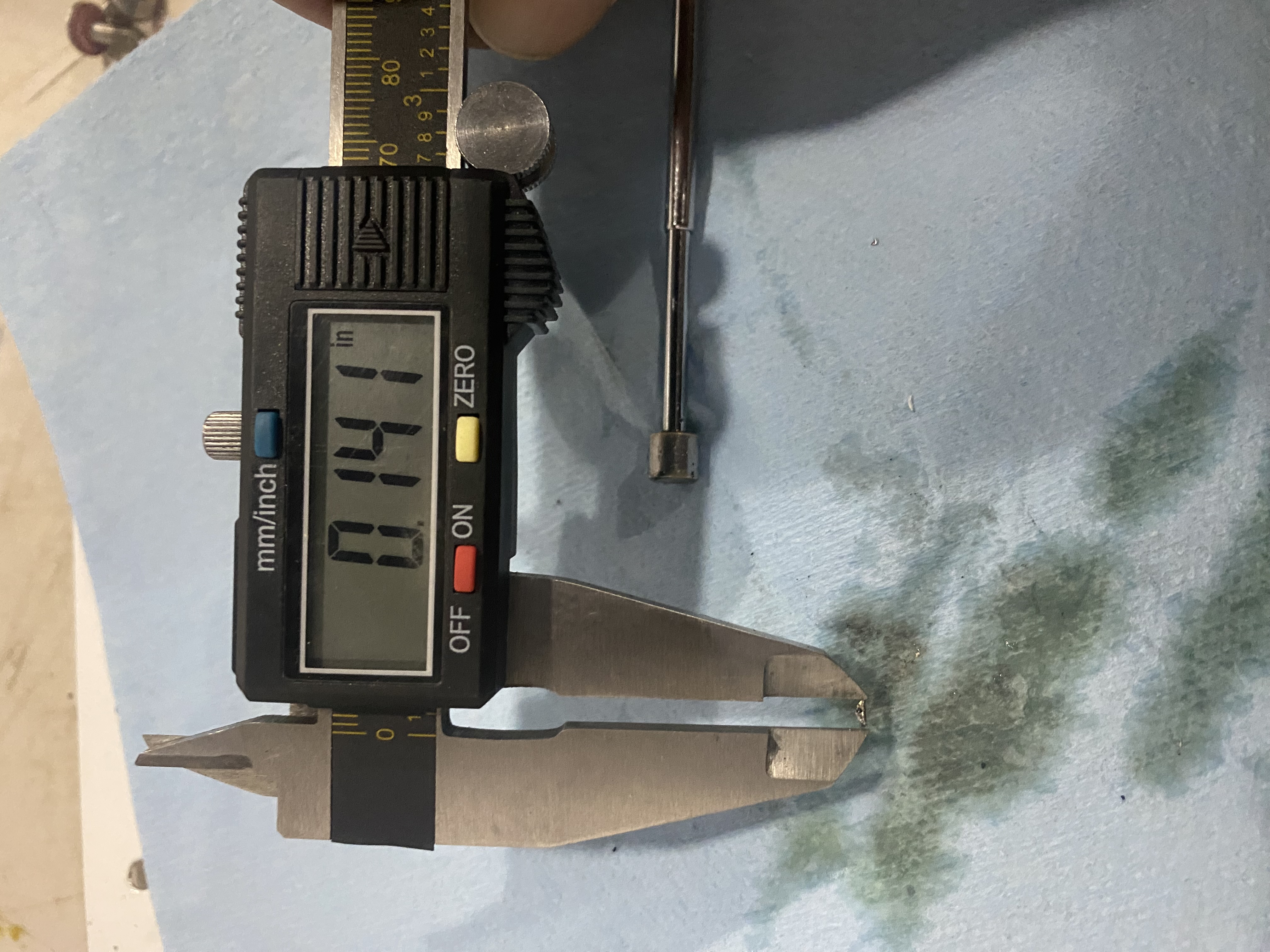

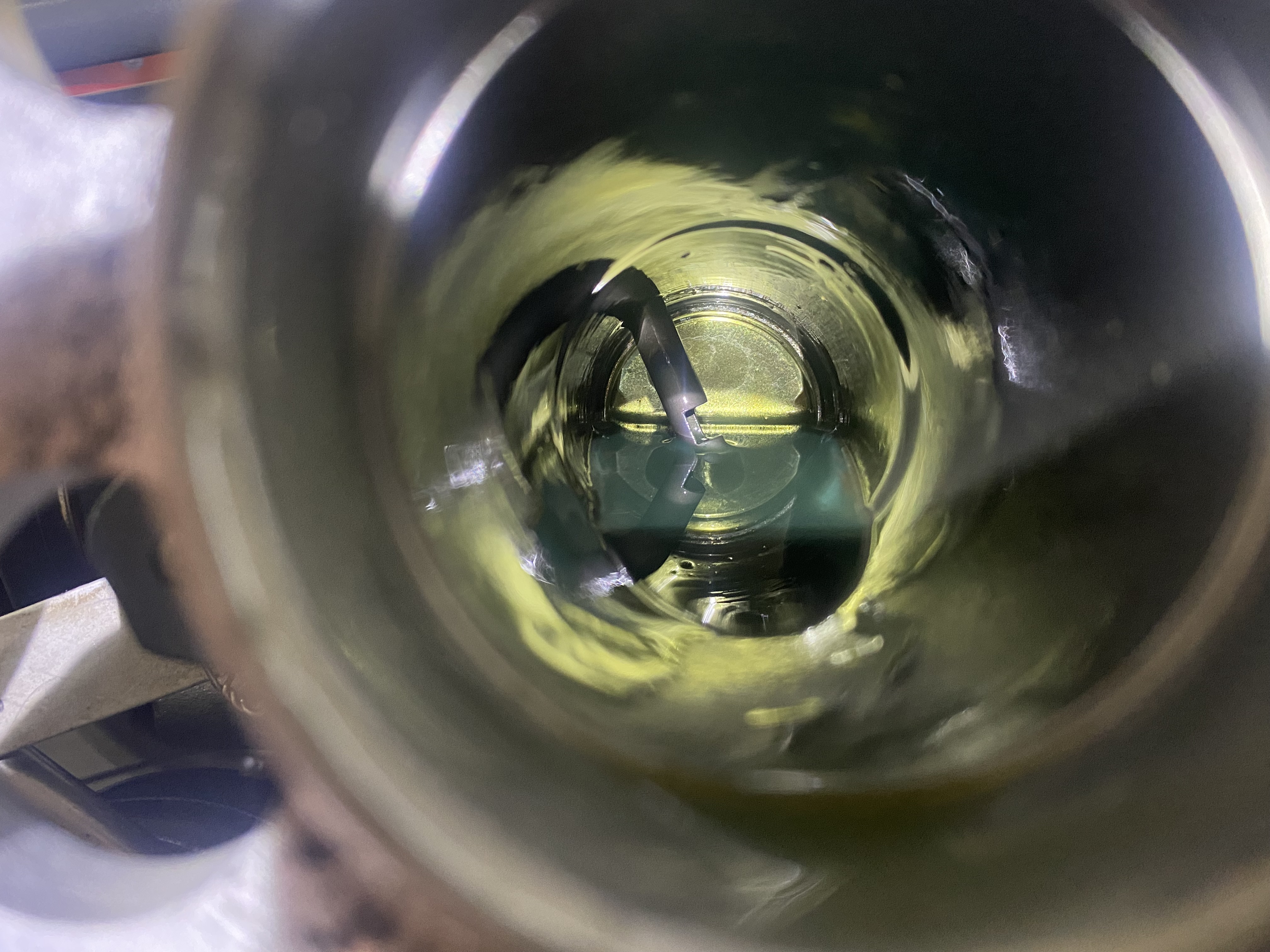

Every day thing here figured I would send an update. Found this Near .14" piece of ferrous metal today when we pulled the prop off and looked in crank. The plug had a few pieces of metal on it initially and looks like the lip might have scuffing on it when zooming in. Ever see this? Largest piece so far, need to suck out the oil from the crank and check the suction screen tomorrow. 1462A again today indicated 2psi.
Making metal in Crank?
Smooth Crank Wall 2nd overhaul
