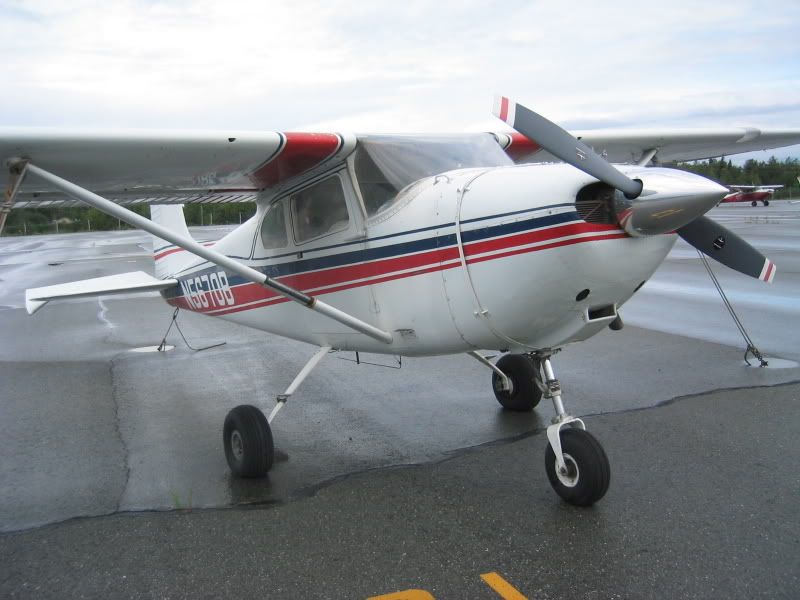

Beefed up hawk with engine, prop and wheel upgrades
hawk with 180 ponies Nanwalek AK. 8.50 mains and 800 nose

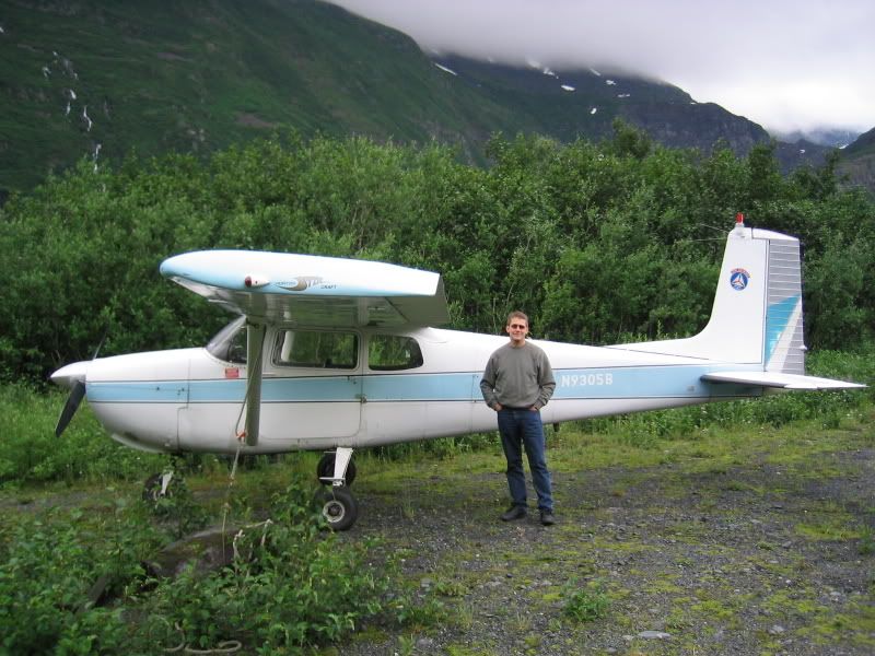

175 Skylark Ex CAP a/c sitting on Rebar field (Whittier AK) airport directory warns of rebar iron on runway.

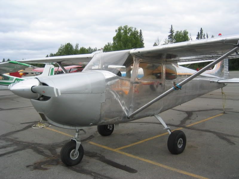

Stout as a brick shit-house 1956 182 with cowl mods, prop, engine, fork and wheel upgrades (Palmer AK)
scout offline
Posts: 167
What's the strap around the cowl on that last 182? Fasteners shot so they stuck a tie down round the cowl and ratcheted it up?
