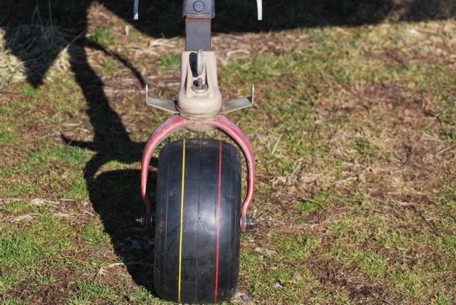

Sometimes cross-breeding is better?? Matco tire and wheel, with ABW fork assembly?

I am just saying I my self would have rather put my money now towards an ABW.. the wheel and tire are fine. the center shaft going up through has a lot of play in it now there is a little brass spacer that kicks the ears off of the turning pin once it gets to a certain point, iv had to replace it. the ears on the abw go out and up, on the matco they only go out and the stearing cables really pull the ears up and put them in a bind if u look at johns pix up above u see what I mean about out and up on the ABW. im certainly not trying to hammer matco this is just my experience with the 11" on a super cub. good luck!!!!
