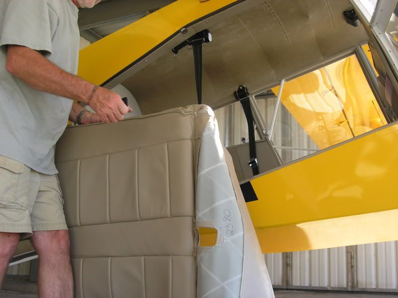

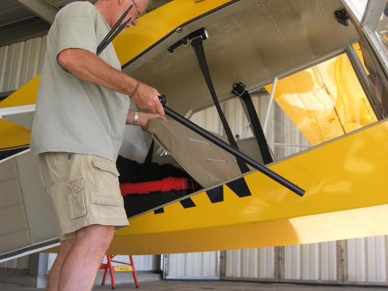

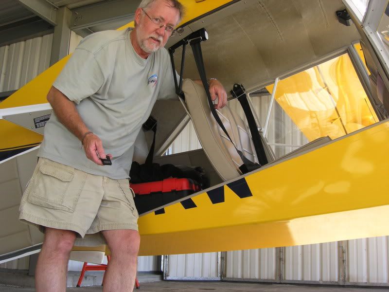

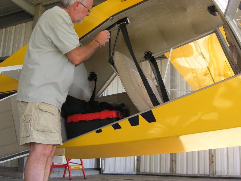

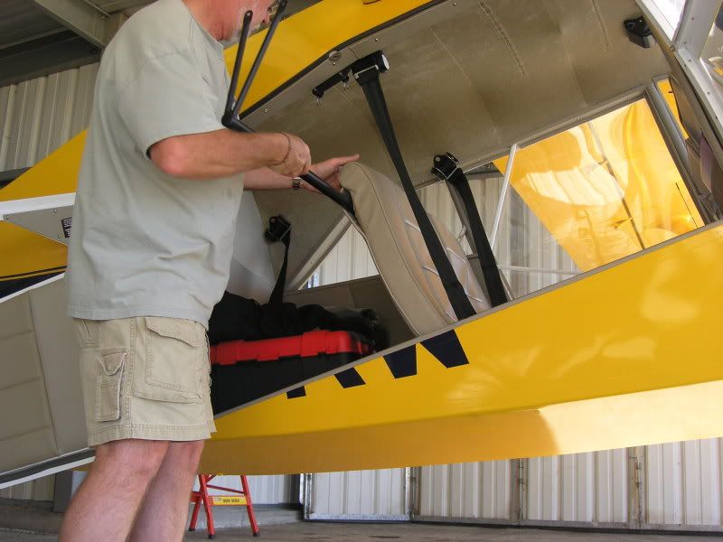

Here's how hard it is to R/R the rear seat in the Maule.
Zane, feel free to resize, move, or zap this flip book if it makes the thread too cumbersome

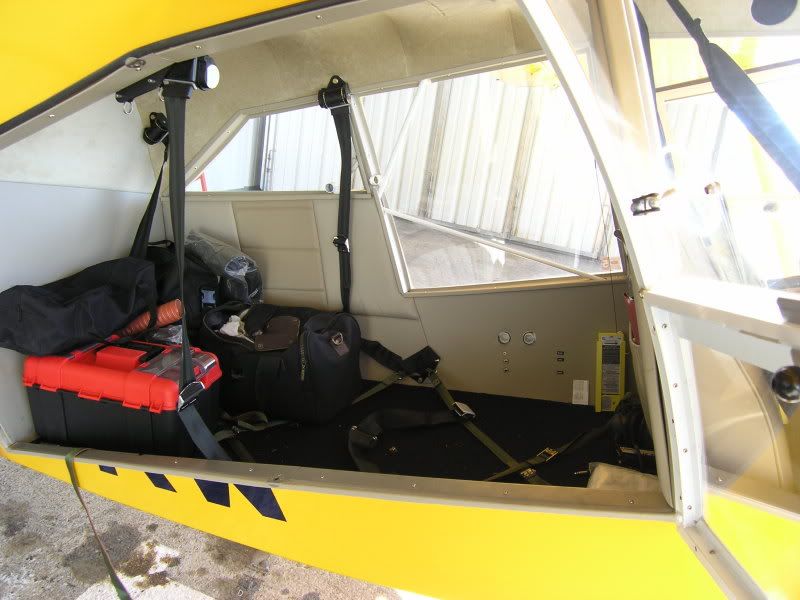

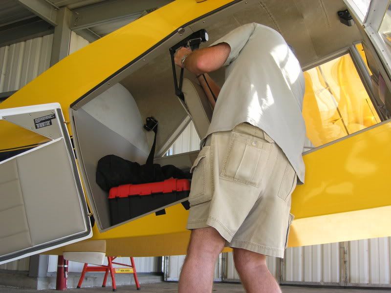

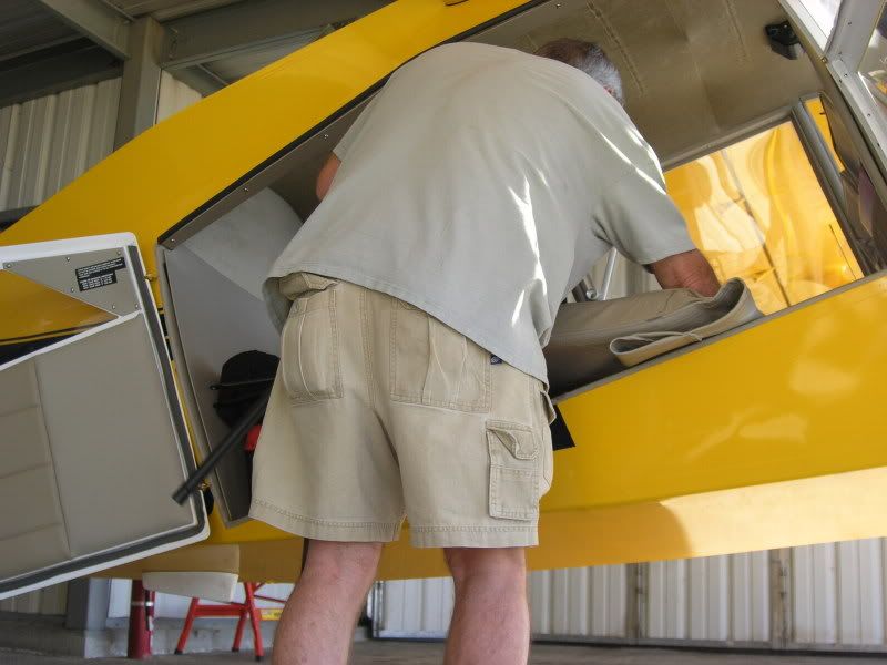

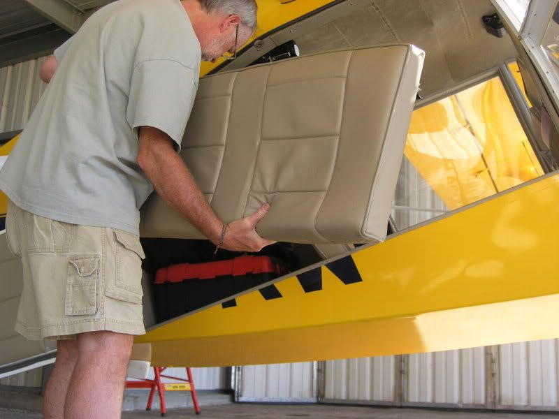

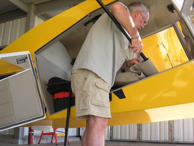

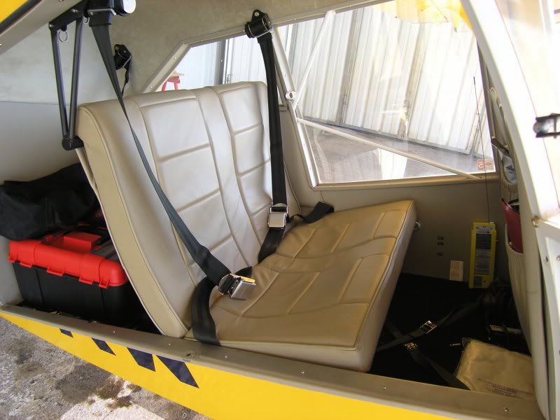

Start the timer
Lift out the seat bottom
Remove first pin
Remove second pin
Remove rear crossbar
Remove Front crossbar
Lift out sling seat
Stow in safe place and stop the timer.
Viola, the dance floor is ready.
Takes less time than reading the captions. To install, just start at the bottom picture and read up :lol:

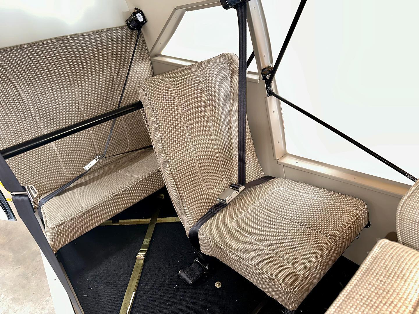

Yap, that's pretty slick. I saw they are making a rear split seat option now too. Didn't really see a huge purpose in it until this weekend hauling 2 people and a guitar out to the San Juans that it now makes more sense. Still has the upper and lower cross bars, just single seat.
