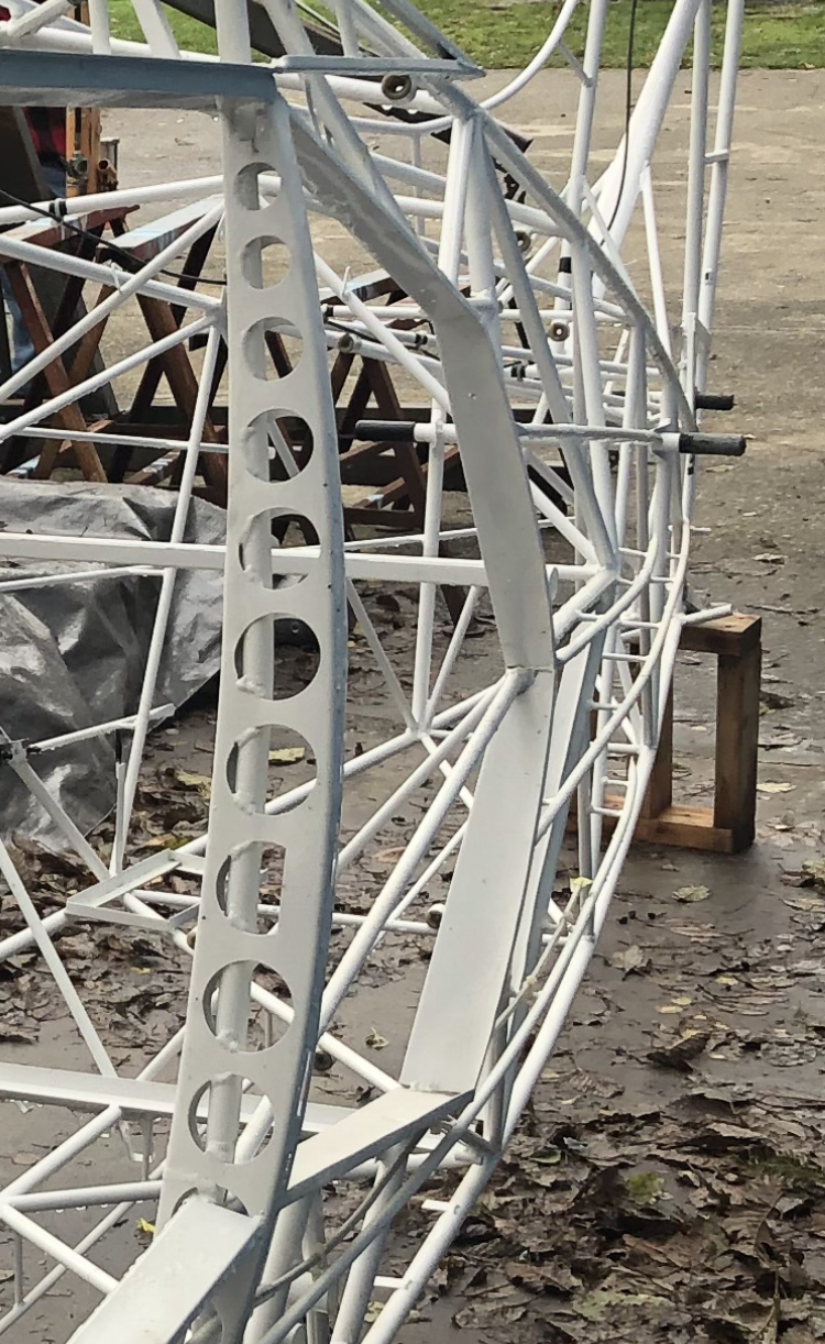

Not sure if it’ll help, but here is a pic of the left side patroller window frame welded in

asa, I believe that is the earlier left rear window frame. Very difficult to replace the plexiglass over and behind the cross tube.
A later design has the frame lower member more following the diagonal tube making it easy to replace plexiglass.
