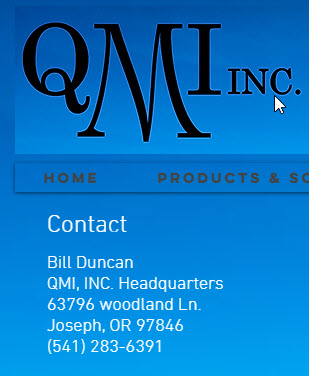

Re: McFarlane Tail Cone Angle Kit Conundrum
Majmetro wrote:....As far as Bill Duncan goes, the phone number on the QMI webpage takes you to McFarlane, not to Bill or QMI. Here again, if anyone happens to know Bill's number and wouldn't mind sharing it with me, you could send me it at "[email protected]".
Easy hit on google:
https://www.cessnarepairs.com/contact
Posts: 10612
Regarding trying to contact Bill Duncan...
1) The phone number takes you to McFarlane. 2) I've sent a message through this portal a number of weeks ago and have not received any response.
We are communicating with McFarlane as to how we can solve the install. Their tech has said via phone messages to relocate "new" holes to accommodate edge distance requirements. We have requested this guidance to be in writing. Either a letter or at least an email. No response as of yet.
What am I missing here???
