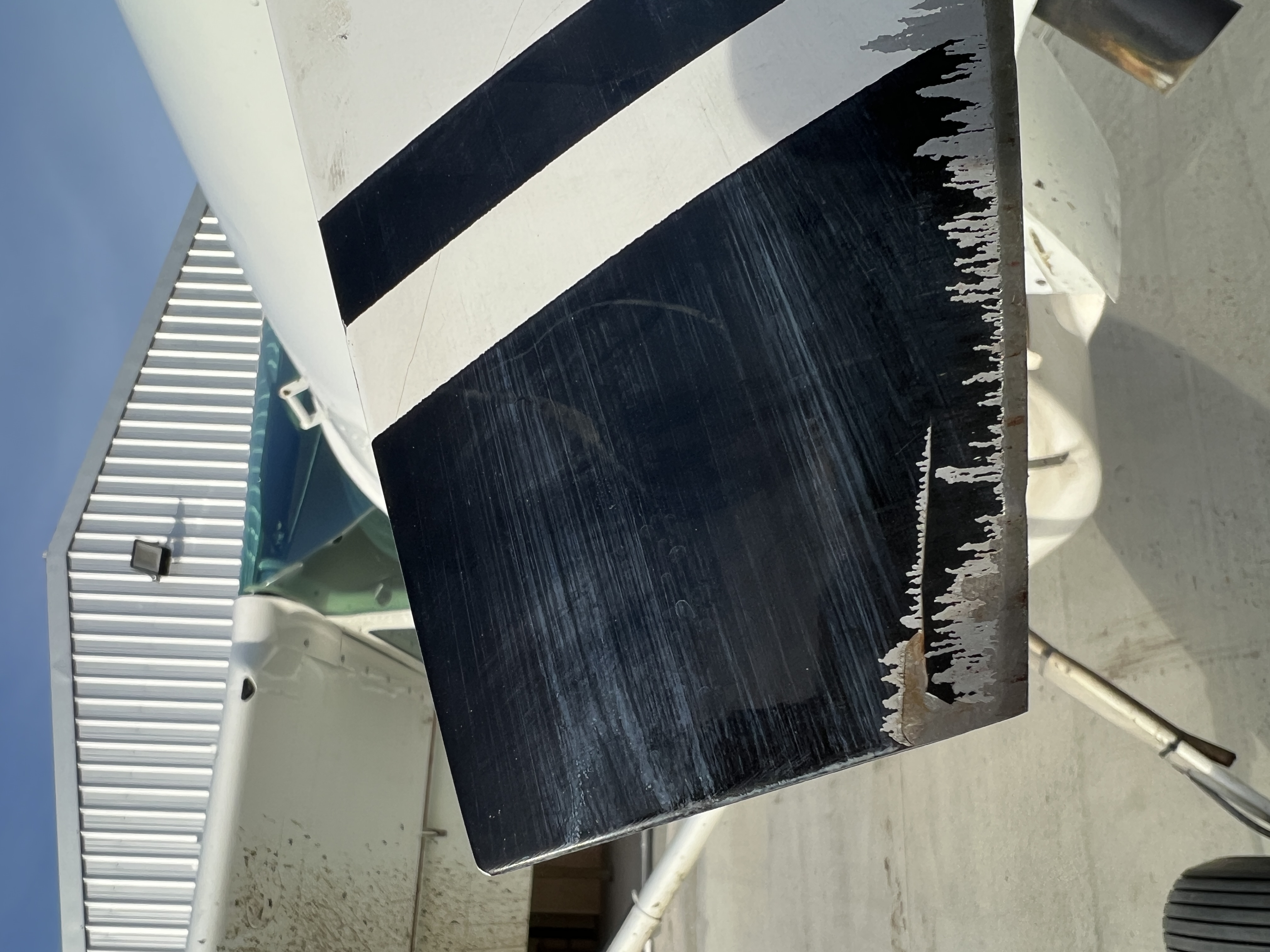

I just wanted to provide my unbiased opinion on a few modifications I’ve completed over the last year. When I was researching some of these beforehand, there wasn’t a ton of information. Hopefully this will help provide some additional perspective in the ecosystem.
MT 2 blade vs. Voyager: The MT worked just fine at sea level. Take offs were adequate for grass strips in New England. It helped CG and flew “fine”, but it wasn’t until I got out west that I really saw the pitfalls of this prop. On that first trip out, I was really struggling to climb over easy passes while slightly loaded and the plane was not performing like it should. High DA takeoffs in backcountry settings weren’t just suboptimal but downright too close to the margins. Accounting for DA and weight, my takeoff distances were significantly higher than POH numbers even though I had Sportsman and WingX at this time. Additionally, I broke 3 starter adapters during my affair with the MT. I know the prop wasn’t the root of the problem but it definitely exacerbated any other slight issues. One incident left me stranded in Mexico at 110 degrees F. I finally bite the bullet and bought a Voyager. Screw the CG, as long as I never have to be stranded in Mexican heat like that again (long story short, I had to take a taxi all the way back to the states).
The Voyager is better in every way. I was originally worried about speed loss vs the MT but was very surprised to see that I gained 3-4 mph! That wasn’t supposed to happen. The 2 blade MT is supposed to be a fast prop. Maybe it is but the Voyager is faster. As far as performance, I don’t want to get into butt dyno results. Additionally, I think there are too many variables to accurately measure takeoff distance comparisons, so I just did a simple climb test driven by the autopilot. It may not be perfect, but it is a simple way to test the props with few variables. I did two climb tests, 110 ias, 5000’ climb, WOT, 2700 rpm. I couldn’t climb steeper because I am cht limited. The base of the climb was 4000’ density altitude. My hope being this would account for some pressure and temperature difference and give the most accurate comparison. I loaded the plane up with bags, a 90 lb dog, and 104 gal of fuel to do these tests. My theory is that a lot of people testing a new modification will fly the plane light because they want to feel the new performance and sensations, but in reality we should be doing these tests high/hot and heavy. So I did my best to load it down and test high DA conditions. The MT completed this test at an average of 714 fpm and the Voyager at 790 fpm. Although it doesn’t seem like much, that’s a 10.6% increase in climb performance with the Voyager. I was only able to climb at 110IAS for this test because of temps but I can imagine that climbing at true Vy the Voyager would show even larger gains. You can imagine this translates to takeoff distance as well especially since the Voyager will spin 2850 vs the limited 2700 of the MT. Those are the most straightforward numbers I could obtain. If you have a o470 or low compression PPonk, mainly flying at low DAs I’m sure this prop would be just fine. On an IO520 that can spin 2850 and at high elevations, the two blade MT was absolutely the wrong prop for the mission.
Wing X: it’s been talked quite a bit on here so I’ll keep it short. Absolutely a nice increase in climb rate and decrease in takeoff distance. I’ve heard some people say it will increase your climb by 400 fpm but that wasn’t the case for me. Sorry I don’t have real data on this one but I’m seeing generally 150-200fpm increase max. I wouldn’t call it a miracle drug. I did make the mistake of loading my plane up to 3300 lbs for my third landing with the new big wing. I was worried I may float down the runway with all that additional lift. Not the case. I came in too slow, got dropped on my ass, bounced, and abused my airframe. Humbling experience. Additionally, you will notice you will have to be a little stronger on the rudders to keep it coordinated but you’ll get used to it quickly. I didn’t see any negative effects in cross winds. Same as any plane, aileron control, and keep it straight. I would absolutely do it again but it would be after Sportsman and Voyager.
Surefly: The short answer is that I would only do this modification if I was fuel injected with Gamis and running LOP. I saw a definitive increase in CHTs. During the summer with BW, I’m already struggling to keep temps down, the last thing I want is an increase in CHT. So this has been a love hate for me. The advanced timing kicks in under 24” MP so it is super important to keep an eye on your gauges and temps. For example, I was at 10.5k ROP In Idaho backcountry. I needed to check out a map and do a little route finding because of weather. On standard mags, you could never get to critical temps at this altitude but not with Surefly. I looked down after a few minutes and I was at 420f CHT! The timing advances so aggressively (up to 36 degrees btdc) that I was in serious territory of engine abuse. Once you know how to manage the Surefly it gets easier but engine monitor is absolutely necessary. Where the system really shines is up high and LOP. Before my engine would begin to run rough at 50 LOP but with Surefly it will run perfectly smooth 100-110 LOP. You could use the more efficient burn of advanced timing for additional fuel savings by running leaner, but I choose to redeem my Surefly nuggets as extra airspeed. So I’ll run 50 LOP and I see a much smaller drop in airspeed as I transition to lean compared to a standard mag. At the end of the day, I don’t think the juice is worth the squeeze unless you’re running variable timing and LOP. If you are, you will see more airspeed during those lean operations for a given power setting and therefore better mpg.
Earth X: The install is harder than a simple swap; however, 100% worth it. My one year old Odyssey and big energizer starter were always struggling to make it past compression stroke of the 520. Every time I started the plane, my heart rate spiked. Would I kill the battery or break an adapter today? This combination with a light MT is the secret sauce to starter adapter mayhem. The EarthX changed all of that. It is 10 lbs lighter and spins that big metal Voyager fast enough to take off a finger. It’s beautiful to see. Enough said.

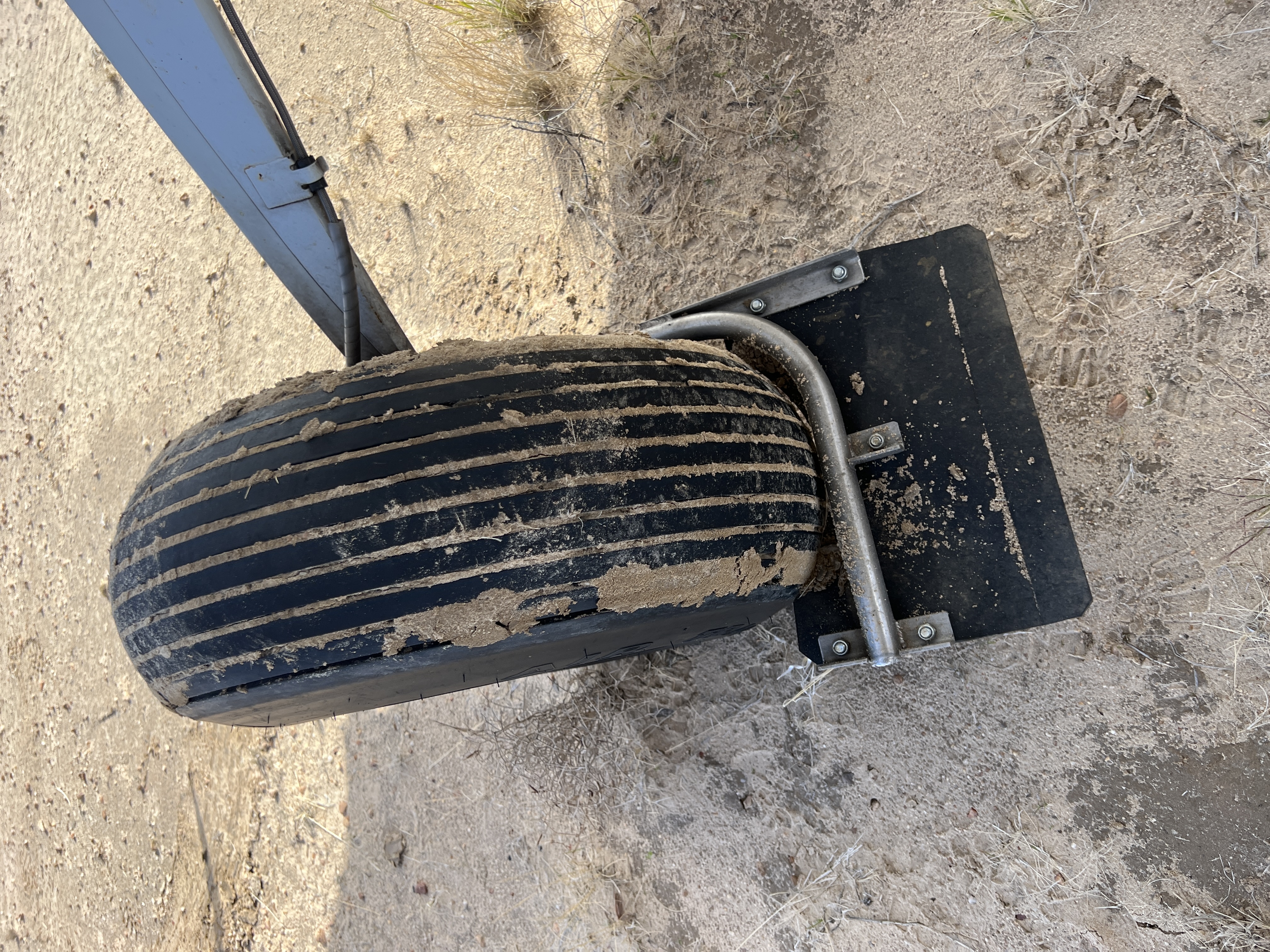

Desser Aero Classic 8.50x10: I’m just putting this info out there because I don’t think this tires gets enough oxygen. 185s can’t run Goodyear 26s. They also can’t run Desser 8.50x6 because the load rating is too low on this tire for the high gross of the 185. Along comes the Aero Classic 8.50x10 6 ply. This tire has a true diameter of 25”, no tread, 20% less drag and 6 pounds lighter per wheel/tire assembly than 29” ABW and it has a high load rating. This tire doesn’t get much attention but it is a great compromise tire for some people. Faster cruise, better climb, and for most of us 25” tire will do everything we want. The ABW 10x10 STC specifically states 8.50x10 6 ply tires in case anyone is wondering on the legal aspects. You don’t need Grove wheels/brakes to make it happen.
Hope this helps someone out there questioning these modifications. Feel free to shoot me a message for more info.

Disclaimer: I love my Bushwheels but….. another interesting aspect of the 8.50x10s is that I’m fairly sure these have decreased takeoff roll compared to ABW. Even highly inflated Bushwheels would squat in the dirt at 1000rpm, not moving an inch at this low thrust. The Dessers want to get moving. If your feet aren’t completely on the brakes at idle, the plane is going to want to travel somewhere fast. It’s a small point but something noticeable and translates to takeoff roll. That is until your on a very soft beach…then the BWs obviously win. All depends on your mission I guess.
Im no specialist but we can look at the basic dimensions. The Voyager is a 86” three blade prop vs a two blade 83” MT prop. That is significant amount more blade being thrown around. I’m not saying more is always better, but the two blade doesn’t seem to be enough prop for a 520. Also, the MT is limited to 2700 rpm while the io520 is legally permitted to spin 2850 rpm. There is an additional 15 hp at that rpm.
A common argument I’ve heard for the MT is that it is designed to make its most thrust at 2600-2700 rpm. Ok great, but we know the 520 makes 285hp at 2700rpm. Shouldn’t we want a prop that is designed to make the most thrust at the peak horsepower rating for that engine? I know it’s more complicated than this once we start talking tip speeds; however, generally we should want a prop that’s designed to make most thrust at an rpm that matches the engines power curve. Correct me if I’m wrong. See above, not a specialist. Just a guy who likes to nerd out on airplane stuff.

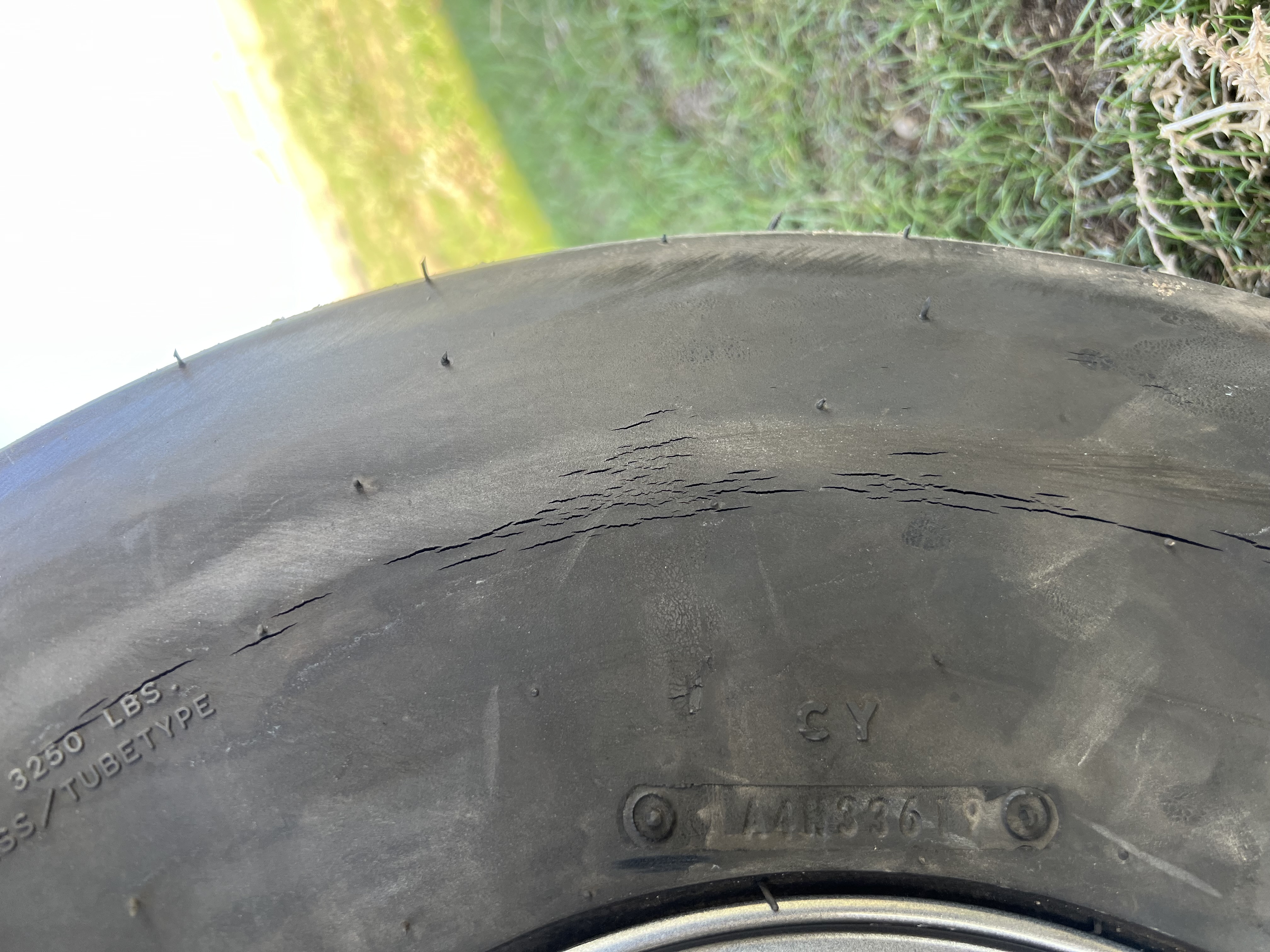

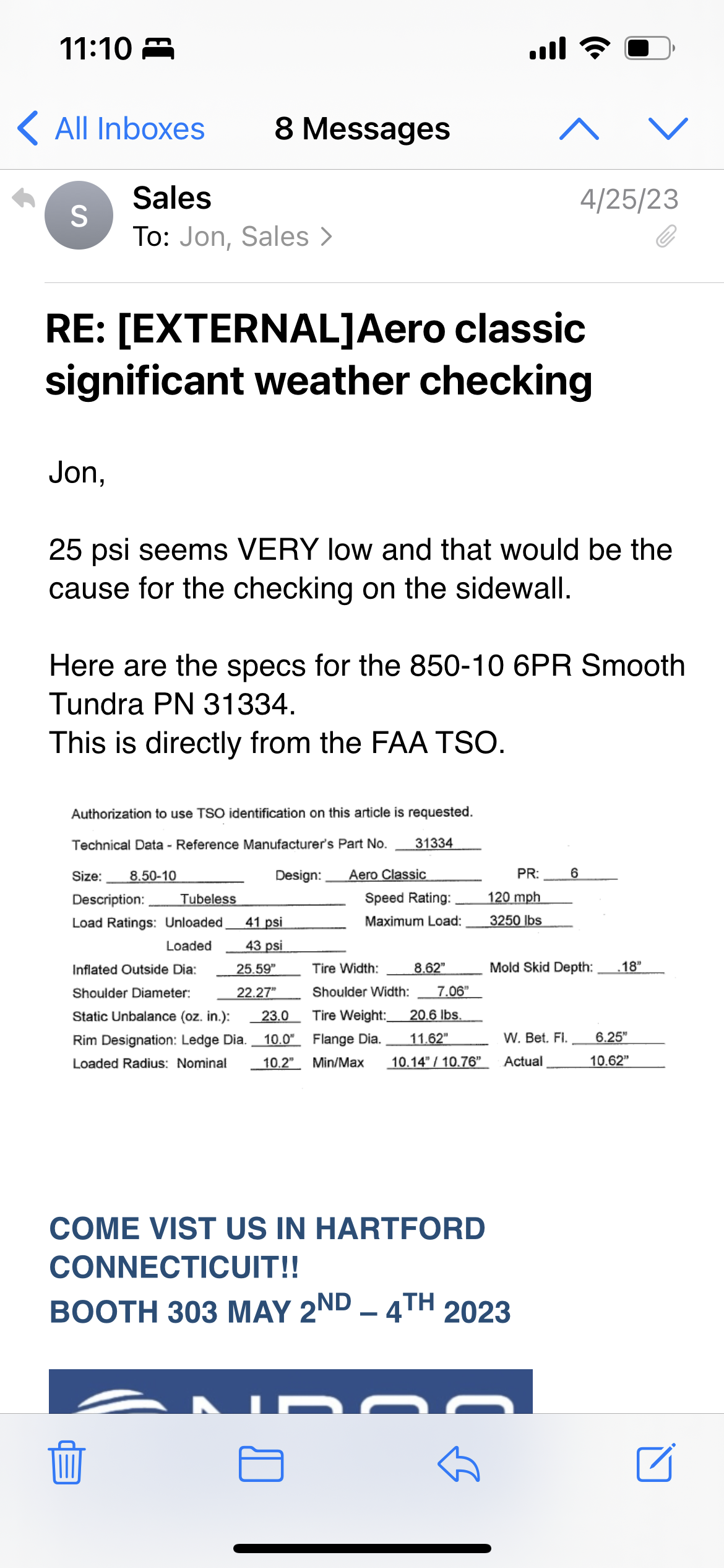

Not posting to bash Desser, just want my BCP buddies to know my experience if they are considering Dessers.
I think the 850x10 tire is a great size and too often overlooked. They are a great size for me. Unfortunately after 6 months the tires were so weather checked I couldn’t convince myself they were safe to use. I emailed Desser about getting warranty replacements. They asked what PSI I was running them at and I told them. 25psi at first then down to 20psi. They told me the tire failed because I was running them at a “VERY low pressure” and not at the pressure required by the TSO which is 42psi. I tried to call them several times and sent a few emails but never could get them to respond after I questioned them on selling a “tundra tire” that required 42psi of air pressure.
Pretty frustrating to get a 10” wheel set up and tires to go with them only to have them last 6 months. It’s a great size though so I hope you guys have better luck than I did.

Oh wow. Super good info on the Dessers, Whee. I wonder if there could ever be insurance repercussions from something like a ground loop of tire pressures were too low.
