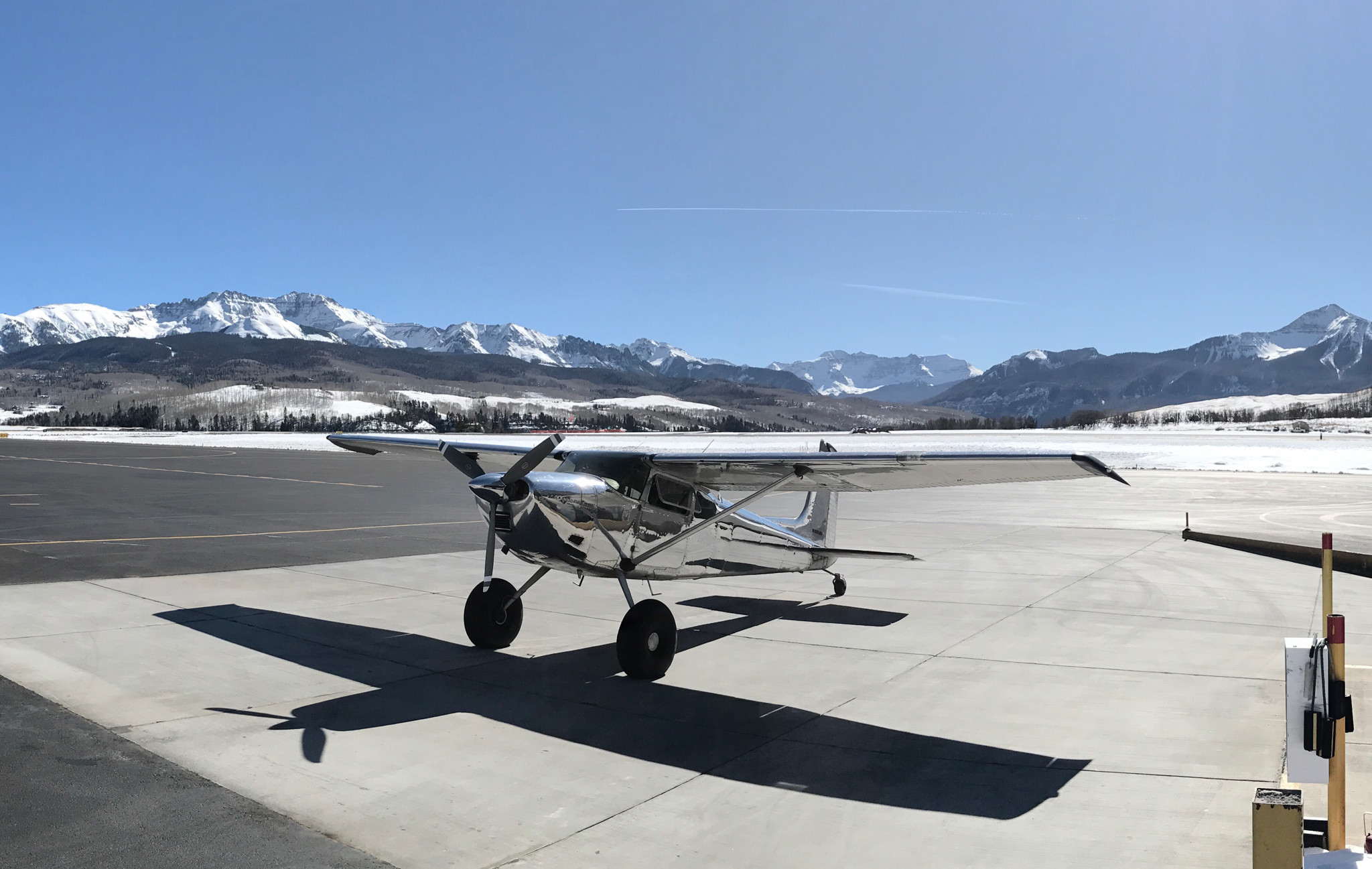

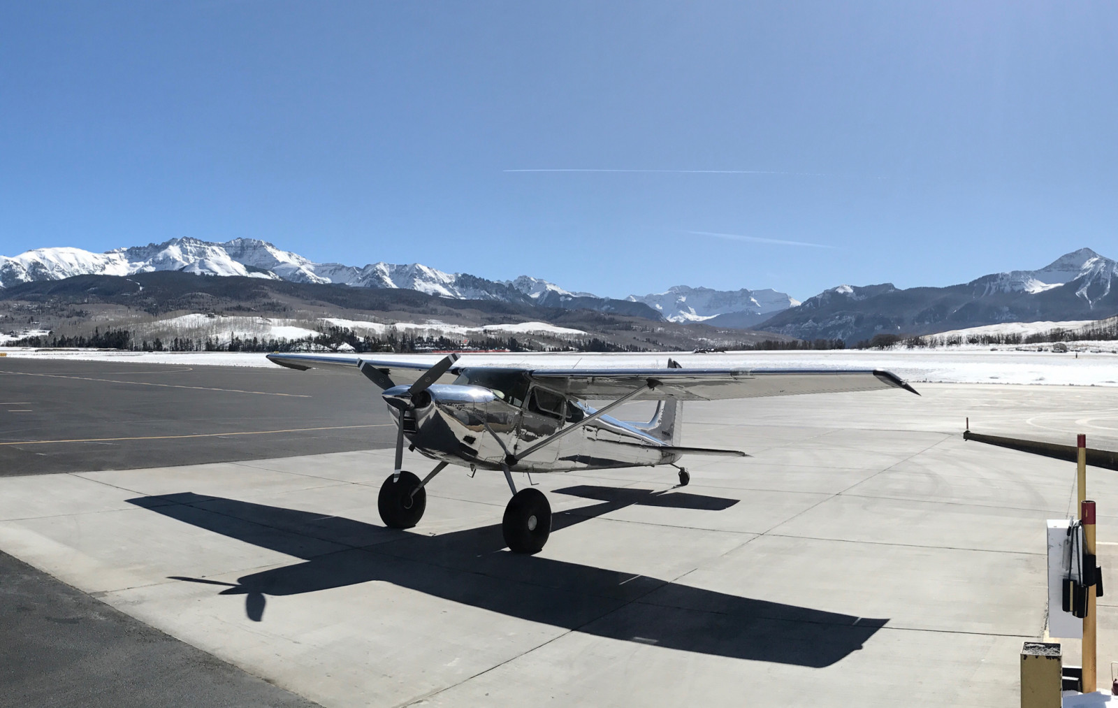

As far as CG, in my experience, you have to get used to every different setup and take some time to figure how to maximize the performance. There are many different missions and applications etc., mine is to haul alot of stuff and have good performance at higher altitudes. Going from a 2 to 3-blade, required a fair amount of adjustment to my technique. I decided sustained ROC was most important, and the 3-blade is the winner out of the 5 different props that have been on the wagon hands down.
When I hung the 3-blade Hartzell Scimitar, it was noticeably different from the pilots seat CG wise, wasn't sure what to think at first. Now that I've got a couple hundred hours on it, absolutely the best climbing prop I've ever run, similar in noise profile to the 2-blade MT, but sounds amazing instead of bizarre IMO. It's as smooth as any other prop, if not more so, but took a good 50 hours to get it to run as smooth as it does now.
So point is, there are many aspects to consider in what prop works best for your mission. If it is all about super lightweight everything to win a STOL comp by a few feet (which is very cool IMO), then go for a 2-blade variety. The 2-blade MT was all together only 8 pounds lighter than the 2-blade C204 It replaced, no noticeable CG change from the pilot seat FWIW. If you want to use all that HP and climb with authority, 3-blade or seaplane 2-blades are hard to beat IMO, just depends how much HP you have to utilize, and what your primary mission objective is. The point I'm trying to make, is that for what I do, lighter was not better.
Also, 3-blade props just look cool [emoji12]

Skalywag wrote:Also, 3-blade props just look cool [emoji12]
GORGEOUS!! I wish we had a mouth watering emoji!
