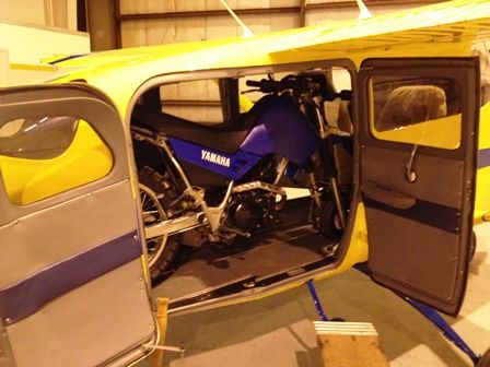

I spent last year perfecting a motorcycle loading system for the PA-32/34. This year, I’m itching to enjoy the fruits of my labor. I’d like to load up a Cherokee 6 with a motorcycle and camping gear and head west for a couple weeks. My goal is to string adventures together and to use the motorcycle to explore destinations and to visit non-fly-in places. Can anyone recommend places to go and things to do?
I live near Chicago and I’m planning to take a northern route west and a southern detour back home. I should have time to visit at least a dozen places. Does anyone have any suggestions?

Here’s a quick look at a motorcycle loading system that I helped develop for PA-32 and PA-34 airplanes. A system of ramps and fixtures, called MotoLOAD, allow me to load and secure a motorcycle in around two minutes. A built-in winch system, powered by a cordless drill, does most of the work. After landing, it takes about two minutes to remove the motorcycle, unfold the handlebars and ride away.
The loading system is made from TIG-welded aluminum tubing and it has a removable design. After removing the rear seats, the loading system literally drops into place; there’s no installation required. Then, after loading the motorcycle, the entire unit straps down with a couple of ratcheting seatbelt extensions.
The motorcycle is a highly customized 225cc Yamaha. It hauls two adults down the interstate and tops out around 80mph. It has smaller wheels, shortened suspension, folding handlebars, carbon fiber fenders and other modifications to make it smaller and lighter. It also has an interesting non-spill plumbing system. For completely redundant fuel protection, the loading system has a built-in spill pan that is lined with fuel absorbent materials. There’s enough fuel absorbent to soak up 110% of the motorcycle liquids.
The hardware itself is very interesting but the real goal of the project was to see if we could change the way that people use their airplanes. Ground transportation provides adventurous pilots with more places to go and unlimited things to do. It turns concerts, conventions and every-day places into convenient fly-in destinations. It also eliminates reservations, paperwork, business hours and third-party headaches. So far, several of our early adopters have reported flying more often, visiting new places and regularly exploring their destinations.

Loading systems for the Cessna 206 and A-36 Bonanza are in the works. We’re swamped with some big certification projects but I hope to have something wrapped up later in the year.
David, I know the gentleman with the Cessna 206 and ’65 Ducati very well. The Ducati was not very convenient and I’m told that it was only carried 4 times in 12 years. It is a fairly heavy bike and it has to go through the door at an awkward angle; a delicate 2-man job. Last summer, he replaced the Ducati with an XT-225. I built him a quick-release axle, center stand, folding handlebars, etc. He was able to get away with the stock wheels and suspension. He says that he can load the XT-225 by himself in around 5 minutes and he has already brought it on a number of trips. I think the new loading system will streamline that to around 60 seconds and eliminate lifting entirely.
The loading system is indeed complicated. We mocked-up and tested at least a dozen different configurations and we found that there are many simple ways to do it… but there aren’t any simple ways to do it quickly and conveniently. We stuck to a goal of making it convenient enough for every-day use and that didn’t allow us to cut many corners.
I’ve been exploring some larger bikes and I’ll keep the KTM 450 in mind. It does look well-suited for this application. Some people have expressed interest in an electric, such as the Zero FX. In any event, the smaller wheels and/or lowered suspension are necessary to fit inside many airplanes. That would be a real shame for competitive dirt biking but it really doesn’t affect the mission of delivering pilots to destinations.

onefitty, it currently fits the Cherokee 6, Saratoga, Lance and Seneca. We’re working on similar systems for the Cessna 206 and A-36 Bonanza. There’s no STC required. When we designed the system, we were already up to our eyeballs in STC projects and the last thing we wanted was another one. We managed to design the entire MotoLOAD system to be free from airframe alterations and installations. Basically, the motorcycle and loading system both qualify as cargo. The FAA has provided us with a letter of review to that effect and I keep a copy in the airplane just in case I ever have a ramp inspection.
bigrenna, we worked very hard on weight reduction and the complete motorcycle and loading system total around 330 pounds. The useful load of these airplanes allows me to carry my girlfriend, motorcycle, full-fuel, and a hundred pounds of luggage… the perfect recipe for most trips. Let me elaborate on this part of the design philosophy. We noticed that the average occupancy of 4-place airplanes is only 1-2 people. That leaves, in most cases, enough useful load to haul a small motorcycle. I like to say, “It’s not useful load if you aren’t using it.”

Skydive206, that sounds like a neat application. How often do you have to move airplanes around? I just built one for a gentleman in Texas who flies around to quote jobs for his business. He used to keep junk cars at 5 or 6 of the airports that he visits most frequently. Now he can quote jobs anywhere with just one motorcycle. I like hearing about new ways to put it to work.
55wagon, no rain taken. I’ve been in touch with FXbikes for several years and I’m interested in their products if they ever pull things together. Unfortunately, they keep having delays and they don’t yet have the capital to begin production. Which model are you on the waiting list for?
Their main product, the 125cc dirt bike, doesn’t have much transportation value because it isn’t street legal. They want to introduce a street-legal version but it too is lacking. As a single-seater, we had to compare two of them with our two-place Yahama. We found that our Yamaha is 20 pounds lighter (230 pounds dry), takes up less space and costs less money. The Yamaha also provides highway performance which is important for practical use. Further down the road, FX Bikes wants to make a 2-place, 250cc Freeway model. That’s the one that I have my eye on. It will match the Yamaha with an 80 pound weight savings.
We’ve done a lot of homework and we’re always actively looking for something better. In addition to the basic weight and performance, we also had to consider the width of the engine and frame to ensure it can fit in a 12” deep pod. We also looked at many specific features (axle style, engine vent location, etc.) to make sure the bike could be easily modified for our needs. All things considered, we still haven’t found a better bike than the one that we have.
