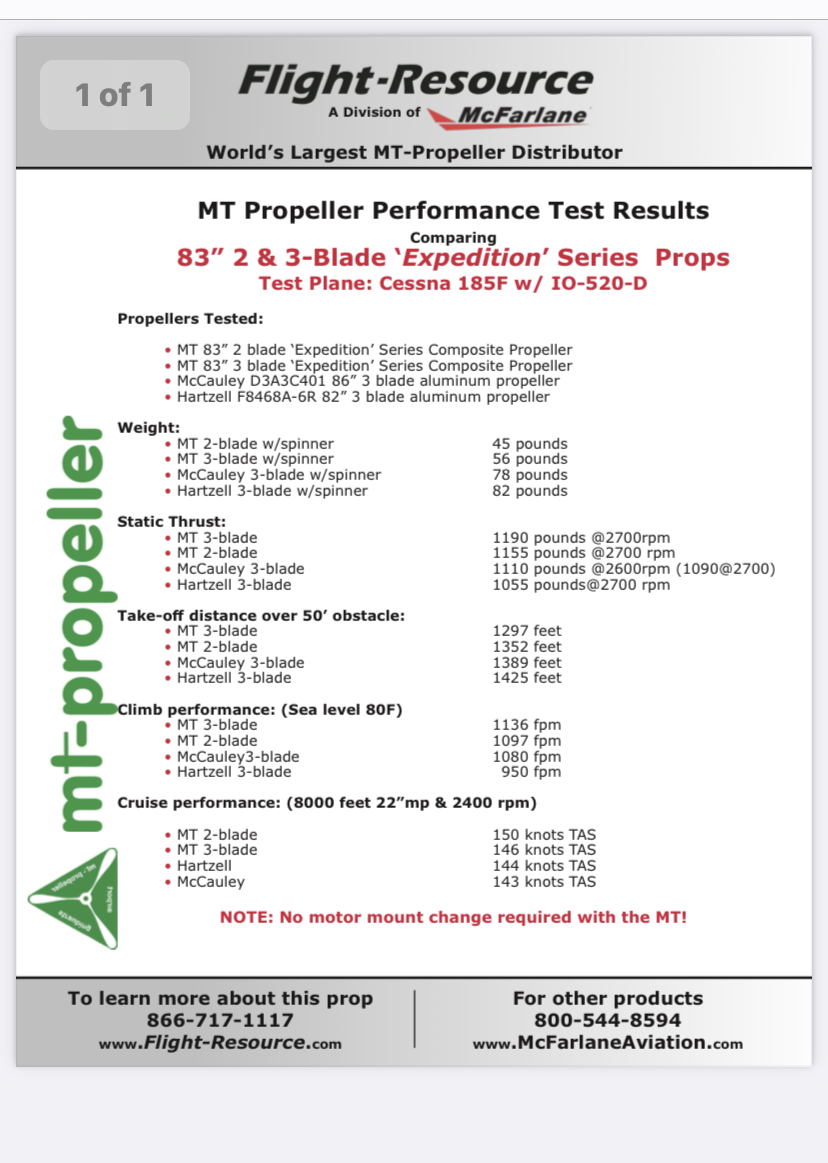

If I recall... that 401 weight is sans spinner and backplate. I think the MT one sheet is pretty close to the last one I pulled off.

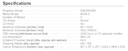

FWIW... when folks talk about the "Black Mac," they are referring to the 403, 3 blade. Spec sheet says 64.5lbs w/o spinner.
Screen Shot 2023-05-09 at 2.17.43 PM.png (56.71 KiB) Viewed 2078 times
Bigrenna online
Posts: 2359
Re: MT 2 or 3 blade
Bigrenna wrote:Everyone is always so confident on this this forum. LOL
FWIW when folks talk about the "Black Mac," they are referring to the 403, 3 blade. Spec sheet says 64.5lbs w/o spinner.
Not picking on you bro, just adding clarity for accuracy :lol:

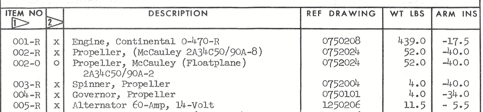

Rob wrote:.....soy is quoting a modern C203, your screen shotting a relic C50....
I think Renna was pointing out that the arm for the prop is indeed -40",
as per that W&B sheet (which looks like factory issue) as well as the C180 TCDS.
Posts: 10608
Re: MT 2 or 3 blade
The C50 prop is a different hub and old design which is no longer available and not what is installed on my plane. According to McCauley application guide, page 51, the prop that is installed on my plane 88" is 59#:
https://mccauley.txtav.com/-/media/mcca ... guide.ashx
Of course that very same document claims the 82" variant is also 59#, so you got me how that works. There are 2 other flavors that report both the 82" and 88" lengths are 52#s. So I believed the 59# which was also reported/quoted by a local prop shop.
Also, see the note at the bottom of page 4 which says that the term BLACKMAC covers all the STC's McCauley props in that doc from 2-blade to 5. I hear plenty of people refer to the seaplane prop as a blackmac - but since it's on the TCDS for the 180 I don't need the STC for it so maybe according to the semantic police I'm not allowed to call it a blackmac. I defer to the greater wisdom and the higher certificate holder.
And the -40 station arm does appear correct according to my ancient WnB which was superseded 15 iterations ago in 1992 when it was installed. I was confused by the fact that in spite of searching and reading it 5 times over, the 5A6 rev 68 TCDS for the skywagon does not list the arm for any of the prop combinations. It's also not listed in the station diagram of the 100 series service manual, either. What prop #11 for my plane, a 1955 180 which refers to station 30 pitch settings, which initially confused me because I was looking for the location of the entire prop:
