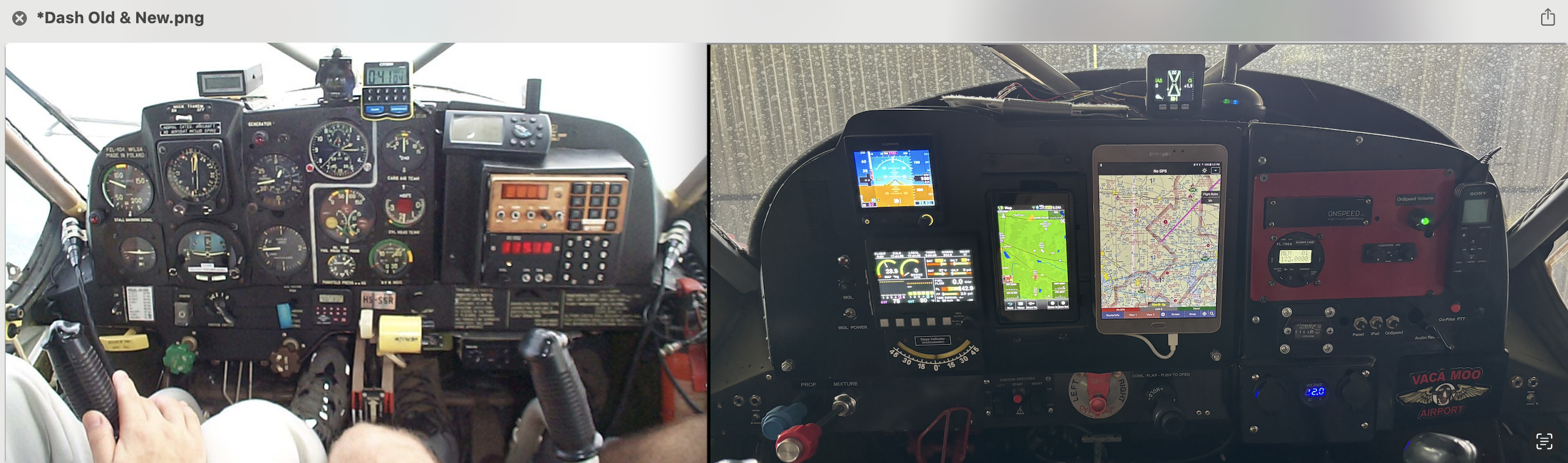

Quick update on the Wilga. I upgraded the avionics and now have a nice modern dash.

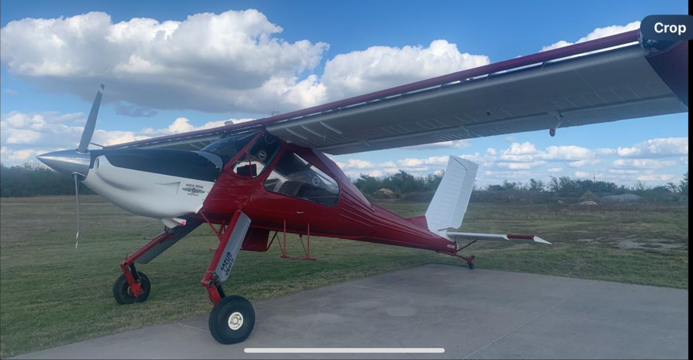

LATEST UPDATE :
If anyone is interested in a great backcountry 4 passenger plane with lots of space and STOL performance, give me a shout !
After a couple of years enjoying my awesome Wilga, my health has improved and my priority is now getting to my daughter's house without having to drive 12 hours, so I'm moving on to a faster plane, one that I've dreamed of owning for many decades but couldn't afford to buy back then. Now I can, I found one that I like, and I'm not waiting any longer, so the Wilga sadly has to go for the hangar space. That's the only reason I'm selling it because it's a blast to fly and I love having something very different than the normal plane out there.
Here are my Wilga's greatest highlights: ​​
1- You can fly the Wilga with no medical certificate under Sport Pilot Regulations because it falls under the new MOSAIC FAA Regulations.​​
2- It has all the modern avionics you need, PLUS mine is the only Wilga (not owned by Mike Patey LOL ) with a full navigation autopilot included.
3- It has an Experimental-Exhibition certificate. Thankfully, it's not the same thing we used to have to contend with many years ago, now it's just a letter emailed once a year to the FSDO and nothing else, then you enjoy flying it pretty much like any other Experimental-AB plane.
4- I'll give you 100% Ownership and Admin of the Wilga Owners Facebook group page
5- It's already here in the USA, so you don't have to spend thousands of dollars more just to bring in a $225,000 Wilga from Canada, or a $170,000 Wilga from South Africa !!!
I've prepared a long specs list with pictures and videos, so if you're interested, just shoot me an email and let's talk.
