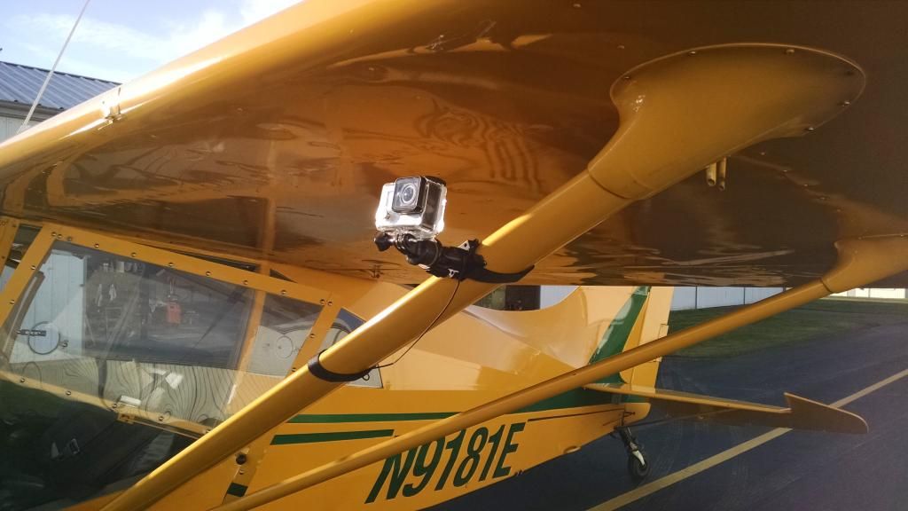

I have been using Marc's mount on our pacer and Taylorcraft since the first of the year. I have been really happy with the results especially when it comes to the pacer where vibration with my old mounts has been a problem. The picture was steady and the mount is easily removable which is a huge advantage over my old RAM set upImage

Footage from Marc's mount. Nothing exciting just showing how the mount did on our pacer

Now that I see the pic, I can see whats likely causing you any issues on vibration. Having the camera with the vibration isolator out straight like that just increases the moment arm on the camera and will amplify vibration. If you have a look at the camera layout on the Pacer in the pics above you will see how the moment arm is less. ou can have the camera normal or inverted like on the pacer. Also 60FPS will give you best results. Also having the damper in that orientation is not as effective as vertical. Give that those a try and let me know how it goes.
