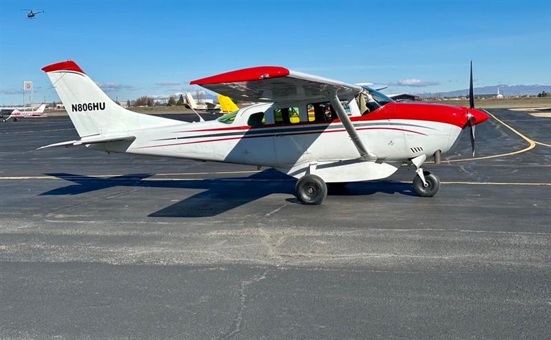

My mission profile is very similar.
I do have some subtle shaking in cruise from the 8.50 Goodyear 856T61-1 mains, it's my only gripe. I have not noticed any issues with asphalt performance, my 182 had 8.00 mains, that's my only other experience. My other gripe is not being able to get the leak stop tubes in these sizes.
Also, I recommend practicing dead stick landings. The real-world glide ratio might surprise you.
The 206 flies much like a 182, but I used to land my 182 with a bit of power on, I have to chop the power completely in the flair on the 206 or it will float forever. That's with a Robertson though.
On the nose, seems there is a bit of debate between 7.00 and 8.00 paired with the 8.50 mains. I'm not sure if the airglas fork is longer relative to the axle position - ie: if the new fork alone will change the angle of attack on the ground in addition to a slightly taller tire. I can't imagine the difference would be immense, but my plane already sits a little tail low with the Gooyear Flight Custom III 706C66-3 7.00 in the stock fork.
The tail skid recommendation is a good one. You can load these things to where they are very light on the nose and they have a fair bit of elevator authority.
I don't have many poser shots on the ramp, here's one that shows how it looks with this tire arrangement.

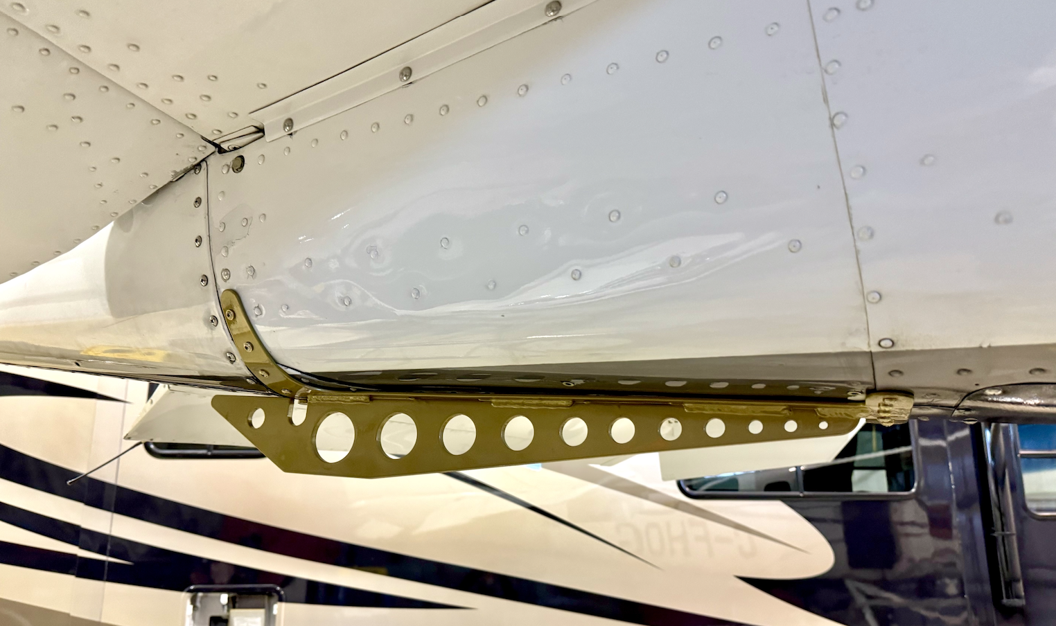

Here is a picture of the Middle Fork Mod Skit installed. we made it removable so the Ventral fin can go back on for floats
It looks epic and we paint matched to the scheme. total investment is hefty tho..
I think a lot of people put a home made one on there.
