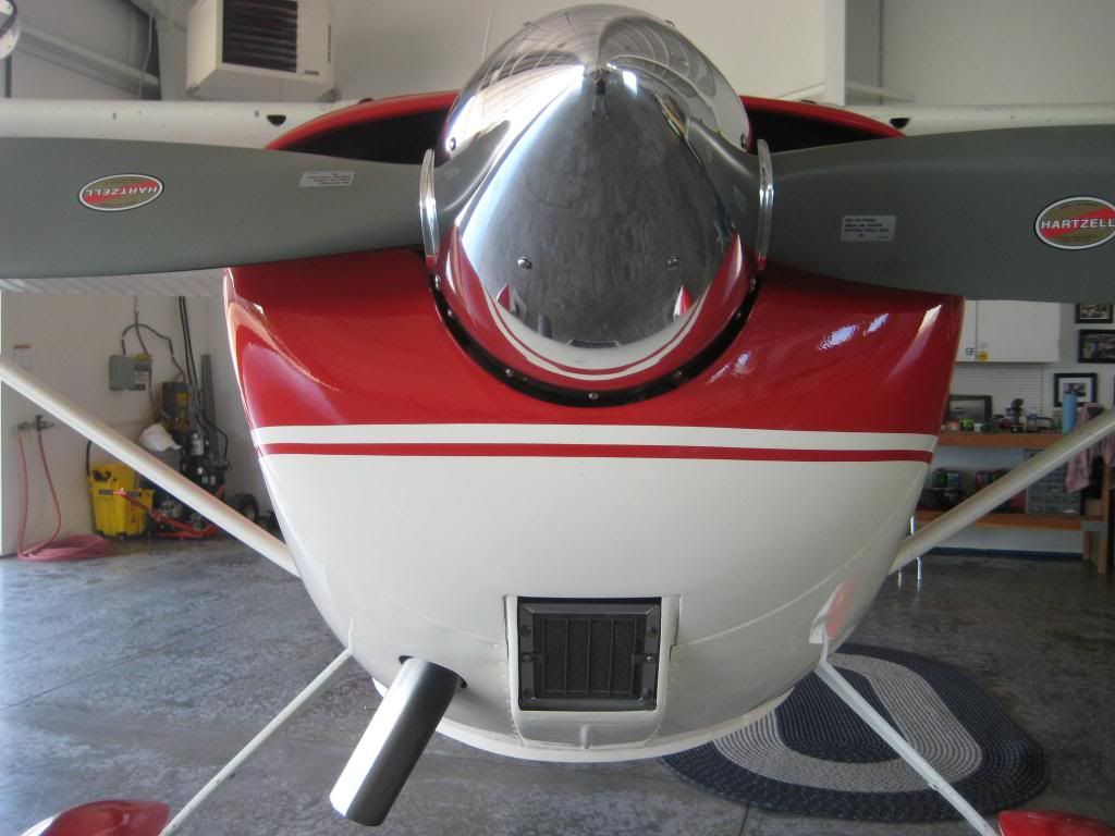

Our '52 170b with the 180hp Avcon conversion is eating through the lower section of the nose bowl. The spinner screws are hitting the nose bowl in flight occasionally, and the lip that re-enforces the lower bowl just below the spinner is slowly disintegrating. First of all, what would cause that? I suspect sagging motor mounts, but they "look" ok to me. It can't possibly be my piloting skills, as they are impeccable. Secondly, if I needed to get a new bowl, where would I go? I can repair it as it's made of fiberglass, but it has a few other problems that might be best solved by replacement. Any ideas?

Regarding the nosebowl, I've noticed the same thing after a particularly rough field landing - must be the motor bouncing on the mounts inside the cowling. Put some fiberglass reinforcement on the inside of the nosebowl lip and just needs some paint now.

I will probably end up doing the same thing, just putting the lip back on in fiberglass. Any benefit in trimming the bowl a bit? Or is that just putting a band-aid on the problem? How do you check to see if the mounts are still good?

When I changed out engine mounts, I think I expected everything to stiffen up. Even when bushings are new, there's still a lot of weight hanging out there. Unless you are currently seeing significant sag, I wouldn't think changing the mount bushings will inhibit the amount of movement needed to scrap your closely cowled spinner and which you are going to get in turbulence or with a rough field landing. My 0.02.

Our 170 kinda suffered the same thing. When I was 15 my instructor was putting me through the paces in preparation for my solo. When we were tying down the airplane after performing accelerated stalls we noticed that we laid a nice groove in the bottom lip with the spinner screws.
25 yrs. and a few extra cowling issues later, I thought I would try my hand at fiberglass work. I built up the back side of the nose bowl below the lip with glass, enough to be able to sand down the lip to give a little more clearance.
While I was at it, and because I had replaced the starter with a Skytech, I didn't see the need to leave the bendix notch in the bottom lip. As a matter of fact the Avcon nose bowl didn't follow the arch of the spinner along the bottom very well at all, so in the process of glassing and sanding, I did my best to clean that up.
As luck would have it, when I was prepping my son for his solo, I let him drop it in from a X-wind landing bounce and well, we found out that I glassed her in a little too tight to the spinner, so if you look at my bowl today you'll see that I took the round side of the sanding block to the bottom lip again to give it another 1/4" or so of clearance. Problem is I'm too busy to take the time to paint it right now.
From the picture you can also see that I tried my hand at flush patching around the exhaust pipe. Not the best work, but I got a contact that I'm gunna take advantage of next time that has an english wheel for that compound bend.
Don't know if this helps, but maybe it will give you the confidence to go for it. This was my first time glassing and I did it without removing the bowl from the cowling.

Sounds like your engine mount rubbers are sagging- not uncommon, esp if it's a dynafocal. If so, replacing them should solve the problem or at least help. You might also think about shimming the engine mount at the firewall, but this willl have an effect on how the airplane behaves when you put the wood to it-- think "thrustline". If you're not well-versed in that stuff, talk to someone who is before doing this.

Yep, you need new motor mount bushings. Not a big deal, either in effort or cost, just a bit of a PITA.

I'll order the new bushings/ motor mounts today. I have to go down to the airport to get the part #'s. My dad is pretty good with fiberglass, so we'll do the repair of the nose bowl ourselves for now. How much are the Del Air nose bowls?
I like the work you did on yours, TomW. We have the notch for the old starter as well, so we'll take that out when we do the repair.

What a brilliant picture for explaining the problem - if only we were all so organised!
I have been thinking about cowl interference, my theory is the increased weight of the engine in high G maneuverers causes the engine to sag in it's mounts and make contact with the cowling even though it doesn't touch when sitting on the ground... In which case, new mounts 'might' help, but there's no guarantee I can offer (beyond my experience) - it would depend how much sag the mounts have accumulated. I think they are supposed to be replaced every decade or something like that. It's on the paperwork.

I don't think you need g forces to get those engine mount rubbers to deflect. I watched a 180-horse Supercub fire up with the cowl removed once, and I thought the engine was gonna jump right off the airplane before it settled into an idle.
