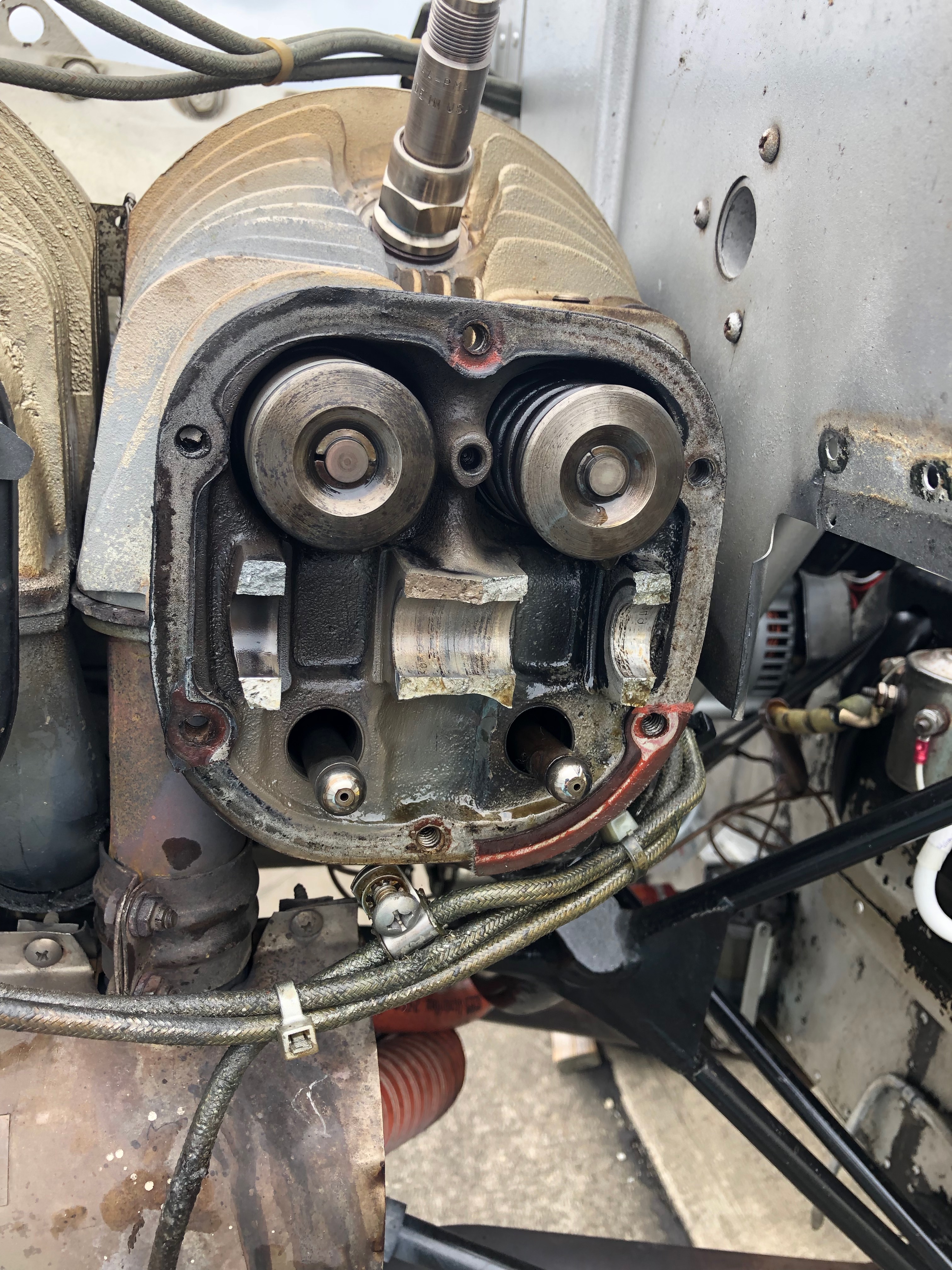

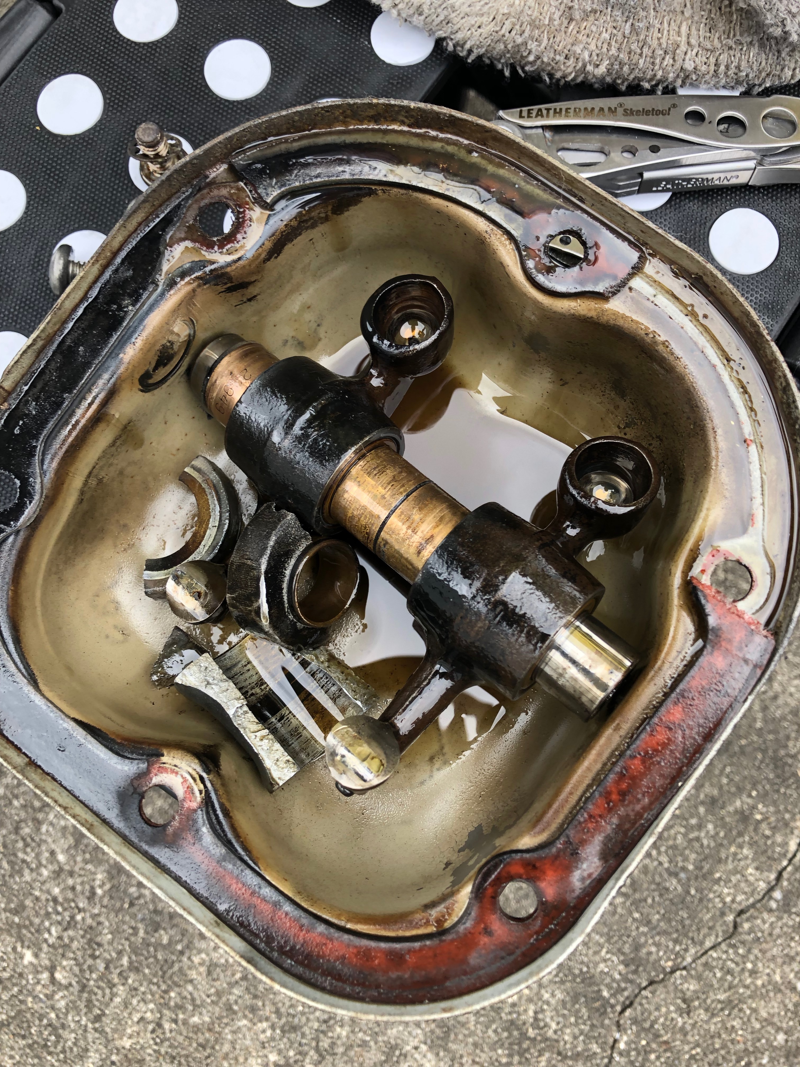

If you thought the O300 on a stock 170B was underpowered before, try running on 5 cylinders. This came apart in flight at ~1500AGL. Lost a few hundred RPM, but it kept running to a field. No oil loss, and no metal anywhere else in the engine. A cylinder change and back in action.
A good outcome, but it get's your attention with wife and daughter on board.

Wow. Any postmortem analysis?
Rocker arms look unscathed. Those cast rocker shaft journals always give me the creeps though. Looks like it's not unfounded.

The best comparison would be that it felt a little worse than a stuck valve. Same sort of total engine response. It went way out of balance, rattling like crazy, and dropped RPM.
If you look at the pictures, you can see two different colors - it must have originally cracked at some point in the past, and then finally gave away. We had been at cruise power for 20 minutes, and had not touched the throttle for a bit.
Asking two different guys how you would prevent this, the response was, you probably couldn't. Maybe a die penetrant test, but why would you think to do that here on the cylinder? Maybe always go with new cylinders instead of overhauled to avoid unknown, unknown metal fatigue?
Just spitballing. I don't really know. Just be constantly prepared to put it down.
