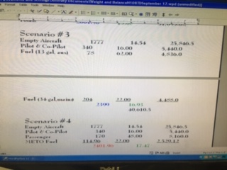

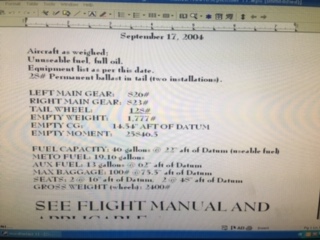

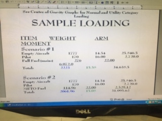

It would be great if you could find the W&B for the o470 conversion. Have you ever done the o360 conversion? If so, do you have a W&B for that?

The new Denali Scouts all run O-390s. They are making 210hp. So they are out there in certified aircraft.
For the W&B, the one I did with the 470 was within limits empty and just got better with fuel and baggage.
