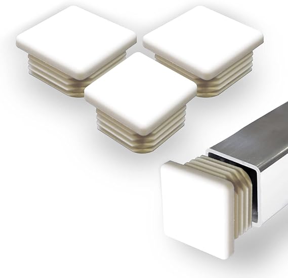

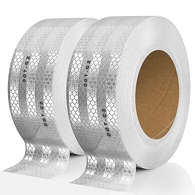

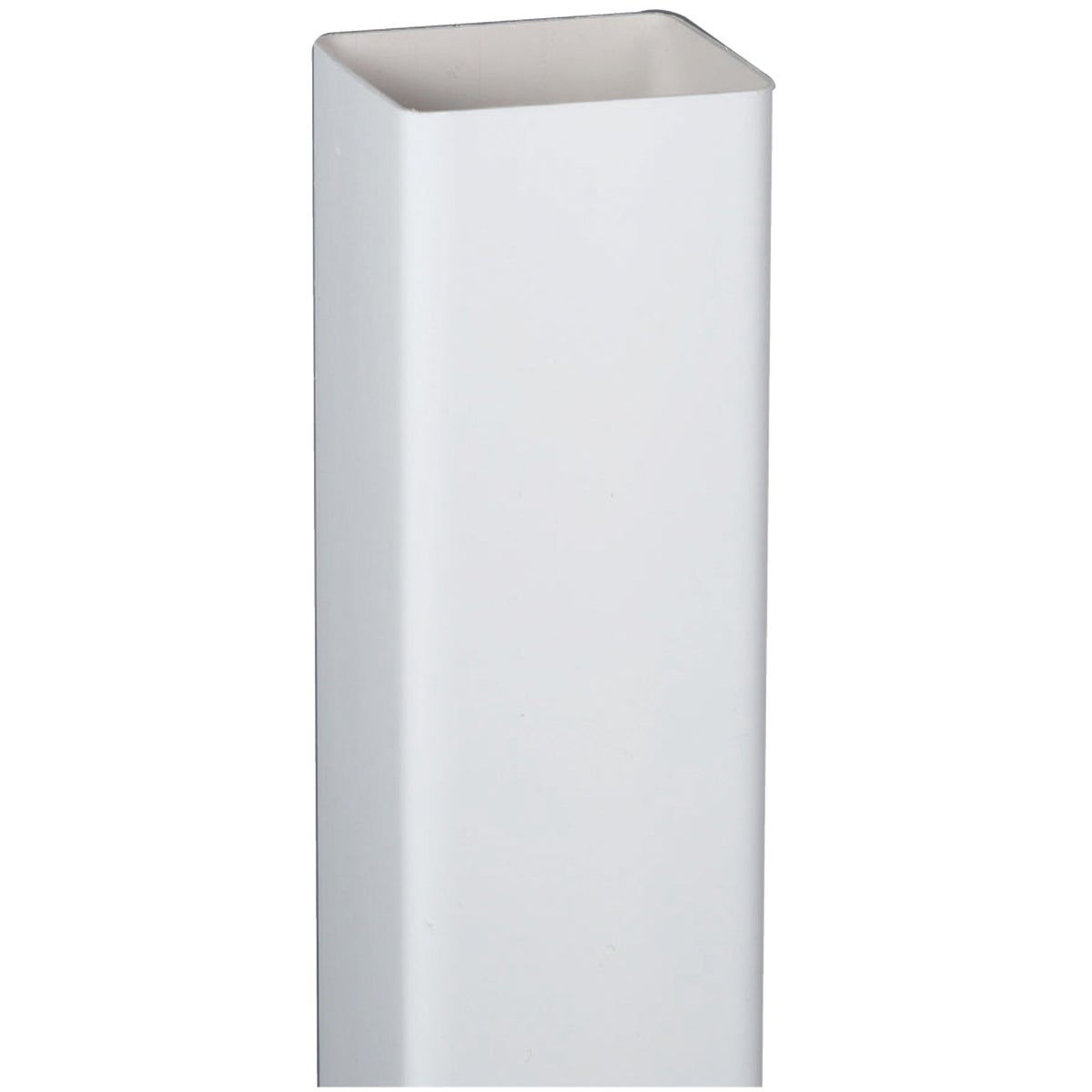

We cut 3' pieces of white 2" square PVC downspout into 36" lengths. Bury them 18" into the ground and put a PVC cap on each one. Drill a hole in the top snug enough to capture the light 'post' and slide the light right on in. Then stick road sign quality 2" X 12" white reflector tape on the front and aft facing side, you can use red on the last two or three. The lights can be picked up from a few miles out, but if you have any reasonable landing / taxi lights, the reflector tape will boom out and blow the lights out of the water. Get at least 20 lumen lights, verify that the batteries are not made of unobtaniumn, and be certain to get ones with glass domes, preferably a decent reflector, and no gingerbread or lattice work.

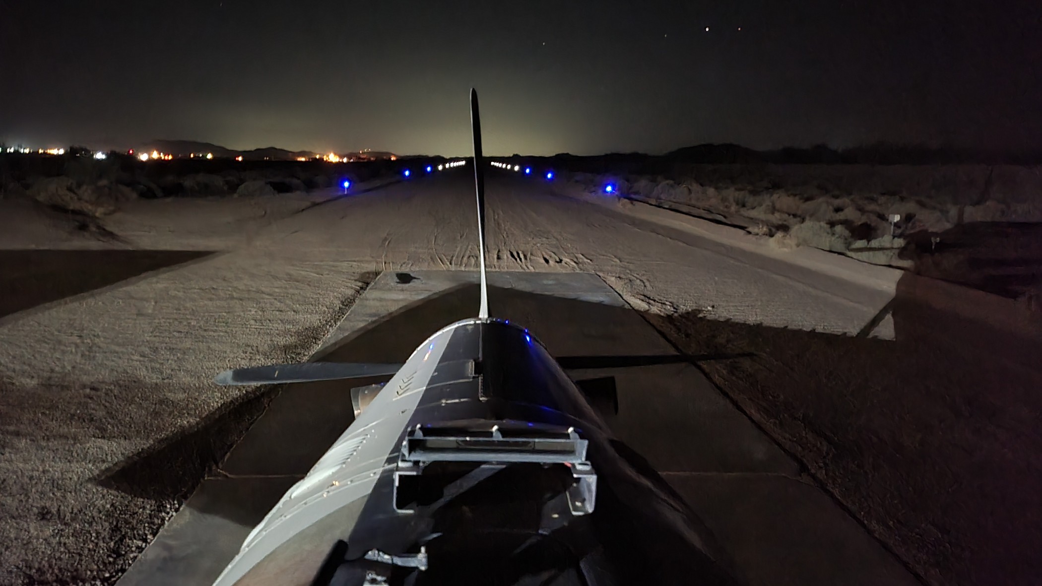

I use solar powered deck lights from Amazon mounted every 100’ on top of electric fence post. Pics are 1 mile out at 200’ agl and “over the fence”. Probably not gonna find the runway from 5 miles out but they work for me because I know where the runway is and how to land in relation to the lights.
They come in different colors,

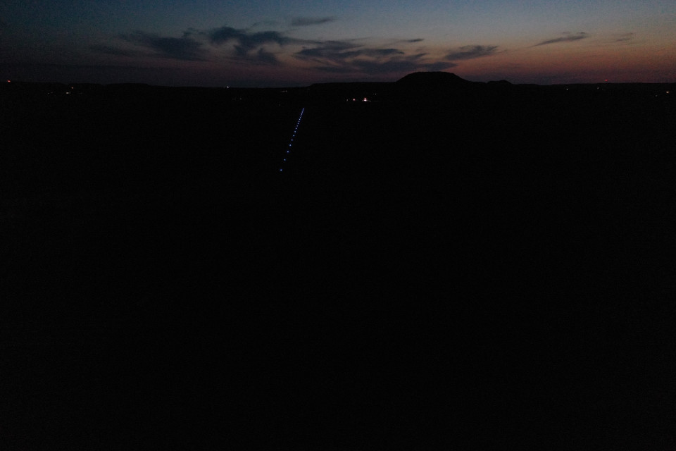

Kind of like Rob, I used reflective tape on interval posts along the fence that keeps the cattle out. Beyond that I installed solar powered garden "spotlights" https://www.ebay.com/itm/403656241073 at each end of the runway. Then I configured a user waypoint in ForeFlight to be my final approach fix; get on course, at proper altitude, and look for the solar lights that identify the end of the runway. Works great. I went this route as I didn't want to broadcast a lot of light attracting who knows what. The strip is impossible to find in the blackness it is located in without the solar lights.
