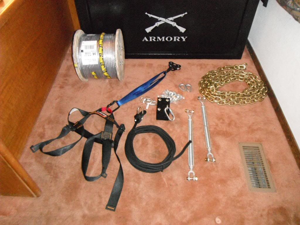

I just built a lower-octane one for the kids. Looks like you have a pulley-system already. Petzl makes some good ones with high-speed sealed roller bearings, and some with steel sheaves to take the abrasion of your cable. Be sure to look at their "speed" variety. And I would personally use a full-body harness instead of a sit harness. Helmet is up to you I guess. Have fun! :D
Oh yeah-lengthen that blue runner so that there's no risk of fingers and/or hair getting into the pulley. And what's your arrest mechanism look like?

This is strictly an owner operator, experimental, field approval zip-line apparatus. I am improving on a few things by safety wiring the turnbuckles, and replacing some of the hardware with hardened stainless steel. Lock-tight on all the bolts will make me feel better too.
The brake system is a solid plastic block sleeve attached to the cable then tied off to a bungee. Hope it works. I plan on sending a 200 pound duffle bag of rocks down the line the first few times as a un-manned zip-line test pilot.
Anyway I'll have more pictures and updates in the near future. Wish us luck.
James

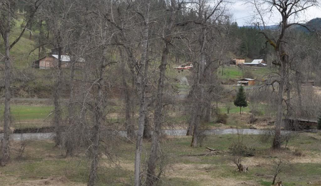

Launch site: Image

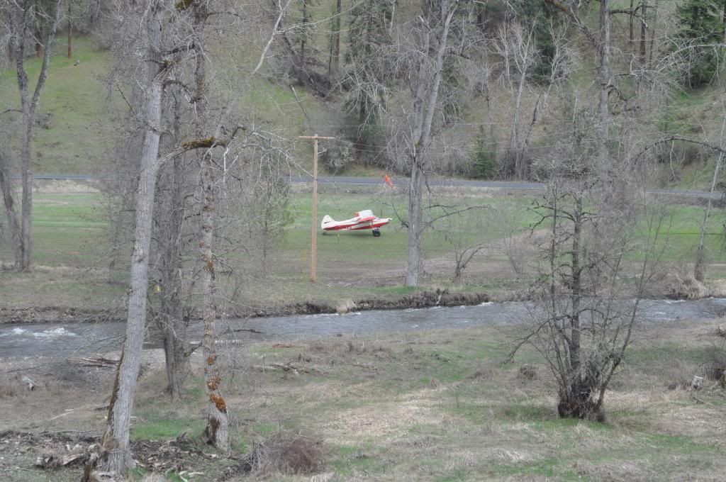

Landing: Image

What is the useful load going to be? #-o
Just wonderin because I might come visit!! =D>
If I do I think you should try a bigger duffle bag!! [-o<
Is that 1/2" Cable? :shock:

I have built several Ziplines using 5/8 cable and have seen what happens when anchors fail (landed in water). It is easy to see how 200 lbs will pull down on the anchors but the tension in a suspended cable can easily be greater than the load. The more tension you apply to remove sag in the cable will also affects at what angle your load (you) is suspended.
Here's your example:
load 200lbs
cable length 400ft
Sag 20ft
The tension required is 1004 lbs.
If you find that your are landing short and crank the tension in the cable up to reduce sag to 10ft your tension increases to 2000 lbs.
I have seen the back end of a pickup truck get pulled around so plan your anchors carefully, good enough usually isn't.
Good luck and have fun.

3/8 inch cable and the trolley is rated a 350 pounds. Spoke with a well known ski lift engineer from Spokane about my zip-line and got some good tips too. I'd sure like to see your Wilga parked at Clear Creek someday.
