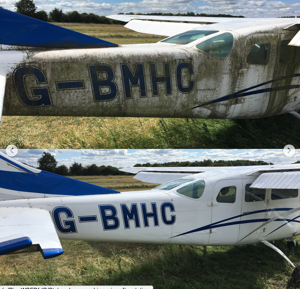

Hey Folks,
I figured there would be some real knowledge over here on this topic. In Europe nobody knows much use for Cessna 206's other than meat bombing. We are restoring a Cessna U206F that flipped in 2005 and has sat virtually finished outside in long grass until we rescued it this summer. Huge work has been done, but the propeller is now becoming a priority. When the airplane flipped the Hartzell obviously got hit hard, the previous owner had a McCauley D3A32C90/82NC-2 and he hung it on there. No logs or paperwork. This is the way it was when we got it. The prop shop we sent it to sucked their teeth hard, and went through the whole obsolete prop routine. We haven't yet asked them to go any further in opening it up.

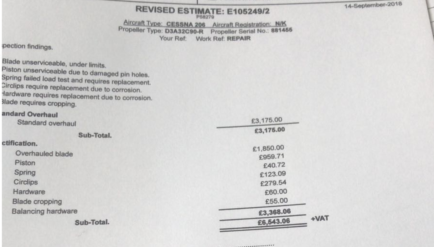

So here's where we got to with the D3A34C402/90DFA-10 I sent to the prop shop:
"Morning William
Not good news I'm afraid.
Your Propeller is very heavily corroded, the Blades, Hub and most of the Internals are too far gone to use.
If you give Mark a call, he can give you more details.
What do you want us to do with the wooden box and Prop"
Here's where we got to with the D3A32C90/82NC-2 I also sent to the prop shop:
$7850 USD roughly and could be more to overhaul it if we need a ferrule.....
I am getting a price from Centennial Air Parts on OHC McCauley D3A34C401/90DFA-10 as shipping a three blade prop to Europe is only $600 by DHL. Any other idea's?
