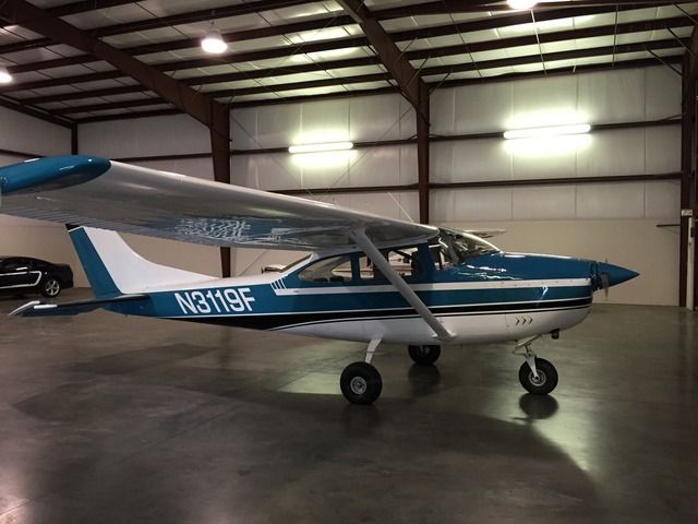

I want to take my bird to the next level of coolness for landing/camping at some grass
Strips. Useful load and airspeed are
Still a concern and I don't need to land on rock bars.
Looking for suggestions on what to get, where to get it and how much I should do myself vs. hire out.
I'm thinking a 6 or 7 on the nose and 7 or 8s on the mains? 8.50s all around seems overkill and too much weight. If I were to put 8.50 on nose might as well go ABWs on mains. Suggestions?

Pretty looking bird.
