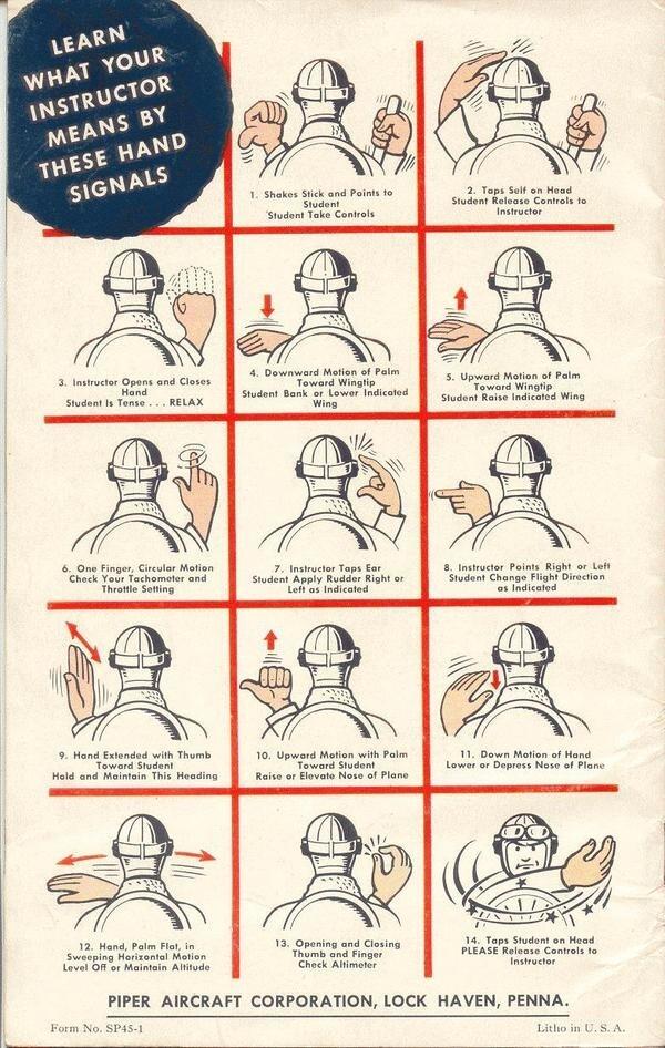

Used to be a comical, but true, chart of the signals in most older flight schools.
Piper puts out a chart with the instructor in the front seat.
Not much humor in it though as in the old original I remember.
One of the YAKS I got to work on was a trainer for MIG pilots and the back seat was full of switches and valves to scmuck up the plane while the student could not see what was about to happen.

wannabe - I think this is the chart you were referencing.

Yeah- that is the "polite" one. Notice though that #14 is with inst. in REAR seat.
The one I remember had no helmets or headsets, and your view was of both instructor and student as viewed from behind the instructor in the rear seat.
The cartoon work was a lot more "emphatic" with the effects of the open handed or closed fist stimulus - response visuals.
Looked all over for it but no joy.
