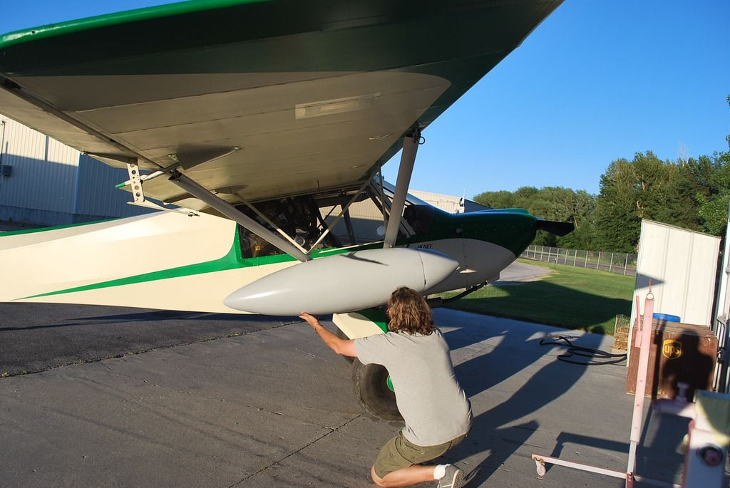

After battling 30 MPH headwinds (getting passed by traffic, reminded me of the ultralight days) coming back from Montana yesterday I stopped by Joel Milloway's shop in Blackfoot to pick up a few gallons. As usual he had something new to look at, this time a prototype pod. This one was glass, the production model will be CF. The nose cone is a standard spinner, no use re inventing the wheel. It will be secured with two snap clamps and be sealed via an O-ring for waterproof storage. A yet to be installed glass flange will mount aluminum channel in such a way that the pod will be able to quickly come off and on the jury struts via pip pins. For the belt and suspenders crowd, castellated nuts could be used. They will have a handle, so after you land behind the motel, you can walk around to the front and check in carrying them like Samsonite 8)
Painting them to match the paint scheme of the plane is a given. Putting fins and a little whip antenna on them to make them look like some kind of guided smart bomb would be optional. Using a single one as a belly pod is being explored. Depending on the days mission, one on the belly or two on the wings, all with common hardware, is a possibility. It looks like I may be doing some flight testing, I'll report back on that. Bearhawks are out of luck, you need two lift struts, plus you already have plenty of room. The target customer base is anything experimental and with two lift struts, and with too much crap to fit inside the plane. My first thought was, clean clothes in one pod, dirty in the other. No more stuffing the sleeping bag in a stuff sack, just pod it. Light but bulky items would be the key I think.
Ahh, you dashed my hopes! You can never have too much room... :(
Be great for bear spray, 1-lb propane bottles, or anything else I'd prefer not to have in the cabin.
Then I began thinking about an in-flight cabin release; the possibilities are endless with that! :shock:

Those are cool!
Re: Pod People
Haha - my first thought too - looks like a drop tank! I'll say no more :mrgreen:

That looks like the belly pod that Dan Denny made for the Kitfox back in the day, similar proportions anyway. Nicely done and at a fair price.
These Milloway pods are more then twice as large, 60"+ long, and really have some substantial interior volume. Their overall shape, their fineness ratio (I think I have that right, check with Barnaby Wainfain, love that guy) is closer to the ideal streamline shape. We talked about the cubic inches capable of being carried, and the math to figure that out is beyond me anyway. So, we quickly moved on to the concept of simply filling it with water and then converting the total gallons to cubic inches.
I've toyed with the idea of a belly lumber rack for my S-7S for some time, a light framework hanging off the gear fittings and the float bushings, quickly removable, that would work like the rack on my flatbed, but upside down. It would be easy enough to have a system where one day you could hang a fuel pod under it, the next day a luggage pod, the next (in my case) a solar panel for delivery. A multi purpose rack in other words. These pods are so large I am personally more interested in a single one for the belly, I don't have that much crap to carry to need two.
I for sure would lean towards the side door, in addition to the removable nose cone. I could see the clean socks I want being at the opposite end of the nose opening and having to drag everything out to get to them. More doors mean a little weight and complexity but it'd be worth it.

Having just camped out last weekend, I can see them as a time saver. No more putting the tent, sleeping bag, mattress pad etc. in their individual stuff sacks and then arranging them in the baggage compartment. Just stuff everything directly in the pod, and leave the stuff sacks at home. This would leave more room in the main baggage area of a small plane, and that is where the extra beer could go.
The other thing I didn't mention: the possibility exists that Joel will engineer a framework that will convert 2 pods into......wait for it......a pontoon rowboat! Perfect for the fisher person who is hard up for space, talk about killing two birds.

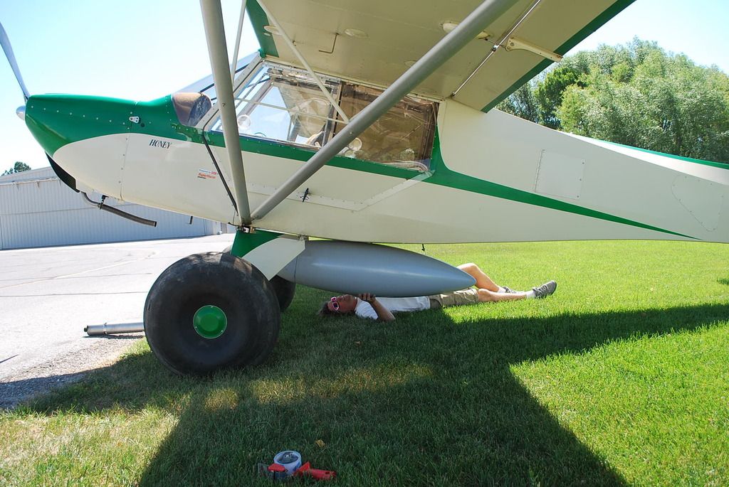

We played around with using one as a belly pod, not enough ground clearance for my tastes, I'd high center it, though it would work, for a while. Note the Swiss muffler laying on the ground, I took it off in about 2 minutes, as it normally runs down the centerline. If I had a belly pod I realized I could still use the SM, I'd just run it alongside to the side of the cabane, under the gear leg.
Though now... that I'm looking at this picture, along with you all, it doesn't look too bad. The side door concept would be the way to go if used like this, as the nose would be up as close as possible to the cabane.
