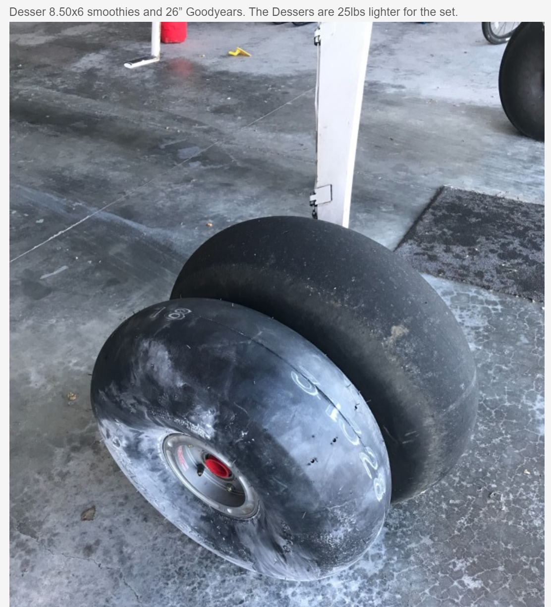

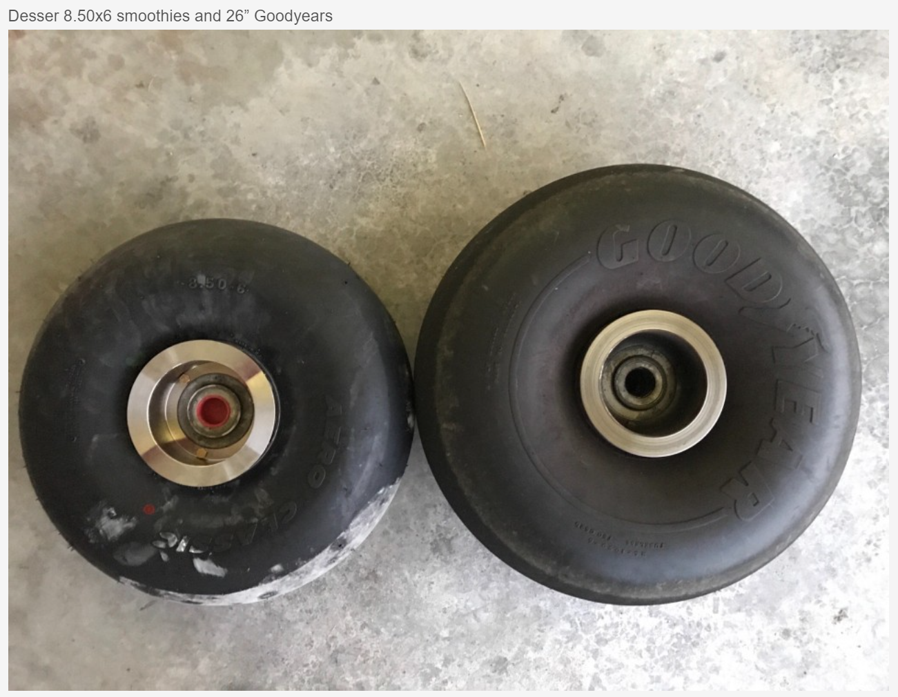

Goodyear's 26" blimp tire isn't actually 26". It's roughly the same size are the 8.50. I am curious how ABW does it, but I know their manufacturing process is not easy, and has alot of fallout.

TangoFox wrote:
Desser Tire wrote: Desser cannot tool up to build anything bigger than about 23” in OD, in a 6” wheel configuration.
The reason behind this: modern AC tire build and cure technology has a limit on the internal bladder and mandrel that is inserted through the 6” size tire...it then expands via high air pressure in the tire cavity for mold curing. There is no physical way to implement a larger bladder in the mandrel to accommodate a larger OD size in 6” wheel, since the bladder cannot retract enough into the mandrel for the 6” hole size (and then pull out of the tire without severely damaging the bead area of the tire). That is why we had to increase the size of the wheel as we went up in tire OD: We are now about at the limits with the 10” size wheel, at 31” OD.
So if its impossible how did GoodYear make the 26" Blimp tires?
Maybe the equipment you have?
https://backcountrypilot.org/forum/tire ... otos-21353
