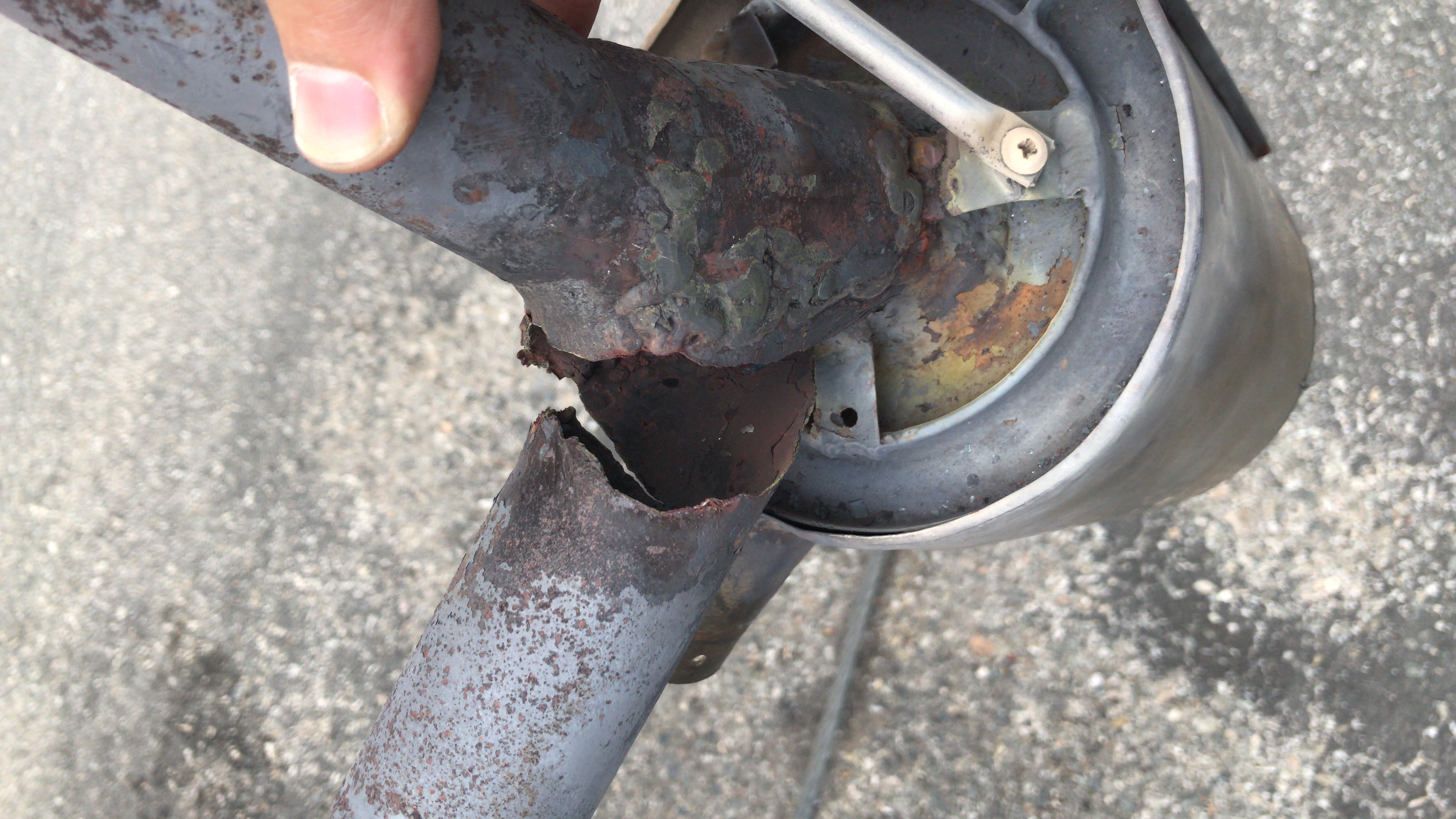

When I got my C120 (O-290-D) it had an old school Y-type exhaust that had cracked and been re-welded multiple times. About 25-30 hours into my ownership it cracked again. I did a little research and found a shop locally that specializes in aircraft exhausts. Spoke with the owner and he convinced me it wasn't worth trying to salvage the Y-type system. In his option, based on the firing order of the Lycoming the cross over system was much better for engine health and balancing back pressures. He estimates 10-15 hp "reclaimed" on my little 125hp engine. He also recommended against mufflers because they are one more thing to break down and inspect periodically, and it's really not much louder. The cross over design also eliminates a stress point on the peak of the traditional Y system.
I saw 100-200 fpm climb increase, a few knots on top end and actually being able to hit the redline of 2600 RPM at cruise. Is that worth $2000? To me knowing my engine is running smoother and not having to worry about my exhaust cracking anymore was well worth the investment. Every little bit counts on these little birds.
Sounds great IMO:
Edit: Not sure why the embed isn't working, but here's the link: https://www.youtube.com/watch?v=ZZpmbXucMPQ
Old system:
