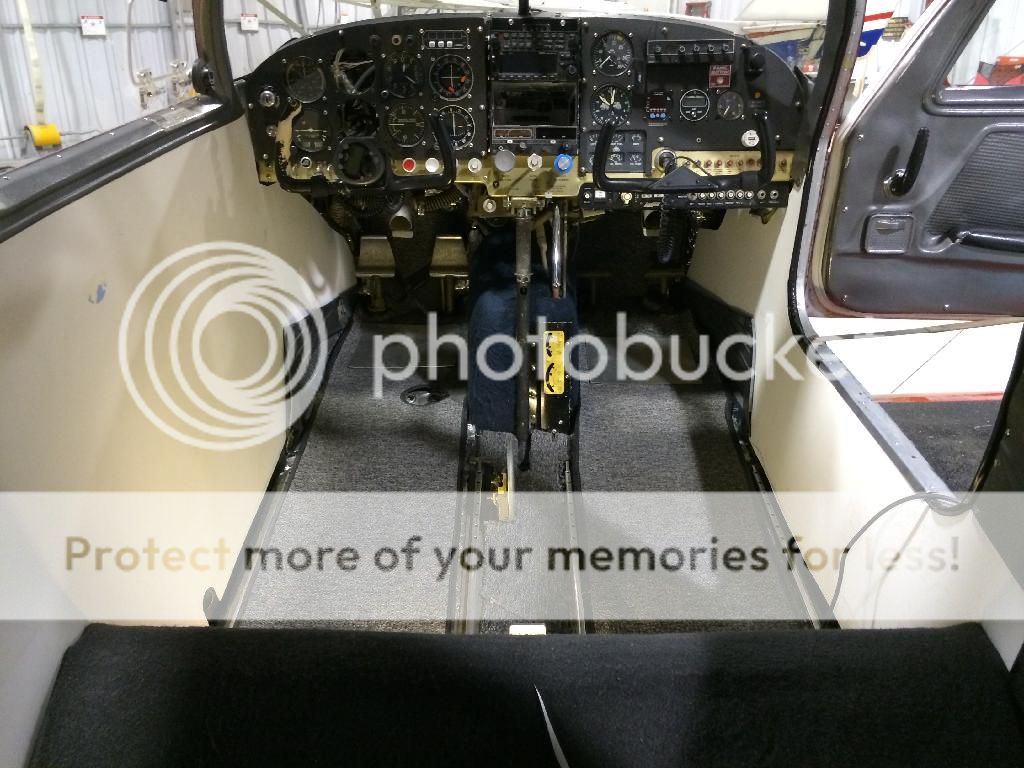

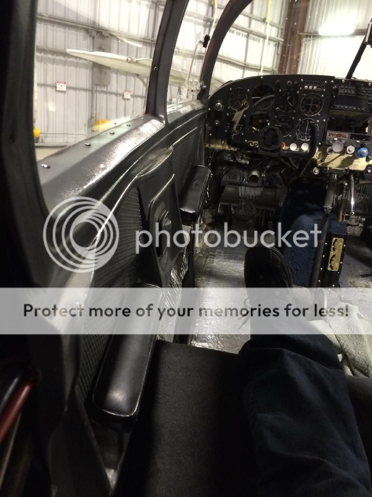

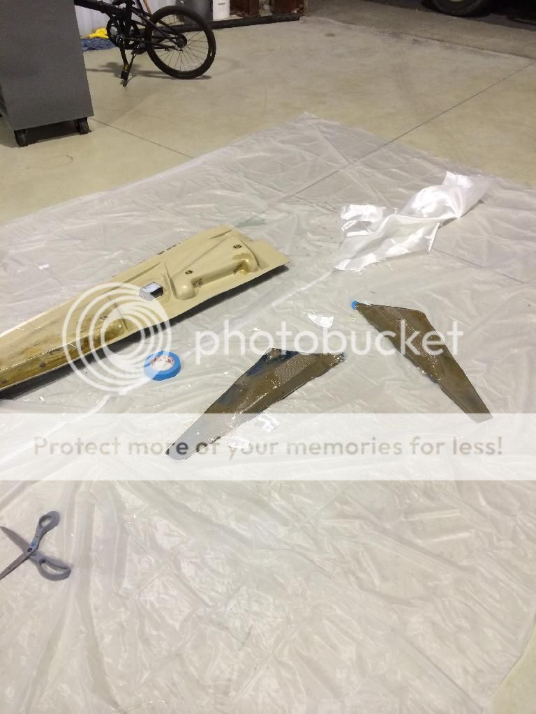

So I have some pretty old panels that are brittle in my airplane, especially the ones at my feet. So I was trying to fix them up with some fiberglass... Well it didn't seem to work that great. Maybe if I use some plastic fixer upper. But really, it's still brittle and sucks. Image

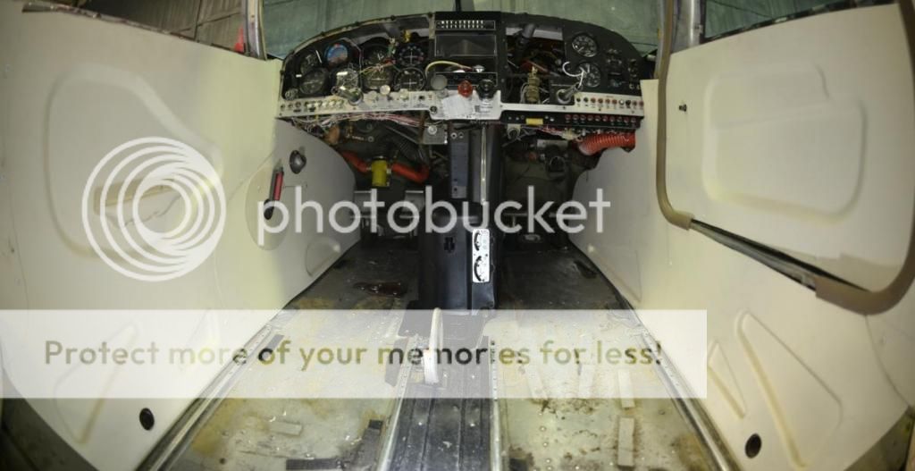

I found out recently that someone trying to make a more spatial interior and he will be selling it for $3000 YIKES! [-X . And the one side panel will cost $300 (it has an arm pinch point and is falling apart!) and the two foot panels would be another $200. Not a big deal, but the panels take up space that I wouldn't mind having, to make things feel more spatial! So here is the guys product.... (NOT MY AIRPLANE!)
