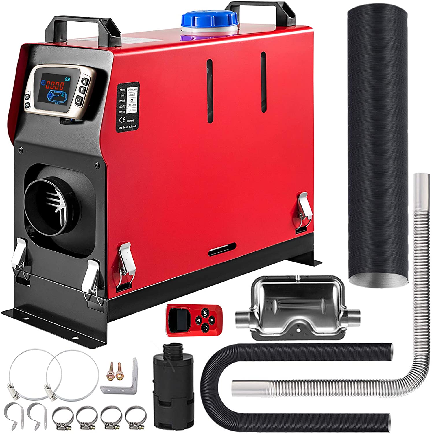

I am going to build a setup using one of these chinese diesel heaters. I have one in a cargo trailer and have been really impressed. Runs on a 12v battery like a red dragon. You could run a return air out the cowl if you want. The exhaust goes out its own port, so the heated air is dry. Not sure what the degree over ambient raise is without a return air.

I have one of those Chinese, diesel-fired heaters. They work okay and put out a fair amount of dry heat for their size. They are slow to start and the glow plug and fan sucks a fair amount of amperage from a 12-volt battery - but they do work.

gahi wrote:I am going to build a setup using one of these chinese diesel heaters. I have one in a cargo trailer and have been really impressed. Runs on a 12v battery like a red dragon. You could run a return air out the cowl if you want. The exhaust goes out its own port, so the heated air is dry. Not sure what the degree over ambient raise is without a return air.
I saw those and have it saved…for what they cost never figured out if it was worth it or if it’d just catch itself on fire.
I have been using these for several years. They heat my boat, enclosed trailer and the plane preheater. I use the 8KW heaters and get 175 degree air at the end of the 6' scat hose at -20 ambient.

akavidflyer wrote:I have been using these for several years. They heat my boat, enclosed trailer and the plane preheater. I use the 8KW heaters and get 175 degree air at the end of the 6' scat hose at -20 ambient.
Is that using return air duct, or just pulling outside air?
Pulling outside air
