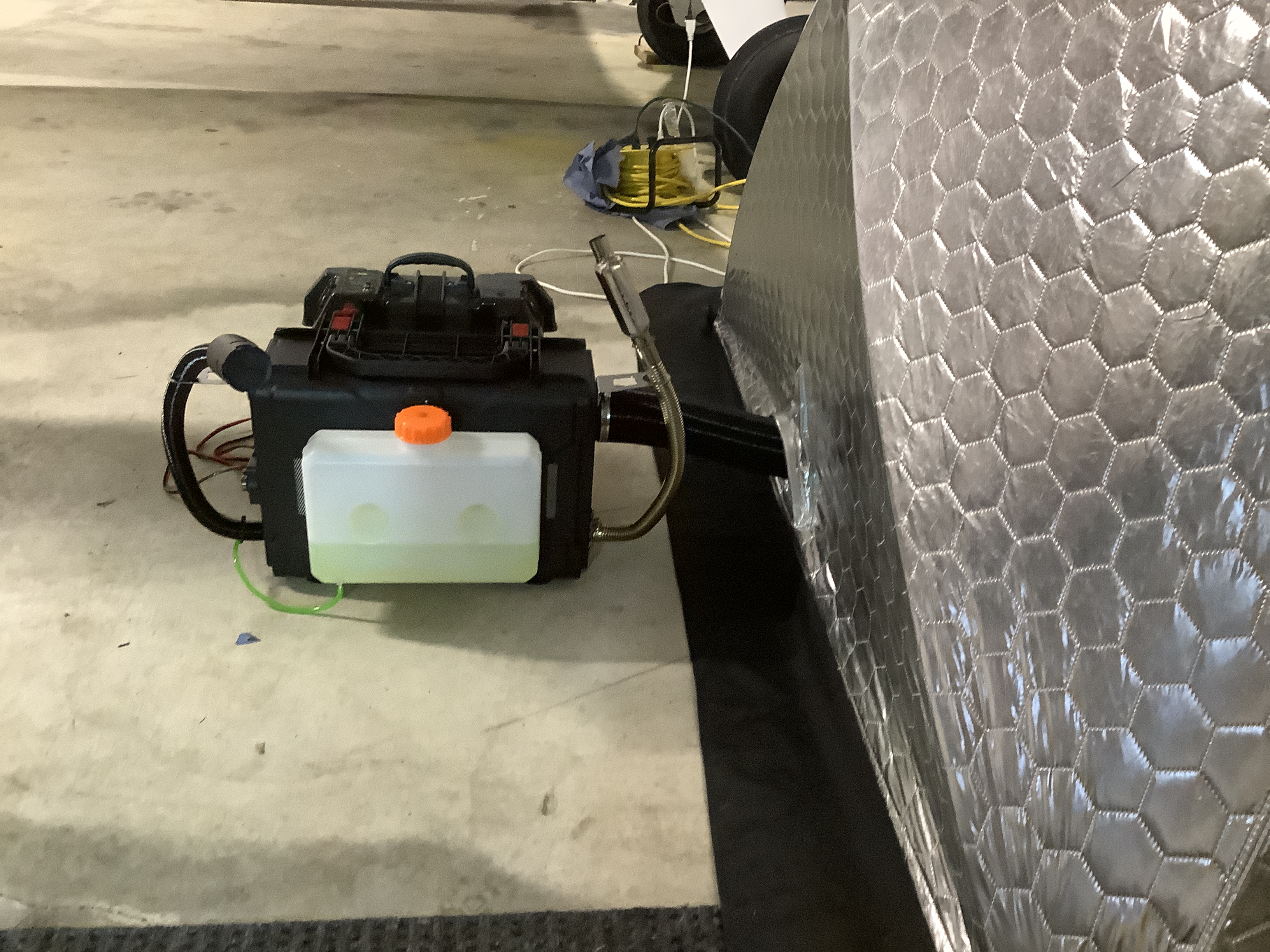

I have a new Hcalory suitcase diesel heater used for my tent but could be applied as engine preheat as well. Pros are dry heat, thermostat controlled by phone, super efficient, everything packs inside of case except for fuel tank as its screwed to side of suitcase with its fuel line slightly exposed. Cons include separate 12V battery required and different kind of fuel required. I don't use this heat for engine preheat as I have E-Z heat pad under my oil pan.
Overall, I'm really happy with this unit.

48Stinson1083 wrote: Cons include separate 12V battery required and different kind of fuel required.
I have a similar unit and, so far, it works great for preheating. It will run just fine off Jet A, diesel, kerosene, etc.
