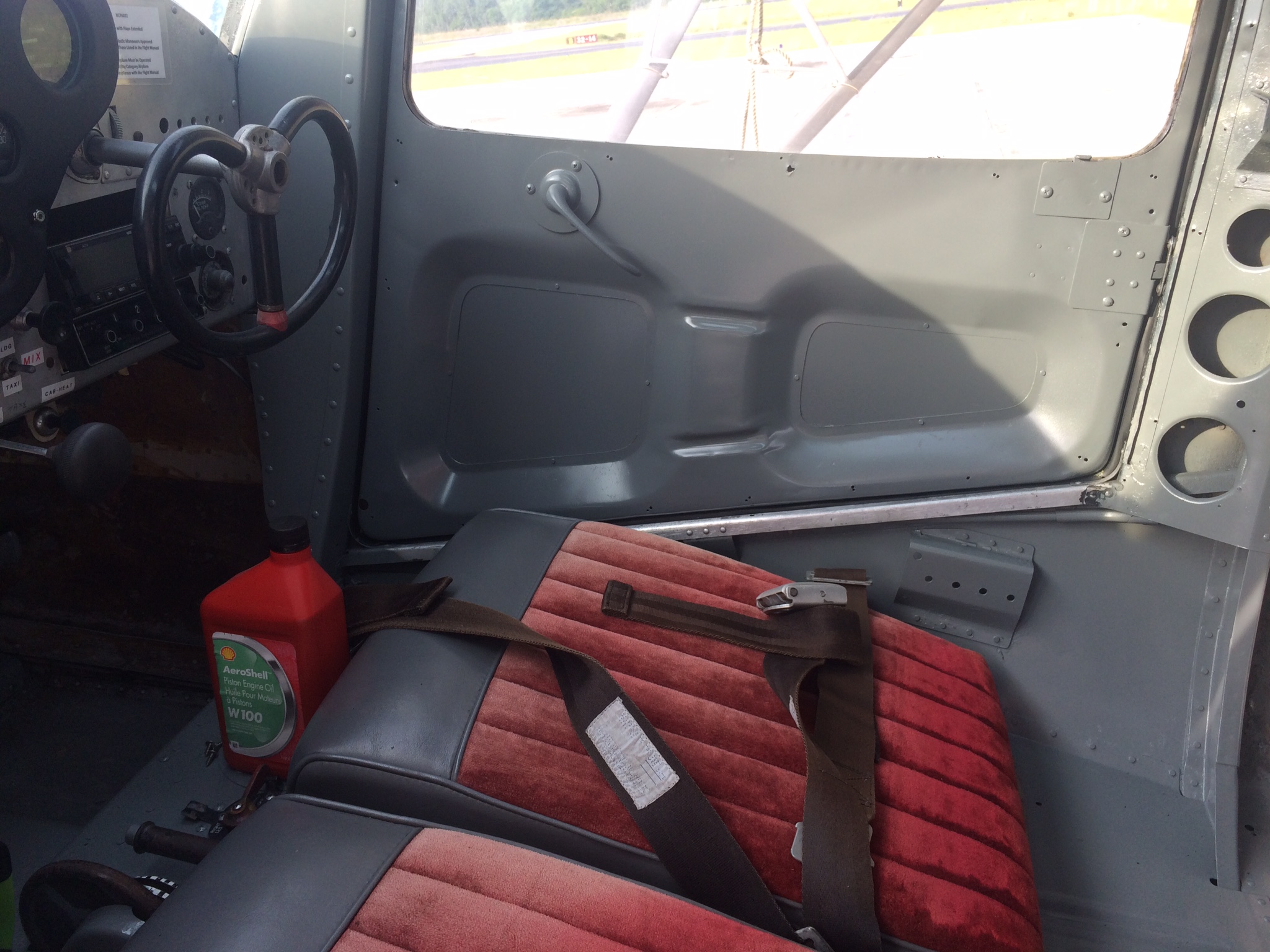

I think yours looks great! I could remove it for now, and then next spring paint it up nice like yours. Mines already really loose and just laid in place. I see there is a fuel line that runs along the fusalage wall under there, did you put anything over that or just paint it with everything else? Any guess on how many pounds you shed ? How is the paint holding up on the floor?
I think there is a pretty good list of things I can get rid of to shed some weight that won't be difficult or real pricey.

I painted everything then put Selkirk around some areas after this picture, the floor where your feet go I left plain since it would get scratched up anyways, but had the pedal fairings and yoke tower fairing painted. Pulled headliner and put in Selkirk. I saved almost 20# of junk doing this. Sold plane later on though, but had fun tinkering. Don’t worry about the fuel line it’s mostly guarded by the frame.
BTW, at least pull out the floor carpet now, you don’t need it wading up under feet during landing.

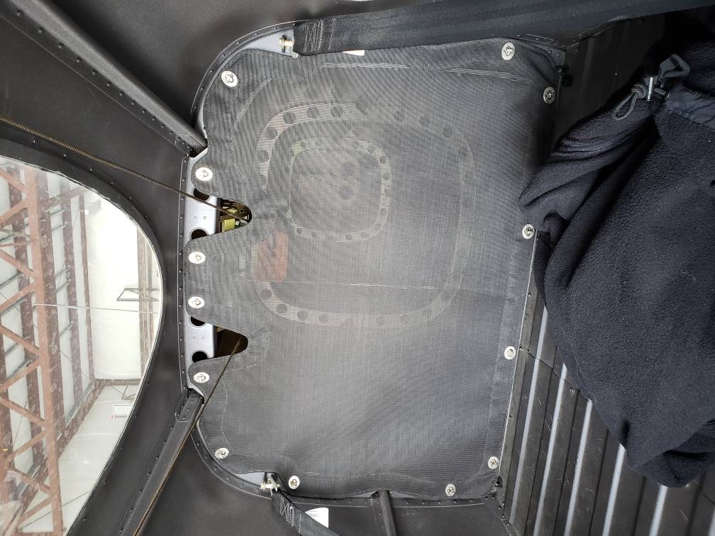

What did others with cessna 140s do with the opening that goes back to the tailcone? The headliner used to cover that hole, but I ditched the headliner and dont want to lose things down the tail.... I thought about doing something similar to the cessna 162 sky catcher in this picture. Thoughts?

Behind the back seat, yes mine has a factory child's seat in back ( hanger decor in the weight loss program soon), behind that seat is a heavy duck cloth type material with buttons blocking off the access back into the tail cone.
