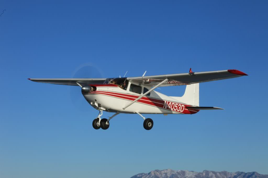

Straubes in Ogden will fix you up for 8-8.5K. They did a nice job on this one. POLISHING BLOWS PROFUSELY!

Beautiful plane!!
And yes...... POLISHING BLOWS PROFUSELY!!!
