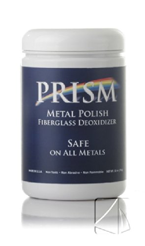

I had very pleasing results with a product not previously mentioned. Prism Metal Polish. Advertised for metal and fiberglass and such. I was turned onto it at my local woodworking supply. I used it on a very chalky airplane paint job and it brought it right back to shiny. (Imron paint, IIRC). I had good results with both hand polishing, and with a Festool random orbital sander with polishing and buffing pads. I've used it to clean lots of other stuff since, including grimy computer monitors.
