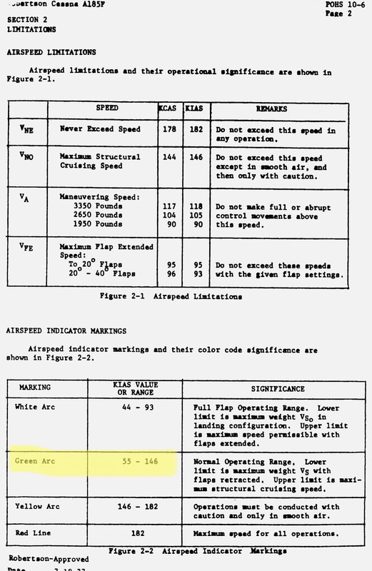

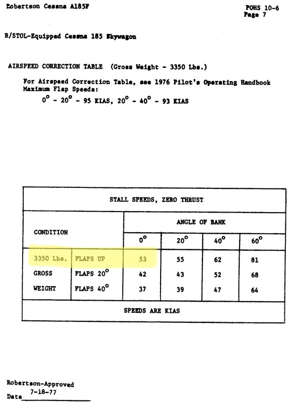

Wondering if Robertson 185s would qualify under the new LSA MOSAIC?
I don’t need it personally, but would increase the value I’d wager
My understanding is the main cutoff is VS of 54kts or less
https://airfactsjournal.com/2023/08/fiv ... -aviation/
In the manual I have shows this
But also shows this

On the max stall speed, keep in mind the difference between calibrated (NPRM says 54 kts calibrated) and indicated (your chart says 53 kts indicated).
Another potential limiting factor for a 185 is the seating capacity. NPRM says an aircraft cannot be considered light sport unless it has 4 seats or fewer. An aircraft with original seating capacity greater than 4 seats does not qualify and can't be made to qualify by simply removing the extra seats. It must have been certified / manufactured as having 4 seats or less. I think that rules out most 185's except for some of the early models.
