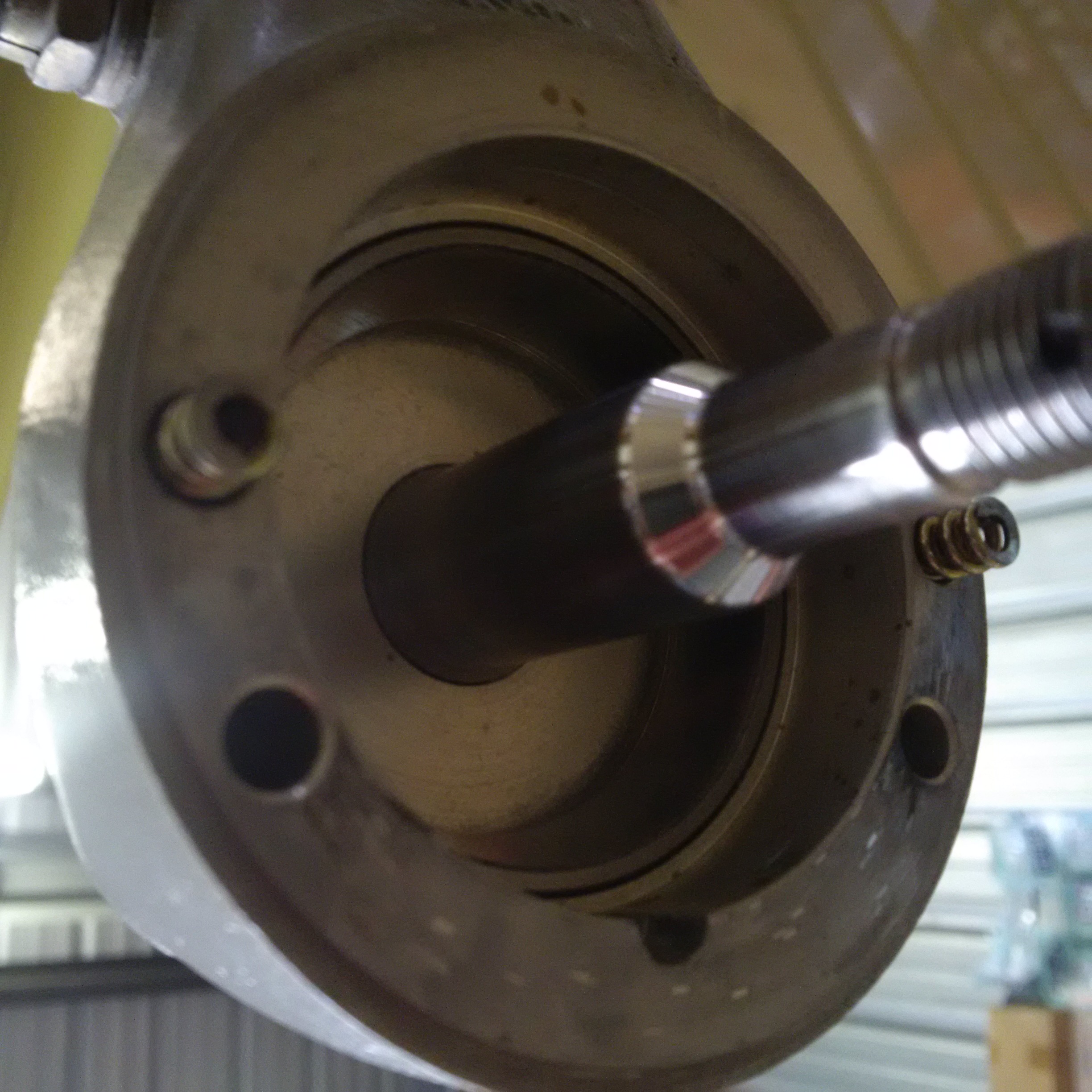

Turns out it was the the u-shaped spring; it broke.
By the way, how many springs you guys have inside your 3400? Mine stock t/w has two. There are four holes - you guys running four springs or two?

I run four, the max in my XP Mods tailwheel.
And I have two p/n 3407-00 spacers under the big bearing on top.
I liberally grease all the internal parts.
I snug up the kingpin nut, then back it off one flat.
Works smoothly with no shimmy.
BTW don't forget to grease the bearing up inside the fork at the very bottom (just above the nut).

Hotrod - yeah, that bottom (small) bearing popped right out with a slight tap of a drift. I had two spacers as well. I will put some grease on the phenolic and metal spacers. What does four springs vs two do?

More springs mean you can get a higher bearing preload force before bottoming out the kingpin nut. For example if you were getting shimmy, you could try adding more springs and tightening the nut. Tightening with fewer springs means the preload force will be lower while tightening until it spikes at the end when the springs start to bottom out. Generally steering would be easier with a lower preload and looser nut. If you were happy with the function before, I would keep it how it is.
The grease fitting on the head doesn't push grease throughout the internals very well. I would basically dunk every component in grease while assembling then clean off the excess once assembled. Properly lubed means you can run the whole thing tighter without shimmy or steering problems. Loose parts move, wear, and break. Well fitting lubricated parts last forever.
Posts: 1533
Re: Scott 3400 T/W and Engaging the Steering Arm
I agree with Asa.
Except that adding more springs doesn't actually pre-load the bearing.
That's what the spacers under the top bearing ("quantity as required") do.
Ideally, you get the bearing loaded just enough to prevent shimmy,
and the springs providing just the right resistance to turning,
at exactly the same point.
I would say add two more springs, but (like Asa said) if it was working well,
maybe you should just leave it as is.
"If it ain't broke, don't fix it".
