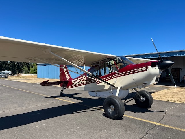

Question: The forward heater outlet is radiating a lot of heat. It would probably feel good most everywhere but Phoenix. Maybe there too in the winter but I'm not sure. Most definitely not in the summer or even last week as I was descending into the valley. I took the valve apart and it's fine. It closes fully (no light penetrates when closed). I think it is a function of the massive amount of air from the large scat tube from the muffler shroud. I may just cap it at the shroud or reduce the size of the scat tube. Anyone else have this issue?
My first attempt at uploading pictures so it may be a mess.....

The ACA heaters are fantastic and hard to get to turn off due to the awesome airflow they have. If you dont need it I’d just remove the scat hose. Another option would be to just covet the inlet with aluminum tape. Or cover part of it if you like the option of some heat. I prefer to block the inlet rather then just capping the outlet.

Blocking part of the inlet side might be a good option. Just so I'm clear about your suggestion, you are referring to the inlet (firewall side) of the firewall mounted heater on/off valve correct? I suppose the outlet side of the muffler shroud is part of the inlet too.
The easiest would be to simply remove the scat tube but would that cause any cooling issues if the muffler scat connection wasn't capped off? I guess all that hot air is just getting directed overboard at the heater on/off valve as it currently is though. I'll have to look at it. I believe it would be close to the carb. Not sure that would be good.

No, I mean the inlet into the heater shroud itself. IIRC, it’s pretty accessible to just put foil tape that. I don’t like dumping more hot air into the cowl then necessary. Stop air from going in to the shroud, and less hot air comes out. This way you could experiment or regulate the airflow with foil tape and still have some heat on cool mornings, but lessen the airflow enough that it doesn’t push through the valve anymore…
