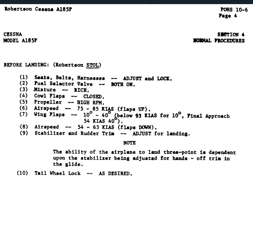

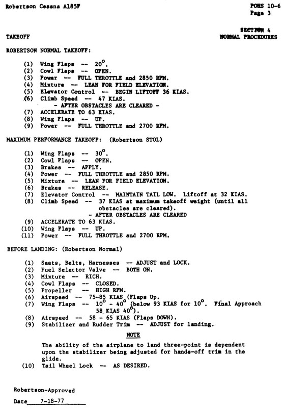

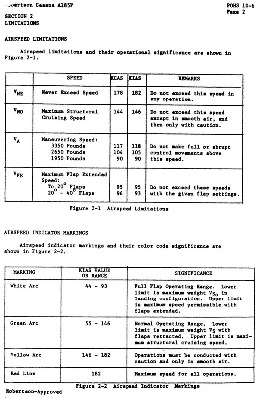

55MPH is only 47kts
Here’s are the speeds for a 185 with a full Robertson (aileron droop + fences) kit
Not sure I’d want to approach at 47kts that’s like 1.07VSO
MAYBE if it was very cold and the plane was very light, but even then that might be the speed I’d get to at 50’, but I’d be much hotter than that on approach

That said, the 185 that I've flown the most was equipped with a Robertson STOL kit on a late model wing (1985). That wing, with pretty much full fuel and two people aboard (checkrides) stalled right about 37 to 40 knots indicated, with full flaps and no power (don't forget that variable as well....). The RSTOL really does permit very low stall speeds, but the roll off at the stall can be (not always) a little "brisk".
We then installed a Sportsman leading edge and aileron gap seals on that plane. Stall speed was 35 to 37 kts, and no roll off at all, it'd just hang there, nose up and sink. Magic.
The modifications to these airplanes that are most common that may influence the stall speed (and of course stall AOA) of the wing are the RSTOL kit, the Sportsman kit, wing extensions, and vortex generators. They all exhibit SOME change in stall speed, but how much?? Good luck sorting the advertising hype from real world flight test data.
Of those, the only mod that actually completed a FULL flight test program to document the changes the kit induced is the Robertson STOL kit. That kit's Flight Manual Supplement provides the changed stall speeds, posted above. While the other mods went through a flight test program, they don't generally provide Flight Manual speed changes.
