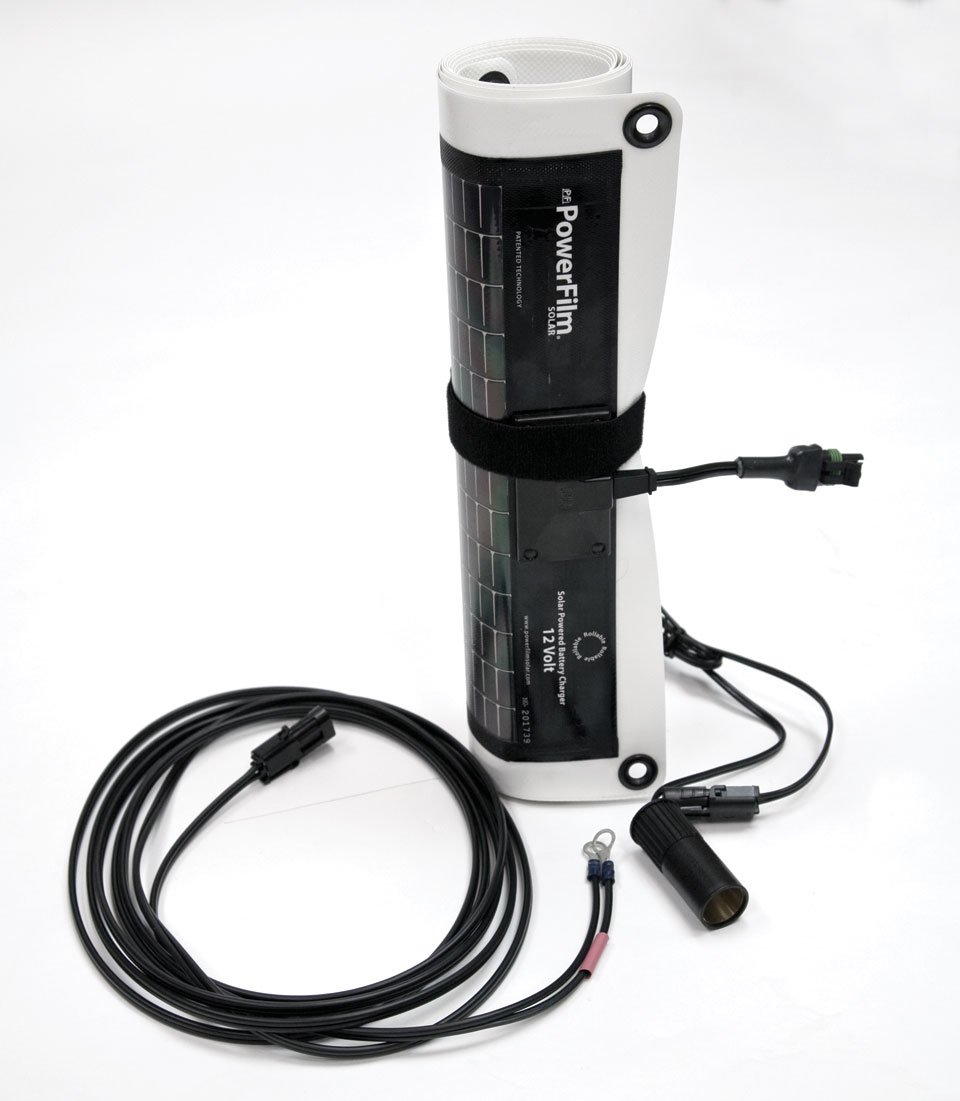

I use this roll up panel, it is light but spendy. The controller takes care of overcharging issues. I use a cheap motorcycle battery on the ground for cell and ipad charging. It hooks to the light weight battery in my PA11 to charge it for radio use.

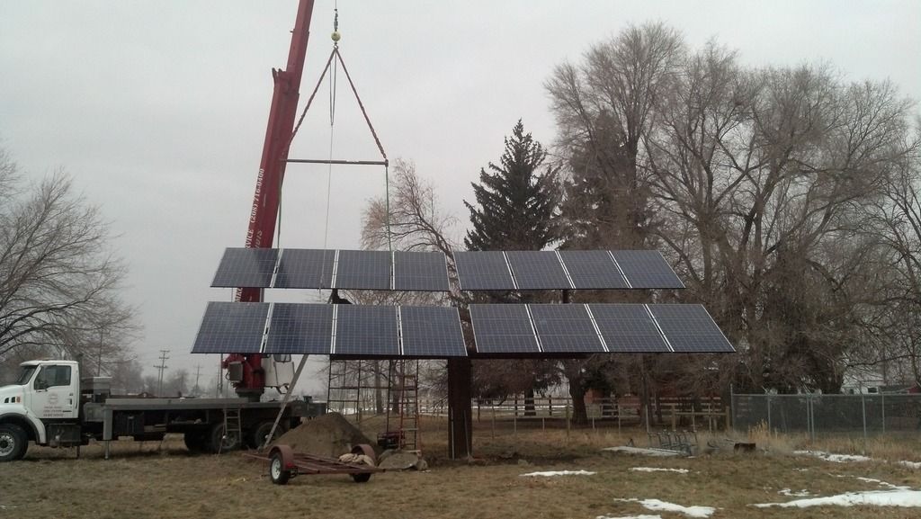

Most of you guys have pretty good sized airplanes, why screw with those high priced inefficient roll ups? It's not like you're backpacking or on a bike. A hard framed 20 or 40 watter will outproduce any of those little rollups, last forever pretty much, and be a fraction of the cost. Way under $100.00. Get A GOOD charge controller (excellent choice Robert, MorningStar makes good stuff, been dealing with them for years and zero problems). True they are more fragile then a rollup, but nothing like some may think and certainly no more then your other camping items like a stove or lantern.
ANY solar gizmo of any type is lots better then nothing, it still seems like magic to me! Here's a setup for a customer that he is using to, among other things, charge his Tesla. A little over 10 KW, magic! About 45 amps @ 240 VAC after it goes through the grid tie inverter.
