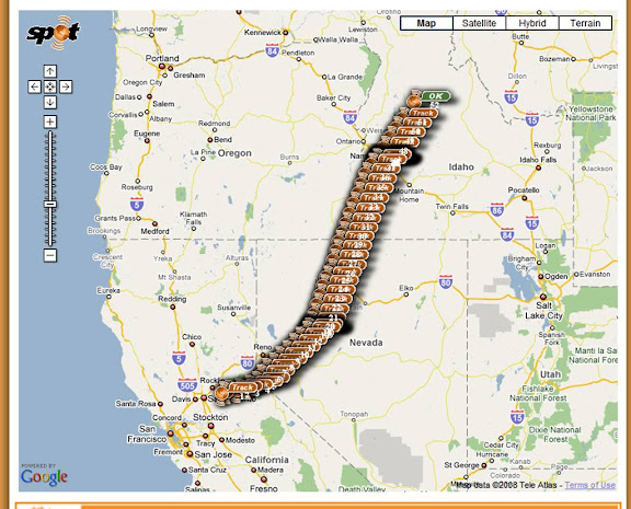

Some example tracks form flights - 1st is from the spot shared page coming back from Johnson Creek
Downloaded to Google Earth coming back from Douglas WY
