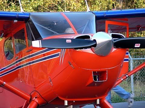

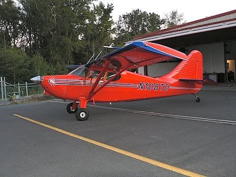

The orange airplane, N108TD, is a Puget Sound area airplane. I've seen it around & checked it out a bit. But I believe it has a Continental IO-360, not a 470 or a Lyc.

hotrod180 wrote:The orange airplane, N108TD, is a Puget Sound area airplane. I've seen it around & checked it out a bit. But I believe it has a Continental IO-360, not a 470 or a Lyc.
I believe you're wrong about the engine..... since I'm the one that rebuilt it. :lol: It does live at Bayview...Toby Dunlap owns it. It also has my aux fuel tank STC installed.
The 220 Franklin Stinsons are a great airplane...but parts are tough to come by, and the gal at Franklin engines says it's not going to get that much better for a while....plus you get to deal with the prop that's installed.
