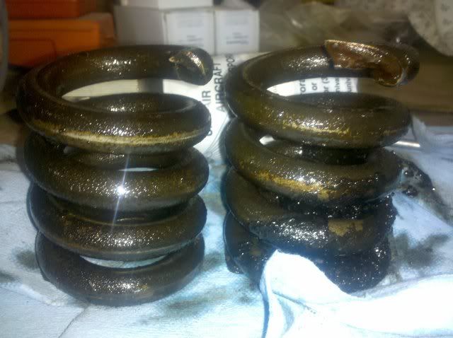

Matt we need that picture you have.

When I had my annual done a in March we looked into the gear because it was sagging to one side. After tearing apart the gear we found that one of the springs was sheared in half. No other parts were damaged and we replaced both springs (Univair sells them for 125.00 each if I remember correctly). I'm almost certain that it was this way when I purchased the plane and it's nice to know that the spring itself is the weak link. The frame and gear attachment is very stout.

Matt, with nothing there to compare size to it looks like a coil spring off a F550 :D
