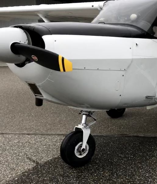

This was the nose fork assembly on the T-41B I used to own.
T-41B Nose Fork.JPG (57.79 KiB) Viewed 1288 times

The R172E (T-41B) came with the “heavy duty” fork and 6.00x6 tire and wheel. There were a few T-41 variants, some might not have had the bigger fork. Sorry, I don’t have the part number. See photo.
There is enough room in that fork that a more square profile 7.00x6 tire will even fit. The “310” fork is the same bent metal design with the addition of little ears for the fender. Maybe someone can offer more about the cast fork for a 6 inch wheel, but the T-41B fork can be installed on your 182 with a logbook entry as “heavy duty fork and wheel assembly installed”.
