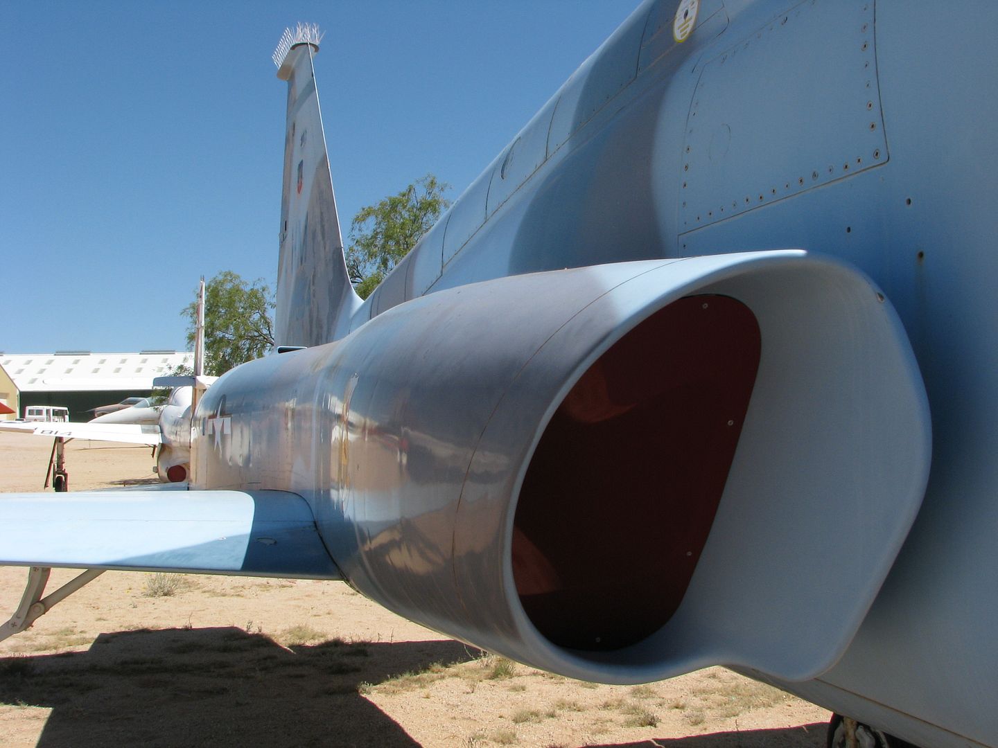

Absolutely right on the area rule stuff. It's the Whitcomb Area Rule that states that the total cross sectional area of the aircraft should vary smoothly. That includes the area of the wings, engine nacelles, wing-fuselage fairings, etc. Richard Whitcomb is the same guy that gave us winglets and the super critical airfoil.
It really applies to the speed range of Mach 0.7 to 1.2, so if this applies to the Bearhawk, I've seriously underestimated their performance envelope. It sure creates some sexy shapes in planes like the Northrop T-38 tho:

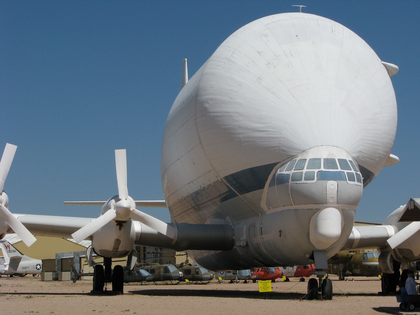

Otherwise, if you are not operating in that speed range, you can get away with shit like this:
