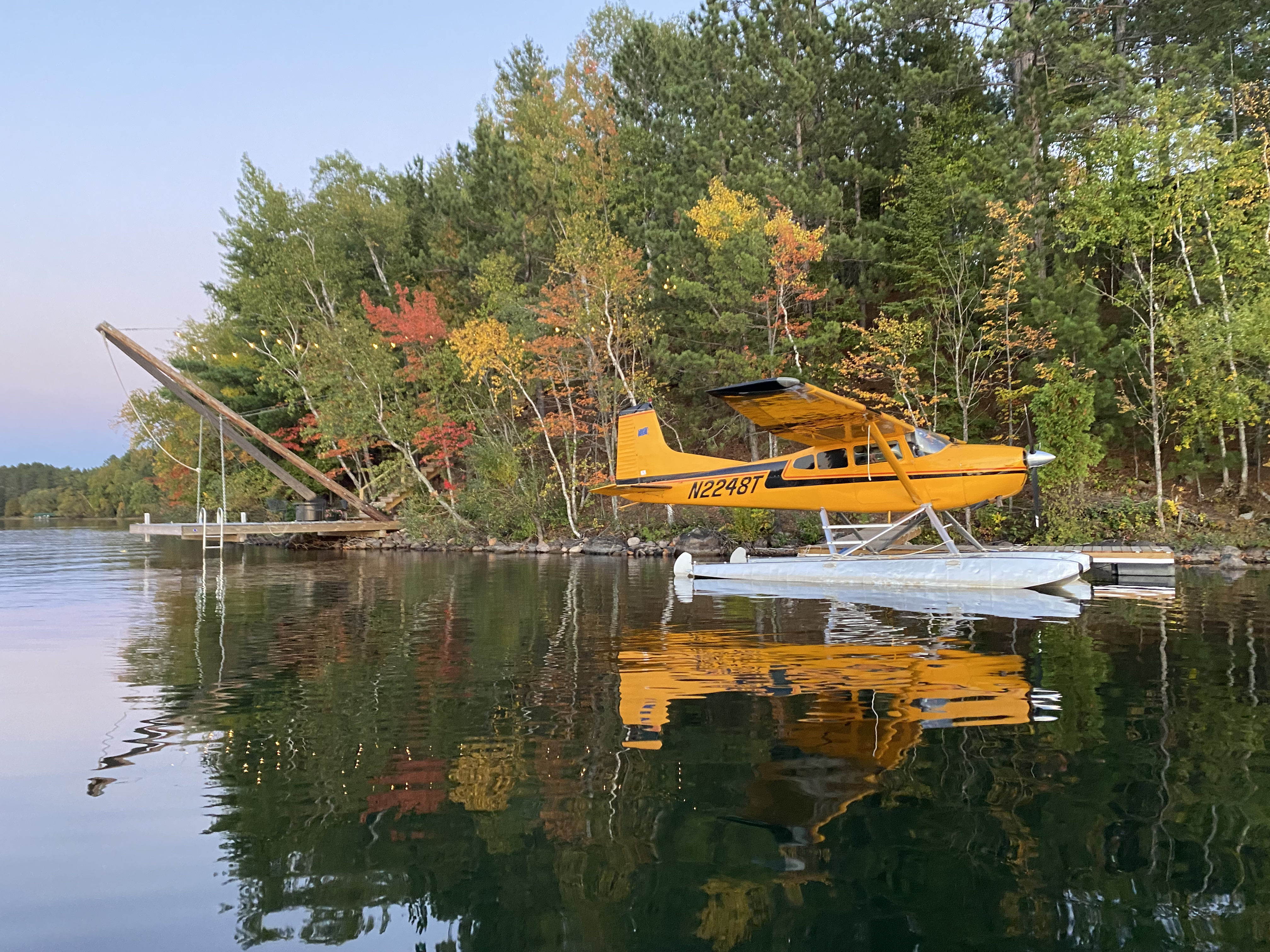

I don’t have a lot to compare it to, but got my first float plane this year, a 185 on 3430’s.
Learned to fly floats in an under floated Aeronca Sedan.
My 185 is 3600 lb gross, and I’ve been flying it that heavy often.
All I can say is no issues at all and nothing sketchy about it. Very solid combination.
It could carry a lot more. At 3600 lbs the aft end (stern?) of the floats is high and dry, and I’m off in 1500 ft with no help from wind. This is with rookie float skills.
It’s a true 4 adult, full fuel, plus baggage airplane.
I paid 6 grand for my dented up 55 year old floats. But they work.

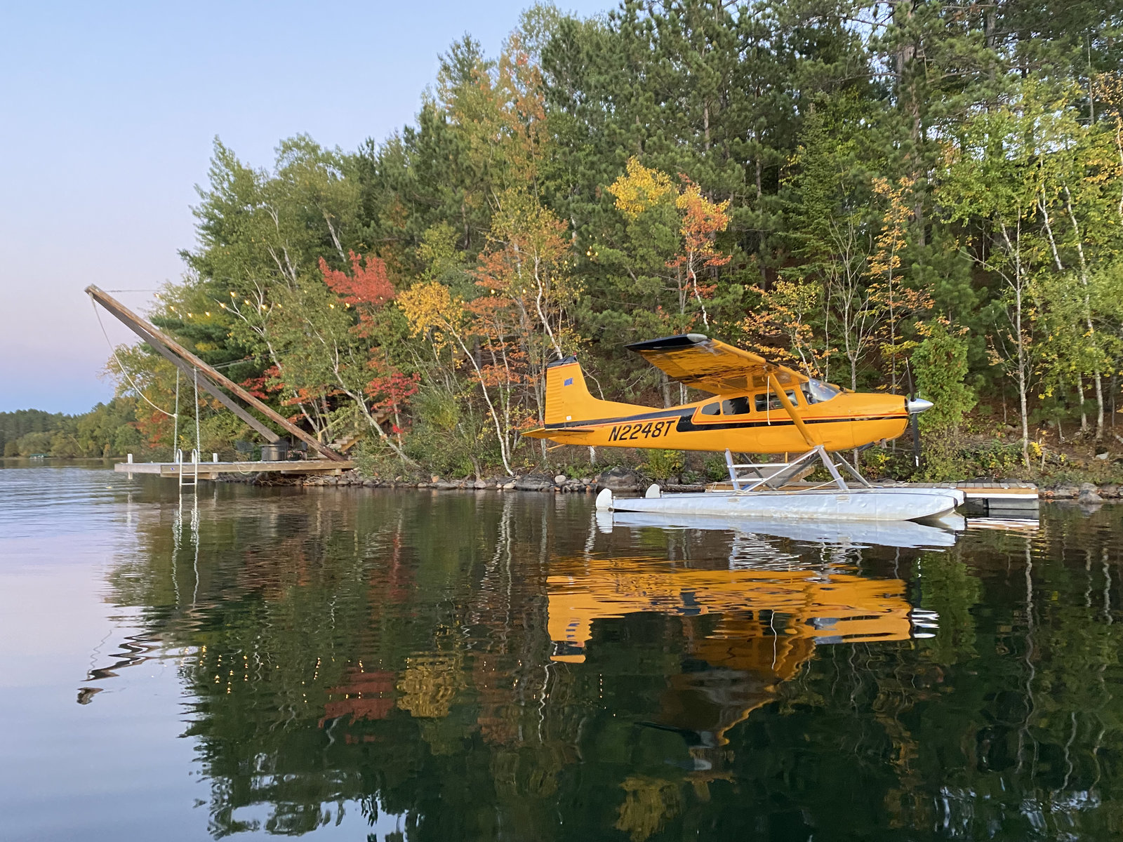

Ross4289 wrote:I don’t have a lot to compare it to, but got my first float plane this year, a 185 on 3430’s.

They don’t look too bad on 3430’s either, as long as you don’t zoom in on the dented floats!
