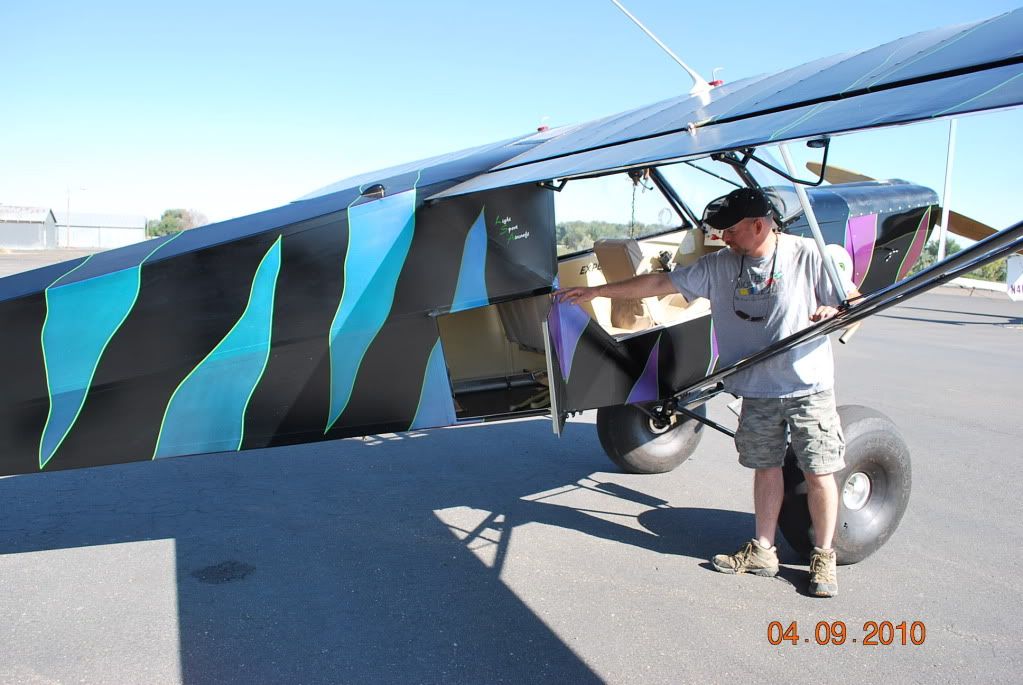

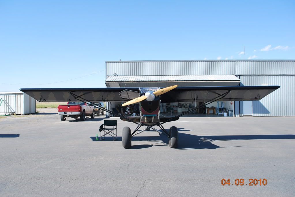

While in Homedale last weekend, I eyeballed the Raven. I ALWAYS keep up on what is new and available, just for my own future reference and for telling others, stealing others ideas etc. Anyway, it is a very stout looking aircraft, with a really good looking wing, and the gear looked just right. No extention needed, it is already there, (it sits nice and tall, the center of the spinner above my head) any Super Cub pilot would be right at home in it, as would one like me, coming up from something a bit smaller like the S-7. A nice compromise and easily under the LSA requirements, which is the big thing of course these days.
Taildragnfun happened by just when we were going flying, so he got in the pictures also, everybody but me! Come to think of it, I have NO pics of my bird airborne.......Anyway, while we did no off airport landings so I can't really say how it performs there, it sure appeared to cruise nice, and the 6 banger Jabiru sounded great, very airplane like with a nice deep tone. All in all a nice mix of new thinking combined with tried and true. I'll keep my bird as I'm too lazy to build (again) just now. I really like the gear, the Rans spring rod gear works amazingly well, but I have always like the A-frame Cub type, whether die springs or bungees, and the big aft baggage door and the clean floor (all controls covered) was also nice, I have to watch where I put things in flight. Thanks for the looksee John!
