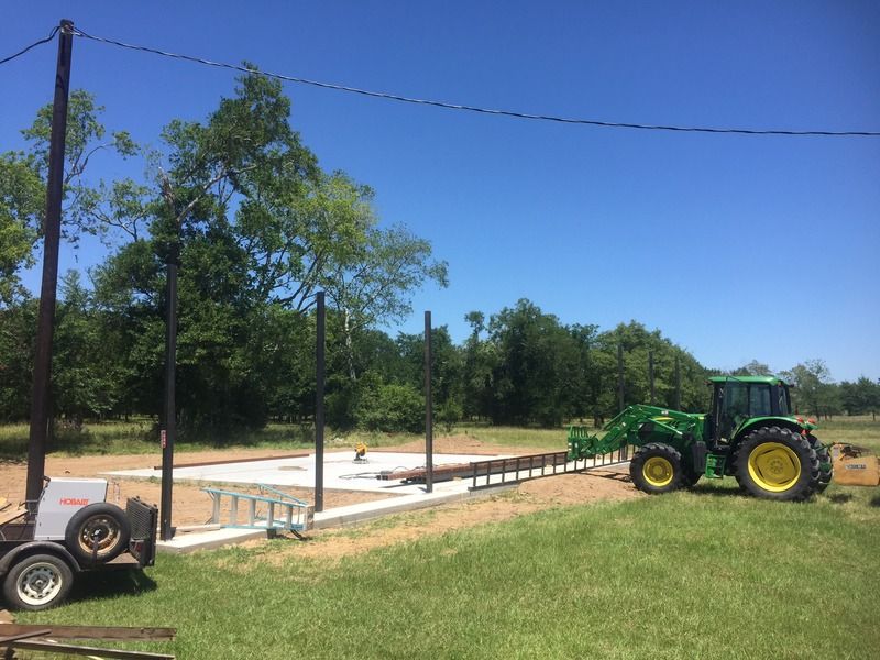

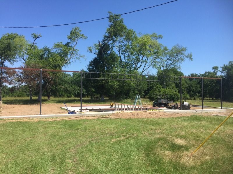

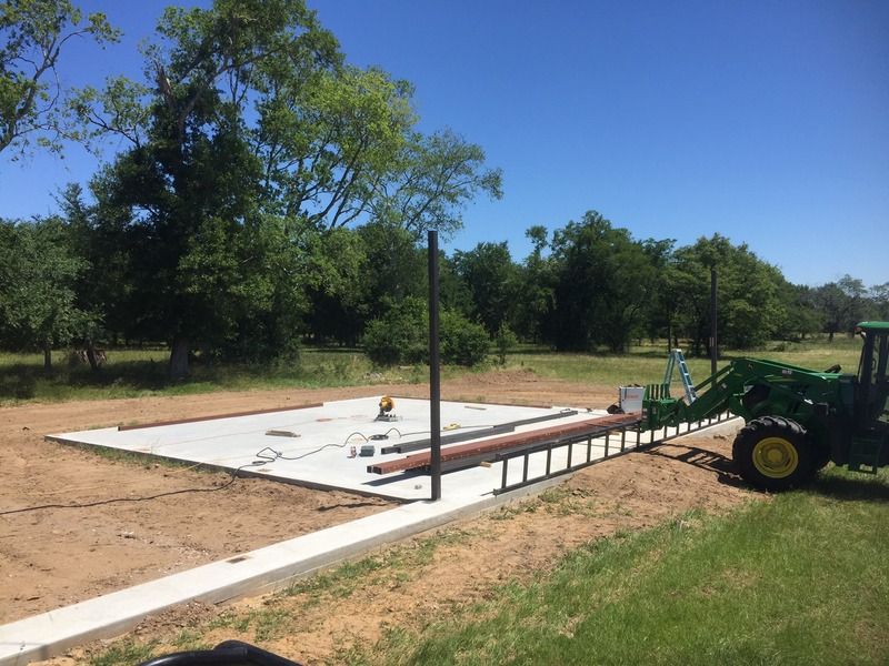

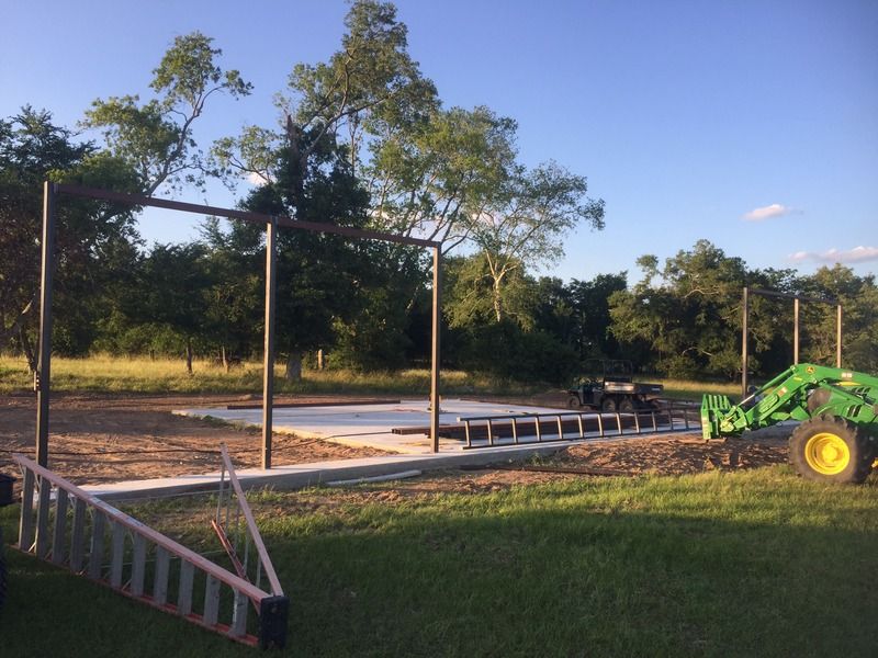

I haven't updated anything on here in a while... I've made some progress but against what all the naysayers said I am in fact kicking myself in the shorts for not making it 40' wide. Any way, here are some pictures of the progress.
