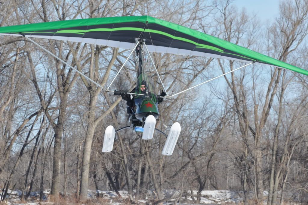

I have a few hours on trikes. Sergey Zolzulya is a buddy of mine and built this Antares for us.
