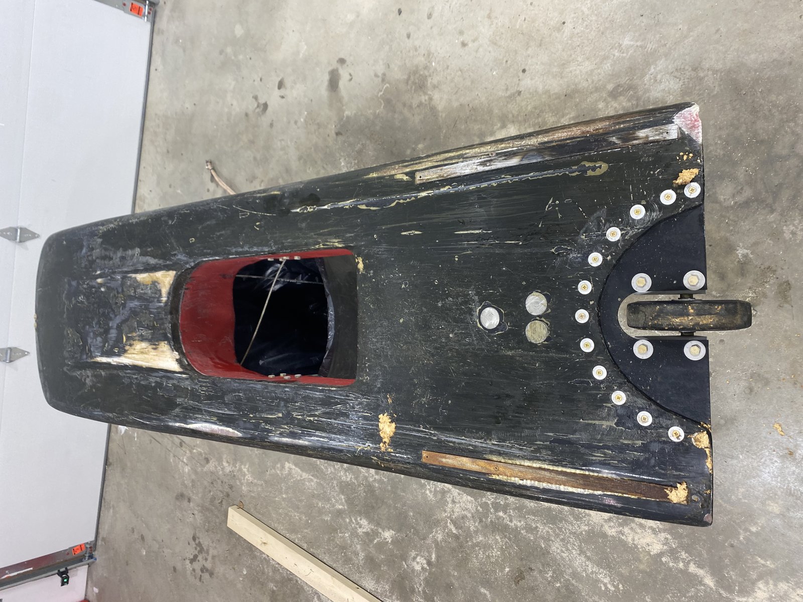

This is what the bottoms of my skis look like. They were made in 1980

Those are gross. Is that masonite? Let's rebase those with some UHMW, add some structure with a wire brush, and hot wax them!

I’m going to start by sanding them down to raw fiberglass, then prime and paint them.
Then maybe figure out a way to put uhmw on the bottoms.

Seems there is some kind of black coating over the fiberglass on the bottoms. Doesn’t smell or sand like anything I’m familiar with on composite aircraft structures.

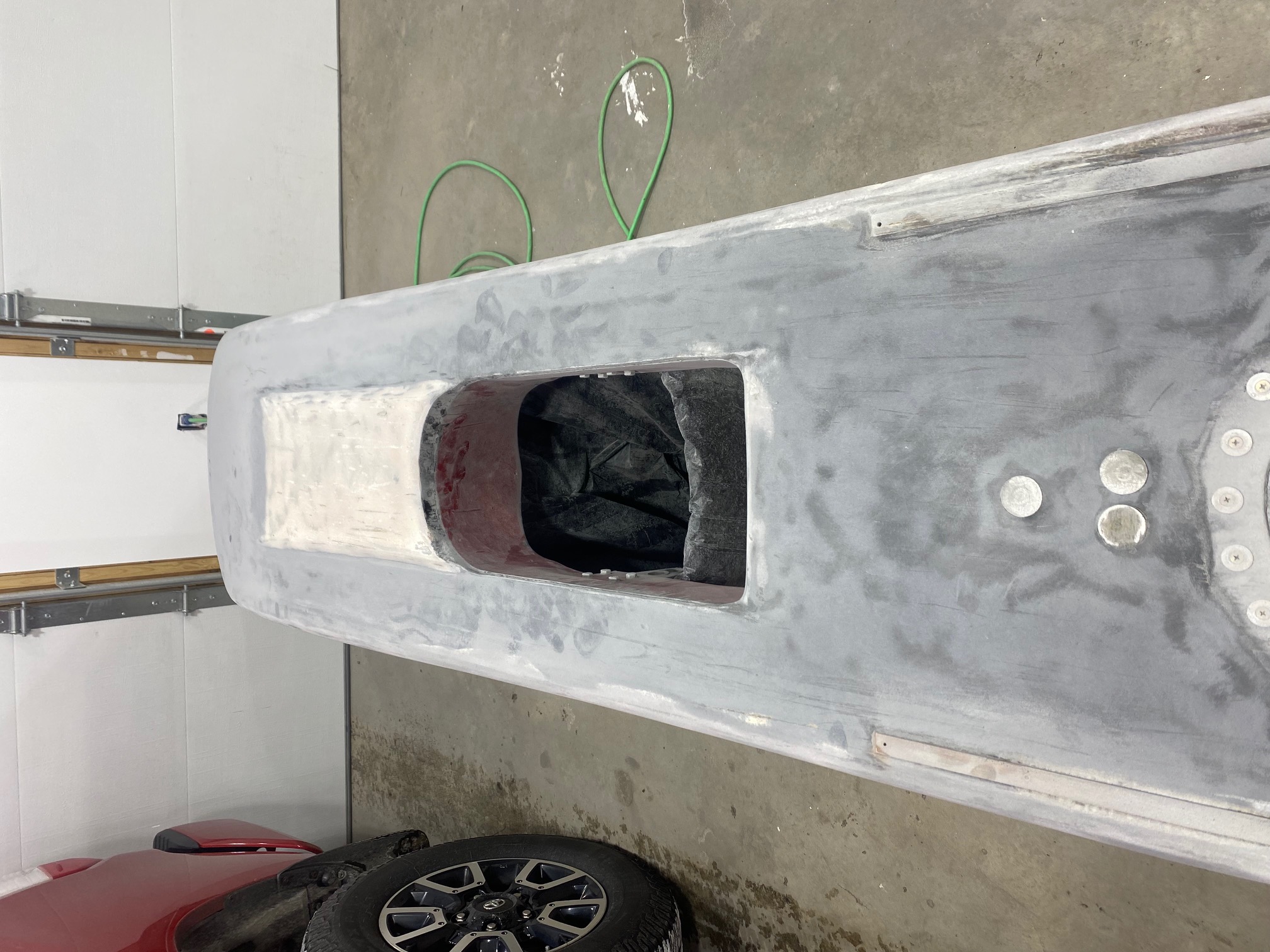

I talked to Airglass, and they said the black material on the bottoms of these old skis is West Marine 105 epoxy, with black colorant added. I sanded one down so far. Will fix a few gouges in the fiberglass, and then re-do the resin. Top sides will get paint.
