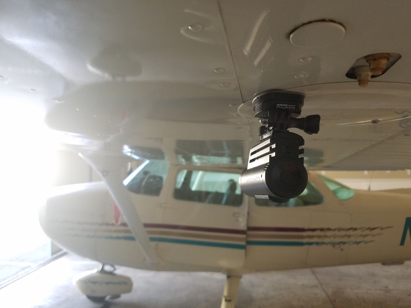

I've been enjoying my new-to-me 172 for the last couple of months; trying to expand my "local" area by flying to a different series of airports every weekend. A few weeks ago I installed a camera on the wing strut with a custom made aluminum clamp, but really wasn't happy with the perspective that it offered. It was too close to the cockpit and I really couldn't see much outside of the airplane. So, I found an aluminum gopro style base mount, and drilled/countersink a center hole in it. I used 3M adhesive tape, and utilized one of the inspection cover screws as an added measure of safety. I also bought an aluminum camera mount, and I bought a Contour Roam 3 camera (doesn't match my hero4's resolution or framerate, but for youtube videos the GoPro's capabilities are largely unused. And, the contour's battery allows for a little over 3 hours of continuous recording; much better than any of my GoPro cameras).
