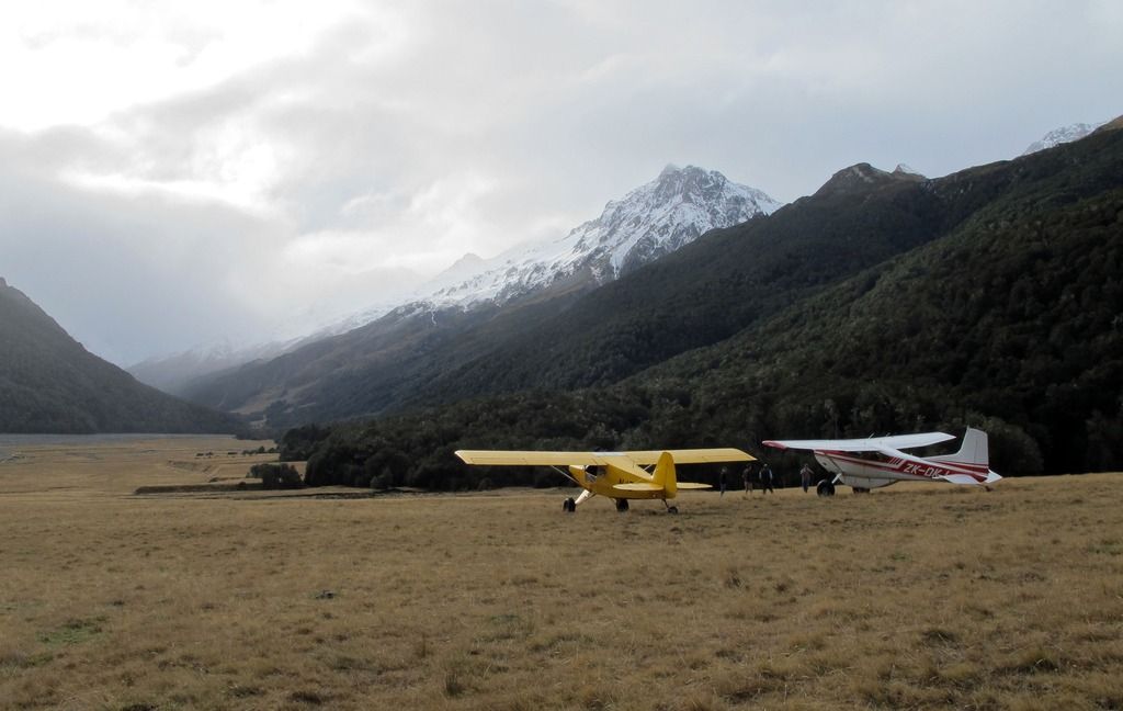

To be specific, I am thinking this kind of off airport stuff:
Not this kind of off-airport stuff:
An aside, I reckon a leaf or rod spring is good as gold for the latter example of landing surface, based on my experiences there is absolutely no need for anything more. But you can really feel the tail and fuselage takes a hammering on the rock surfaces in the two former pictures.
